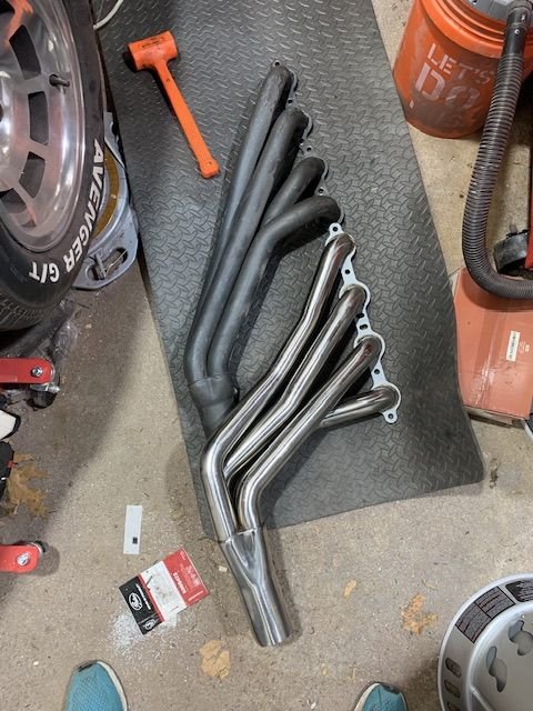

I run the 3rd gen firebird/camaro ls swap headers on my 78 which was converted to a 80-82 style. I also picked up a set of C10 LS swap headers which fit but didn’t fit great on the floor boards but they could be modified to fit. Each was less than $300 new from speed engineering and the other was racing innovations.
When you say they didn’t fit well on the floorboards, how so?
Old Sep 15, 2024 | 12:18 PM
78vette5.3's Avatar
78vette5.3
Joined: Sep 2020
Posts: 863
Likes: 186
From: CT

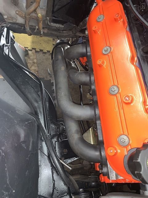

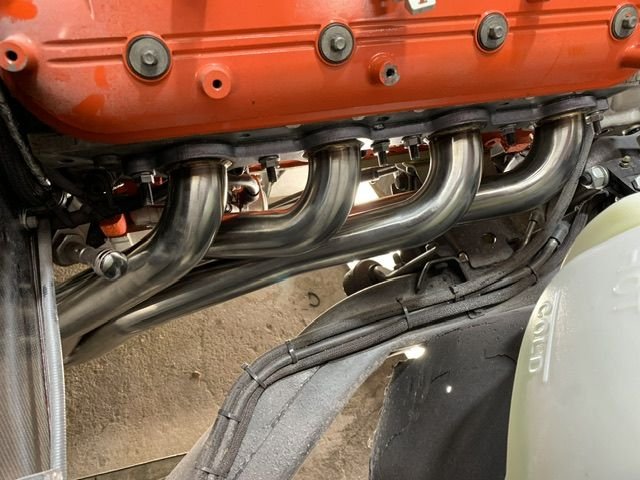

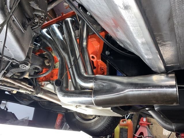

see below, these are the speed engineering c10 swap headers. Lots of clearance around everything but the floor boards. I would like liked them about 1” lower on each side and the angle isn’t great on the pass side.

3rd gen 82-92 firebird/camaro swap headers from racing innovations.
