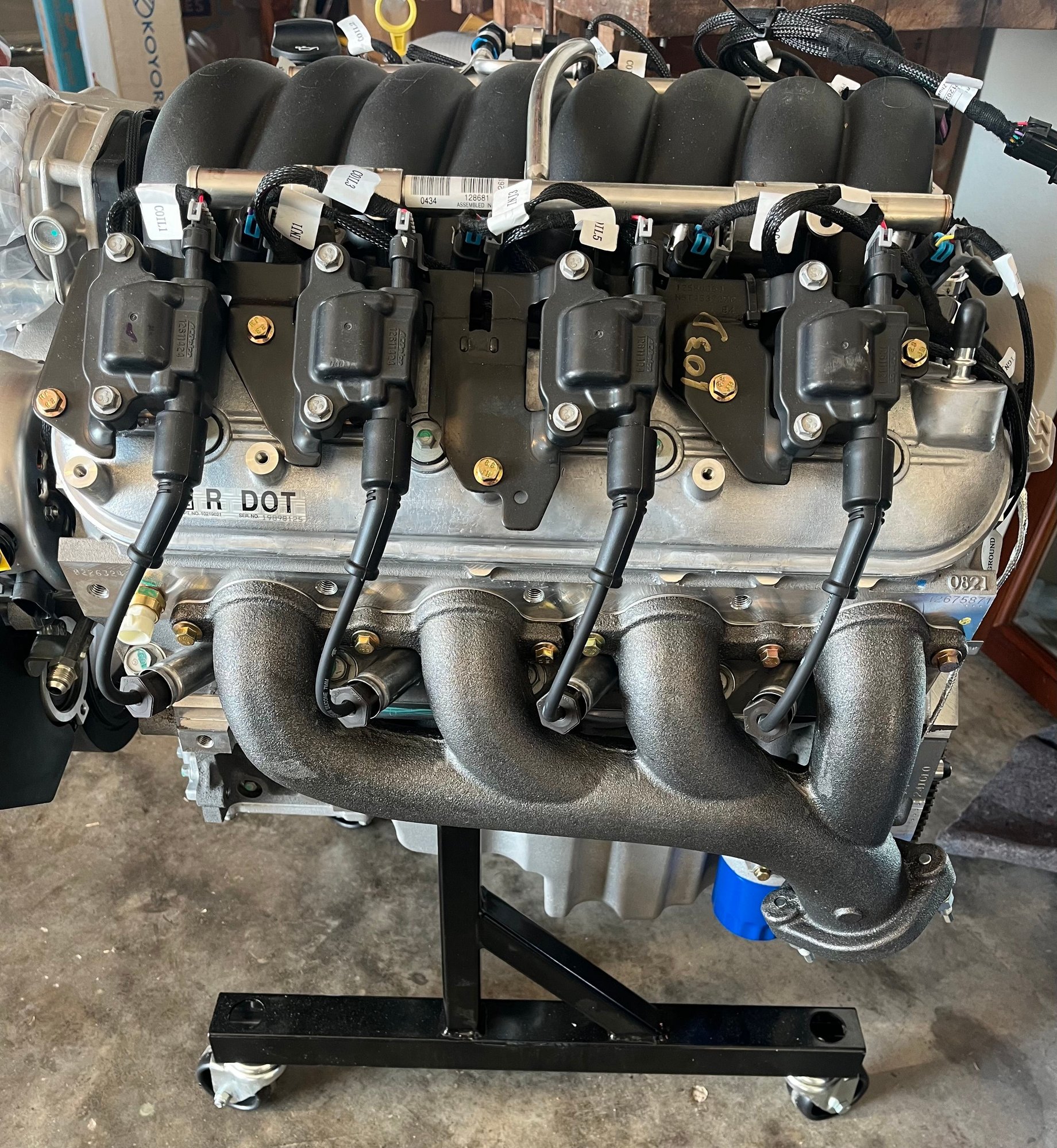

I picked up a set of LS7 manifolds for my LS6 swap. Not headers, but should still flow well enough, and tgey were cheap! @cagotzmann has them installed in his LS3 swap thread.
