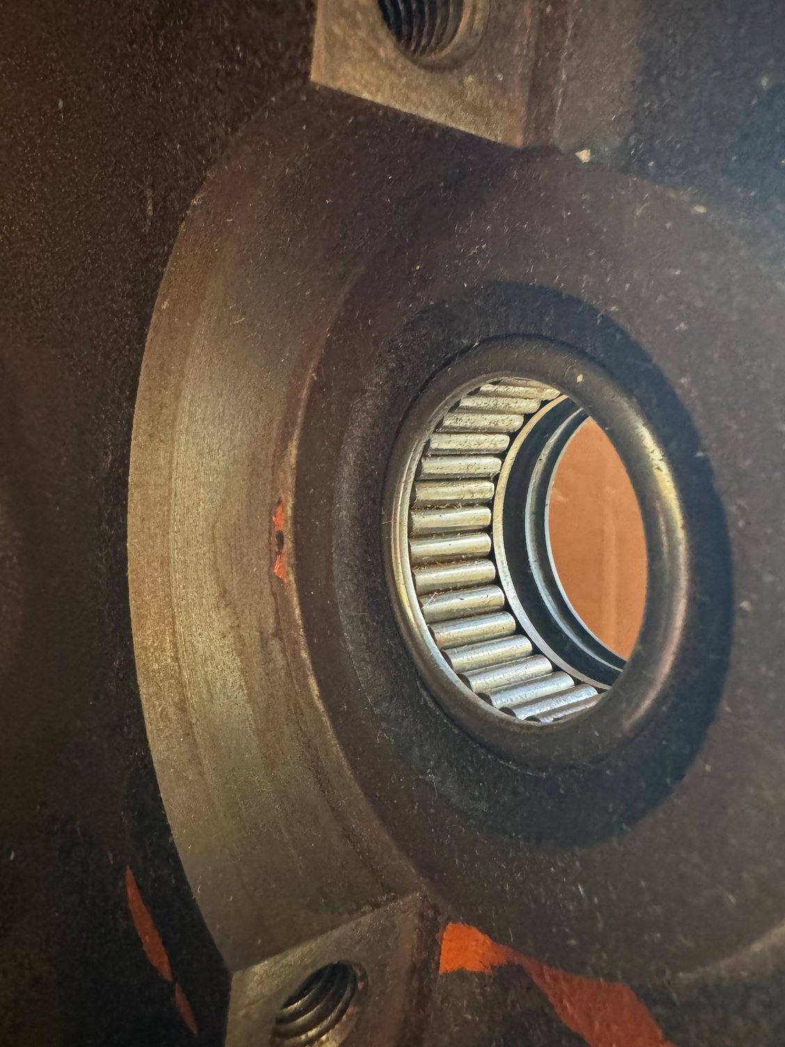

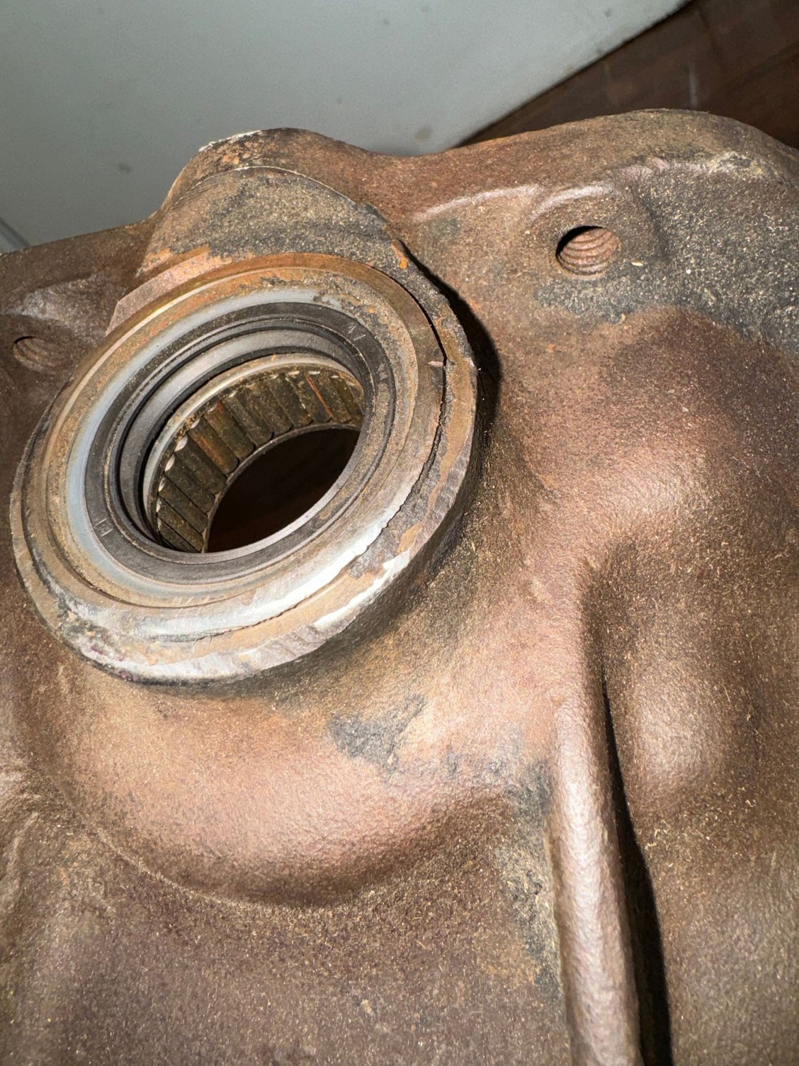

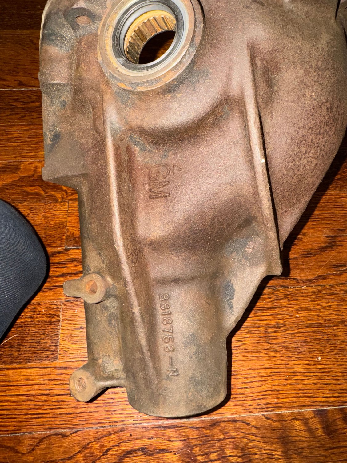

Old Oct 19, 2024 | 02:31 PM
Nick.Faga's Avatar
Nick.Faga
Joined: Apr 2024
Posts: 18
From: Westchester, New York
Originally Posted by MelWff
Can you post pictures of what you have?

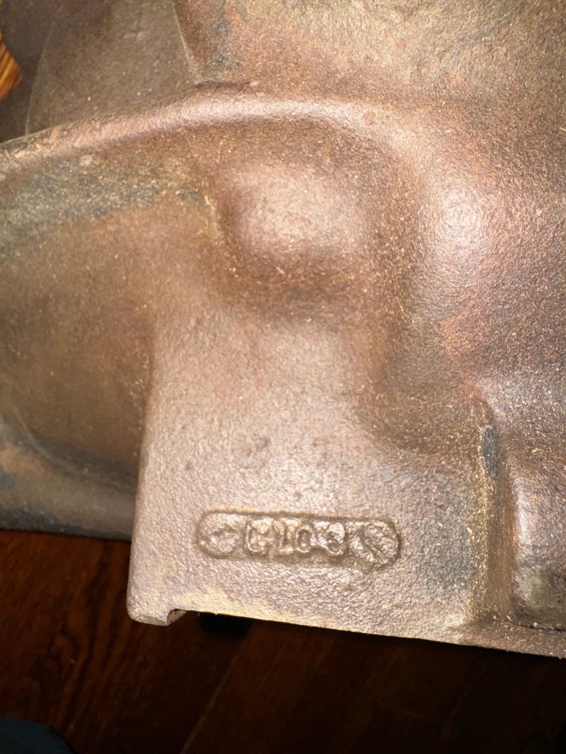

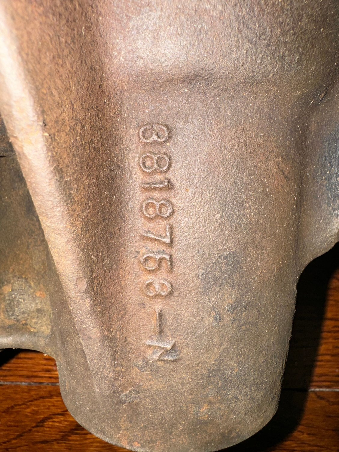

this is all that I have for the new differential so far. If I should get a different housing let me know please.

Old Oct 19, 2024 | 06:01 PM
You should have reached out last week because I held a tech seminar today in CT that would have been worth your time to come to. You would have gotten more information than most vendors know, and certainly more than common techs will know.
I read where you are intent on building your own diff with your friends help and that's fine. Only one way to learn is to do.
This will be my only comment, and I may check back from time to time.
Your pictures tell a story if you know how to read it. You don't show the bearing caps, if they are with it or not. The story on that Carrier is not complete unless you show the caps and internal of the Carrier. That is a 63 Carrier as GM called them. Looks like July 10, 1963. The case holds the ring gear and clutches- posi case.

  #37
69L88's Avatar
69L88
Posts: 3,411
Likes: 1,821
From: Apple Valley, MN
As Gary pointed out, that is a 1963 case. Stay away from that one. Find a 3899143.

Old Oct 20, 2024 | 11:54 AM
  #39
Nick.Faga's Avatar
Nick.Faga
Joined: Apr 2024
Posts: 18

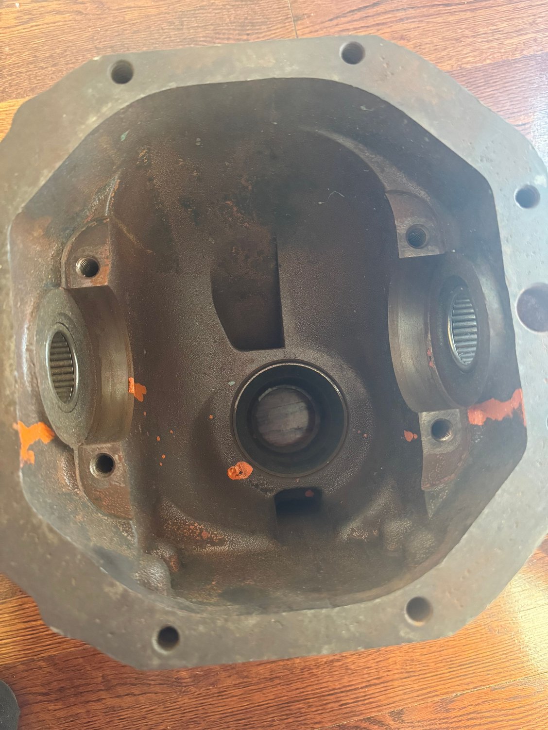

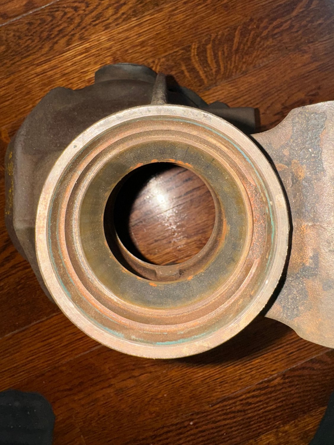

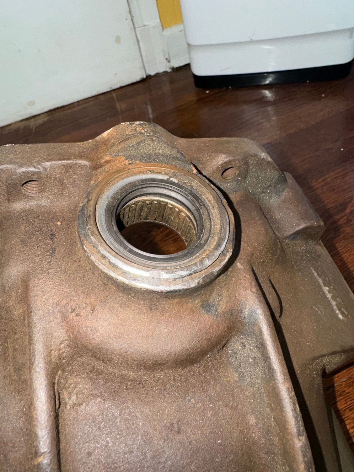

here’s some more photos I was curious about that damage in the 3rd and 4th photos aswell would that have an effect if the case were to be used
Old Oct 20, 2024 | 12:04 PM
  #40
MelWff's Avatar
MelWff
Posts: 18,735
Likes: 2,582
Do you have the original bearing caps? If not you need a different case, that one is worthless. In addition you should be looking for the other number case.
