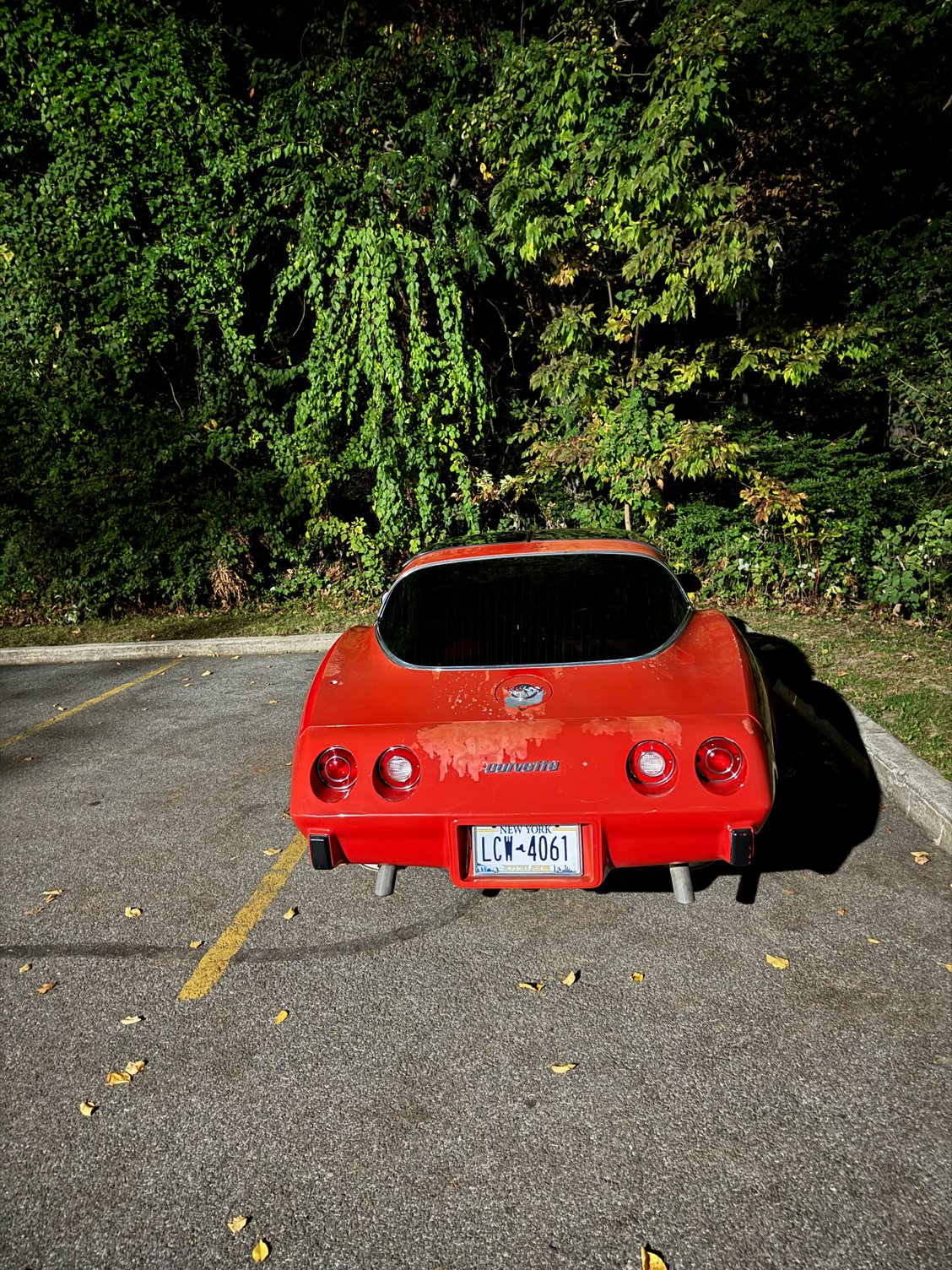

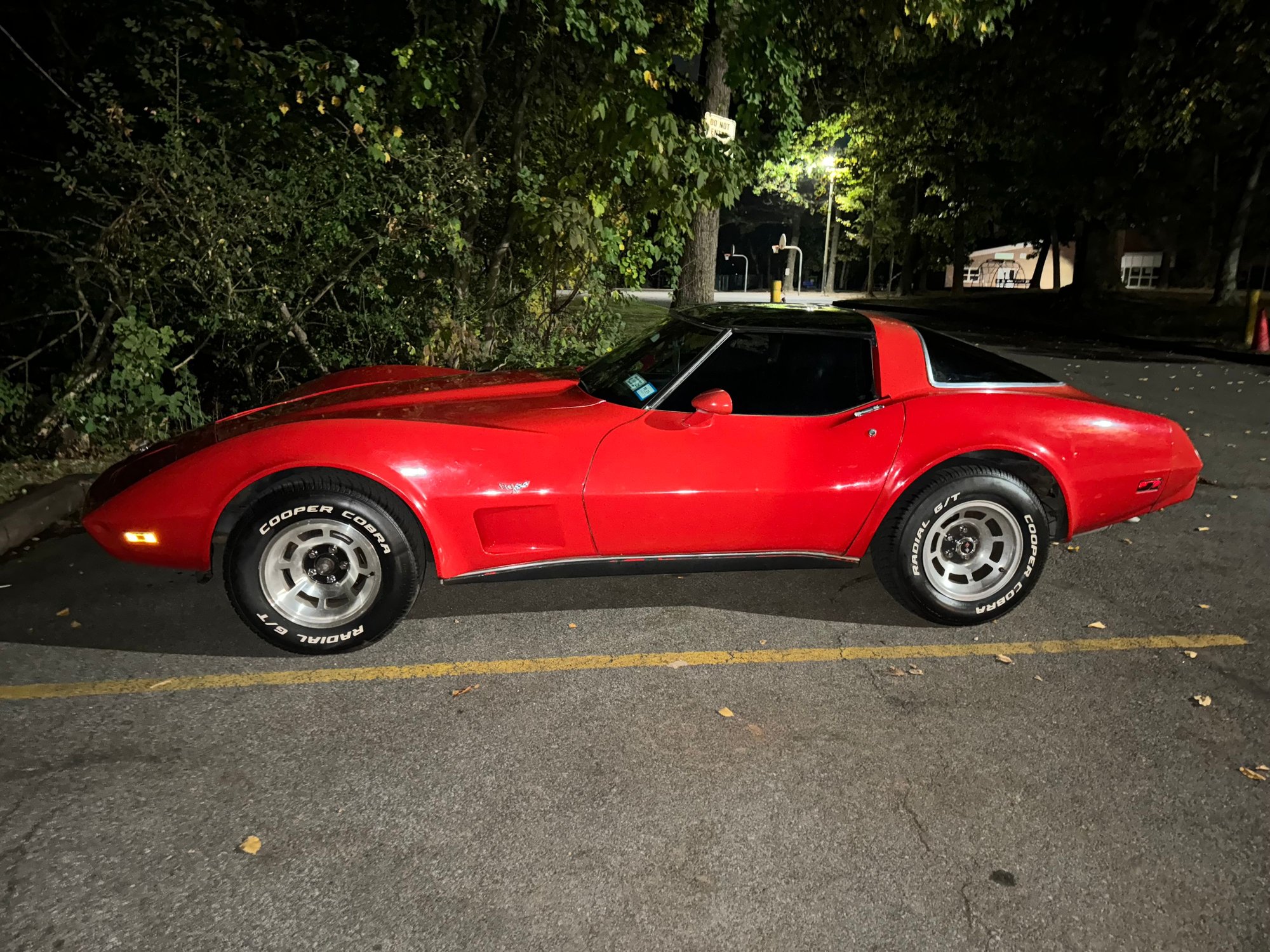

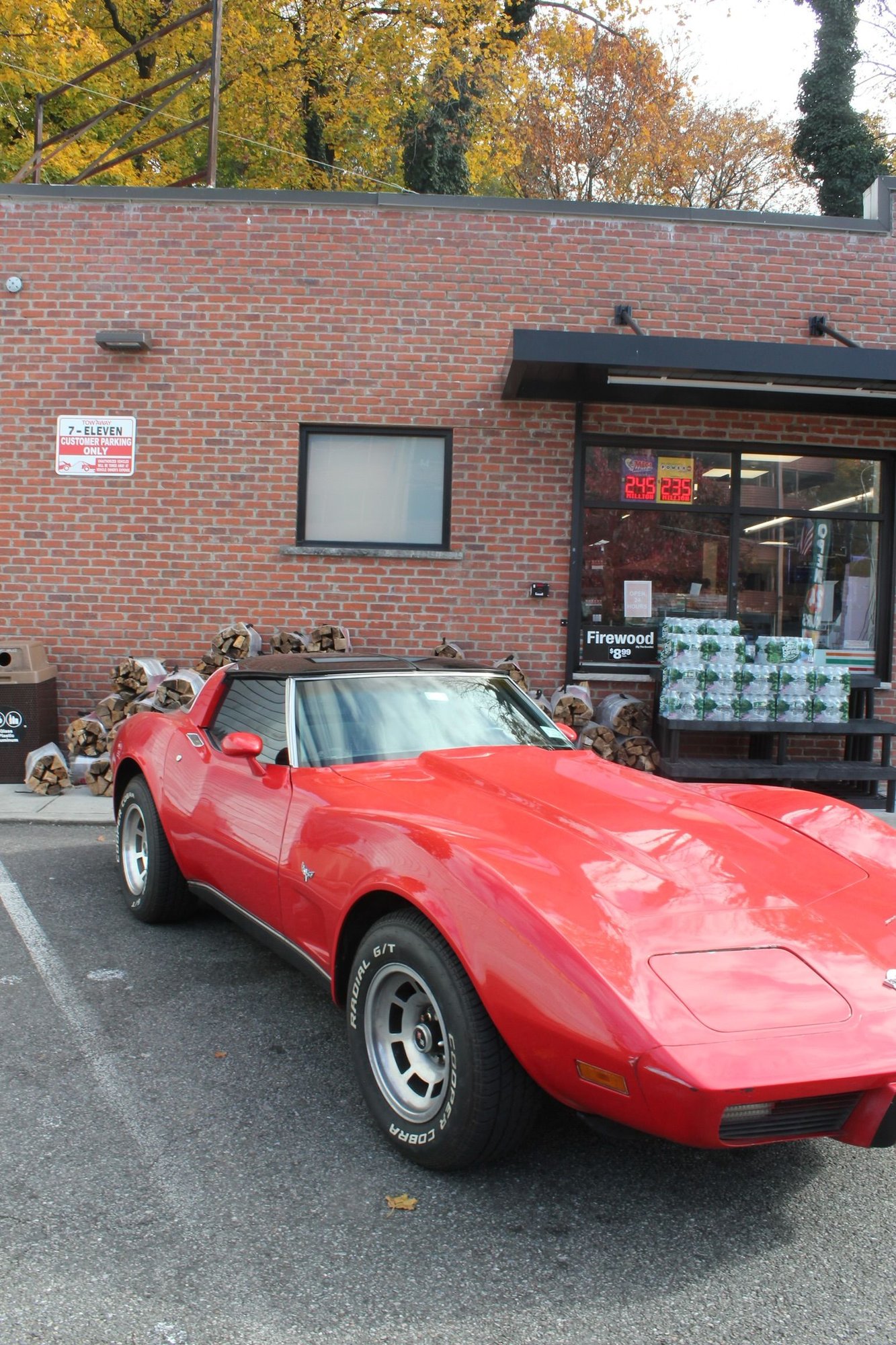

Ill add a couple photos of my baby

Nice looking 78, welcome aboard!!!!

Welcome, nice ride, love the color, all Corvettes are RED!
