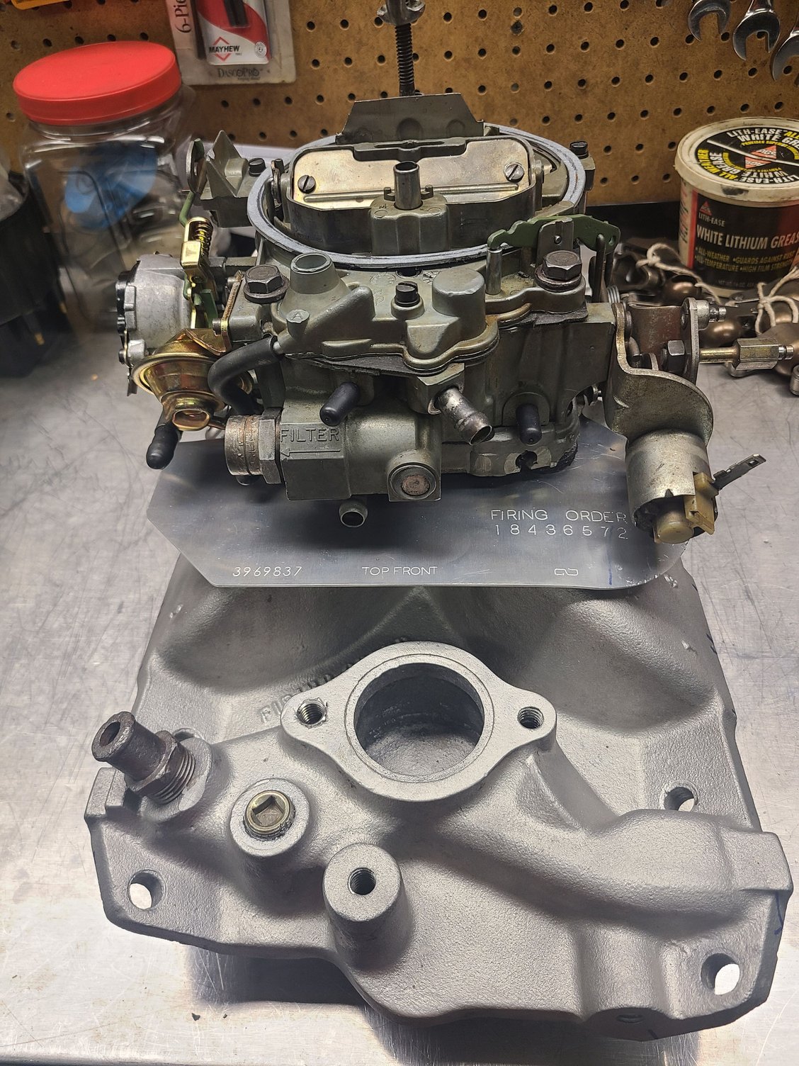

This is a reproduction GM heat shield for a Quadrajet. They stamp the GM part number 3969837. The NOS originals are rather pricey but I found this one online at The Parts Place. It had to be trimmed/bent in a few places to suit my application but it should work well to prevent fuel percolation.
Had to trim out for the vacuum fitting port. Some slight bends here and there but it was easy.
https://www.ebay.com/itm/35115897293...kAAOSwImRYJeeM
They also offer the Holley square bore heat shield.

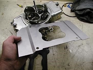

Keep in mind the OP does not have a Q-Jet - he has a Holley. A properly fitted Holley reflective shield looks like this:
(Demon carb shown - Holley is the same configuration)
This shield reflects heat away from the bottom of the float bowls, and keeps the heat reflected away from the accelerator pump well, which is the critical component when the fuel starts percolating in the Holley carb.
Lars
