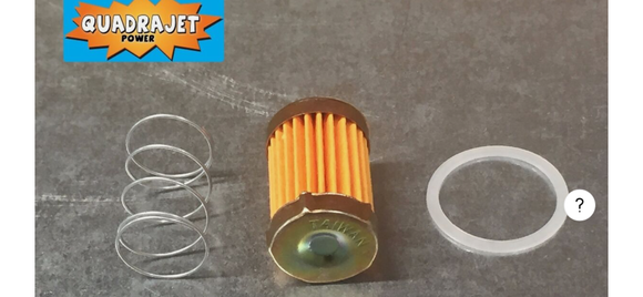

Thanks for the tips. I will make sure I check the timing and fuel filter.
Mine is a 78 so it has the HEI from the factory. I put a new HEI in about 25 years ago.

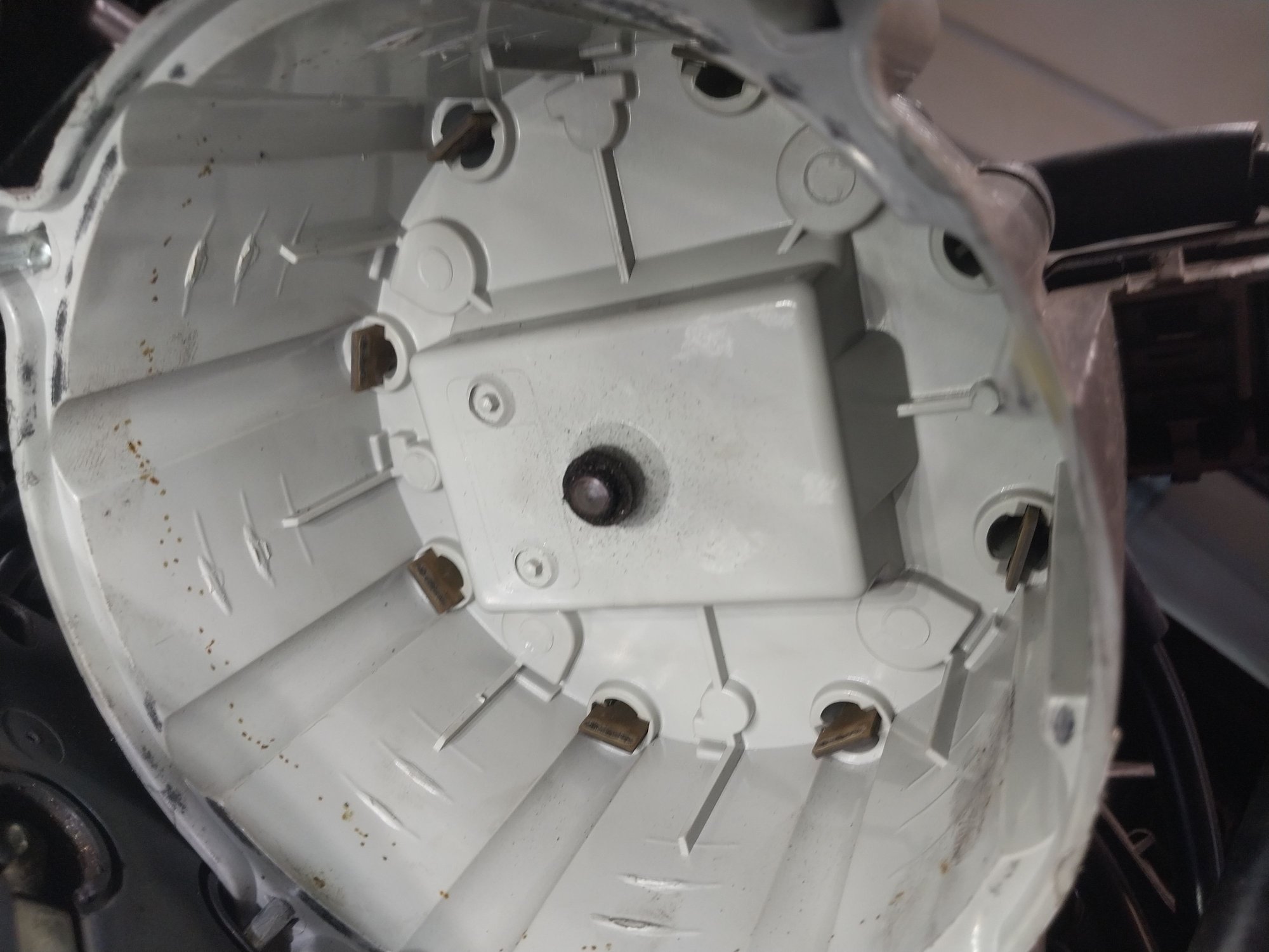

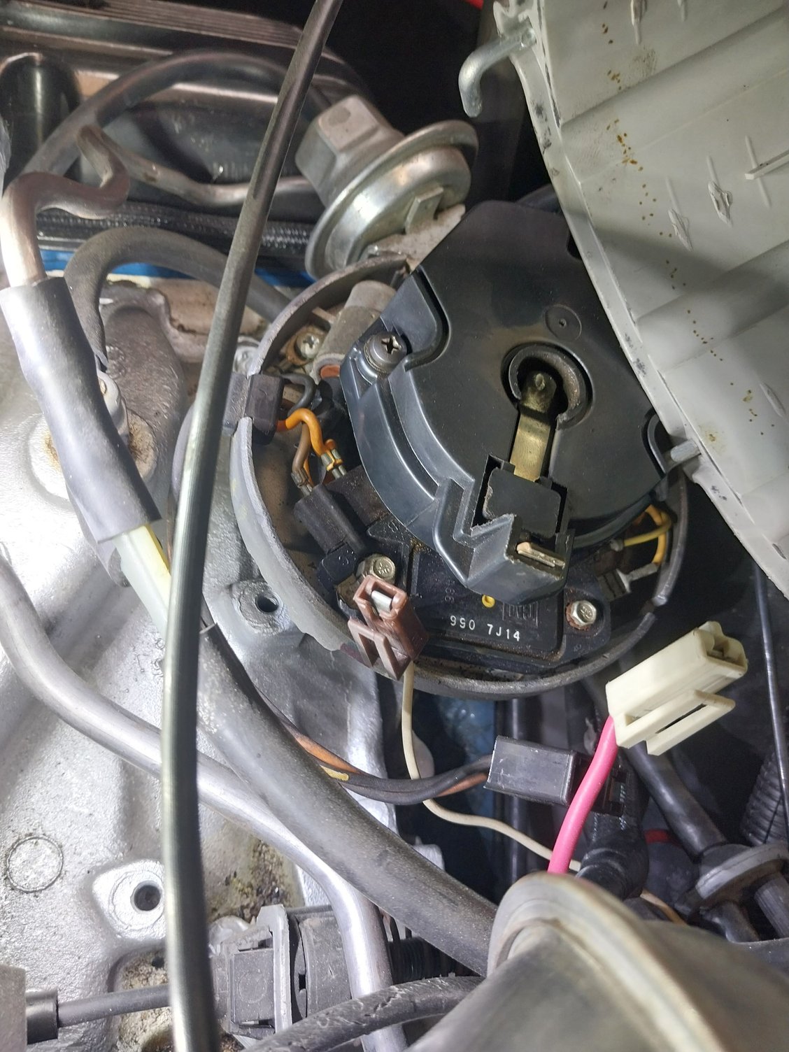

Here is pics of the rotor & inside of the cap.
There is a little pitting at the end of the rotor. Not sure if that is a problem?
First the plugs: try running the engine for about 3-4 minutes to put some heat into the aluminum to expand it, then see if you can get the plugs out. The aluminum will expand more (and more quickly) than the steel of the plugs.
Your cap and rotor could use a clean up. Use a fine file (an old-school distributor file for points would be good) and file the pitting/surface buildup on the rotor tip and each cap tip. A fingernail file would also work, but don't use an emery board - a diamond file would be fine. Pry the rotor button upwards and clean that too with a little steel wool or the file to get a shiny surface.

Len,
That rotor looks terrible. It has been burning / arcing.
I would question which Spring Bushing is the dizzy cap. There are two types of bushing springs and most new caps from MSD should come with both choices.
There is a Low Resistance Bushing and a High Resistance Bushing.
Some new dizzy caps come w/ High Res only. And that maybe your "rotor" issue.
Its an easy swap by removing coil dust cover, coil and rubber washer under the coil. Then access to the bushing is easy.
