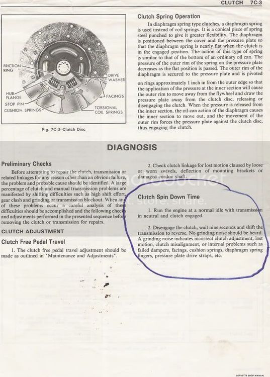

For reference..

Thanks for confirming my 9-second spec! I knew I remembered that from my tech memory... who says I'm going senile yet..? And people think I just pull this chit out of my ****...
