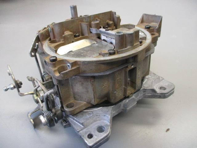

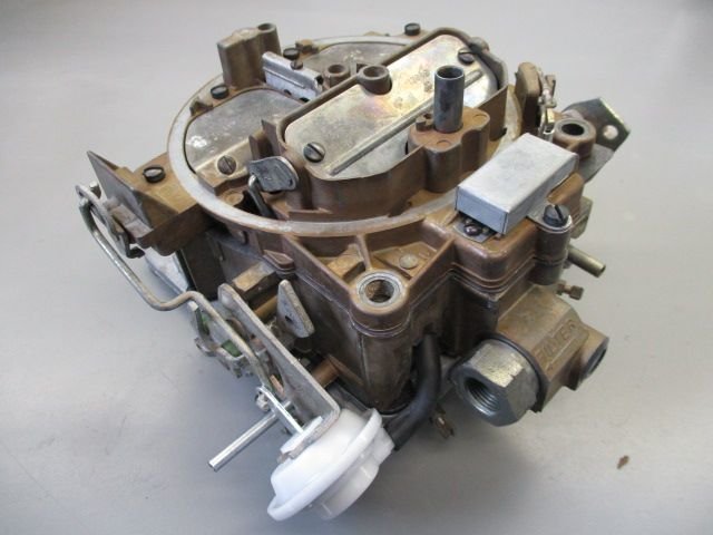

Be aware that the carb you are trying to work with is a hacked, molested, modified, commercially rebuilt carb. It is bound to have a massive amount of issues and problems that cannot be corrected with a "carb kit," and it's not even a Chevy carb. For example, the airhorn (the entire "top of the carb") is off of a 1970 Pontiac. I can't tell what the throttle plate is off of, but it's not a Chevy throttle plate. The float bowl is a Cadillac float bowl. The entire choke pulloff bracket is some home made part that does not belong on a '69 Chevy carb. For a list of just a few of the problems that carb will have, send me an e-mail request for by "Commercially Rebuilt Q-Jet Problems."
Here is what a '69 Vette carb looks like - compare it to what you have. I will sincerely advise you to take that carb and use it to practice your hook shots into the garage trash can. Then, start a quest for a good, used, unmolested '69 carb in rebuildable condition.

Pictures of an actual '69 Chevy carb:

If you want some info and tips on what to look for when shopping for a good builder core, just send me an e-mail for my used Q-Jet guide. The core you have is completely unusable and is not rebuildable. Also, if you bought a "kit," either off the internet or from one of the popular retail outlets, the kit is junk and does not have a usable accelerator pump in it.
Lars
