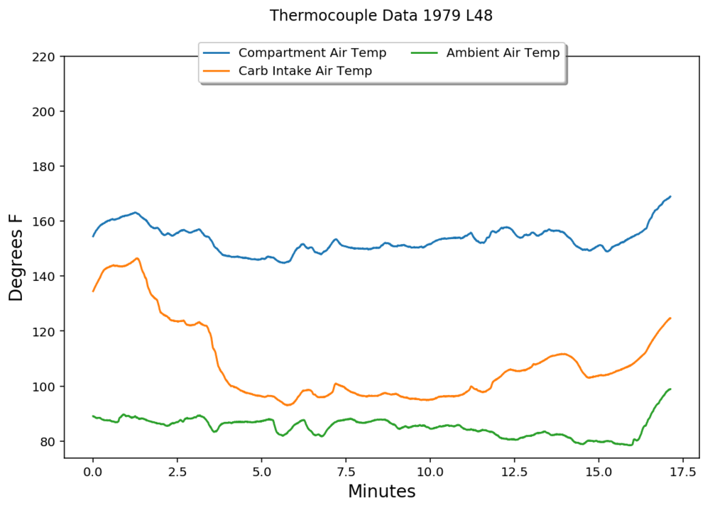

i cannot find your thread but did find both of our readings. Great contibutors that helped me in this thread. @REELAV8R did some vacuum readings i think?
bottom chart L82 79
https://www.corvetteforum.com/forums/

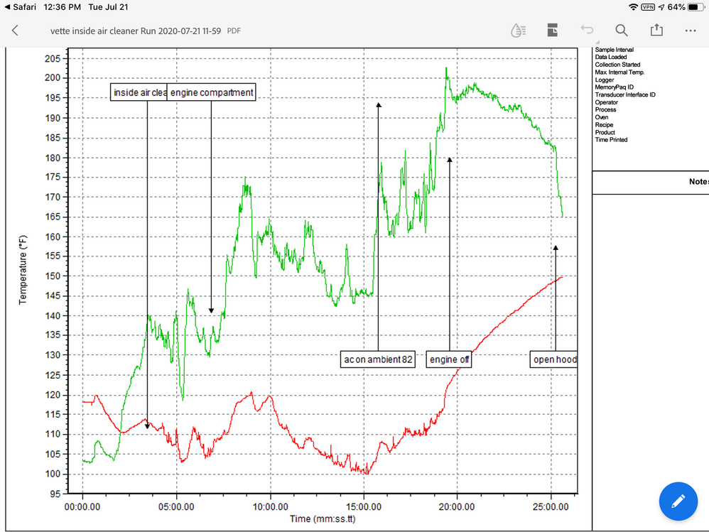

If I am reading the bottom chart correctly, that dual snorkel cold air intake on the L-82 looks pretty darn impressive!^^^^
I showed about a 60 degree difference in the top graph, while the car was driving (less at slower speeds, or parked).
X2 on that drop/effect when it is colder outside like 40/50's degrees..............

I did do some temp readings years ago. Here is the thread:
https://www.corvetteforum.com/forums...g-results.html
To do vacuum readings inside the air box I used a piece of clear vinyl hose taped to the side window as a water monometer. Acceptable vacuum inside the air box at full throttle and max RPM, indicating little to no restriction to the incoming air, is 1.5" of water column.
You cannot use a vacuum gauge as it is in inches of mercury. Mercury is 13.6 times denser than water. This means that the water monometer will be 13.6 times more sensitive to vacuum vs using a vacuum gauge.
Some paper filter are VERY restrictive to incoming air. To see the difference I did a run with the paper filter in place got the water monometer reading. Then did a run without the paper filter. The difference in readings was so significant that all the water in the monometer was sucked into the engine vs with the paper filter in place I only had 1" of water vacuum indicated.
Due to the height restriction of the side window it could indicate as much as 12" of water vacuum.
That means that the paper air filter was creating a restriction to the engine that exceeded 11" of water vacuum.
