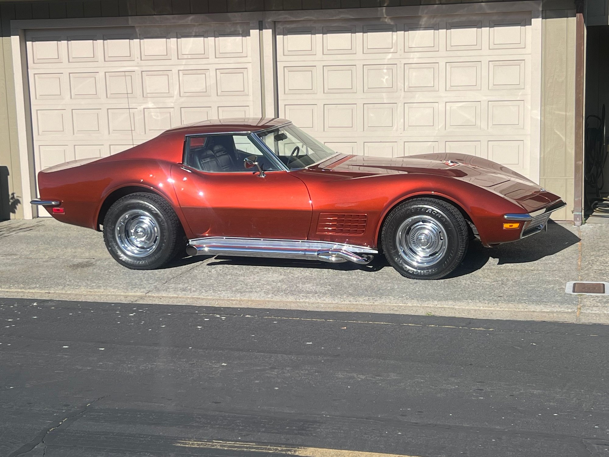

Last year my neighbor sold me his 1972 Corvette Stingray that he purchased at the Mecum auction in 2019. I love the car but the side view mirrors won’t hold their position when I hit the freeway. There’s seemingly no way to adjust the tightness so it there any product out there besides super glue that will help it hold its position and still be adjustable?
-Looking in the rear view mirror
The 72 with mirror issues
