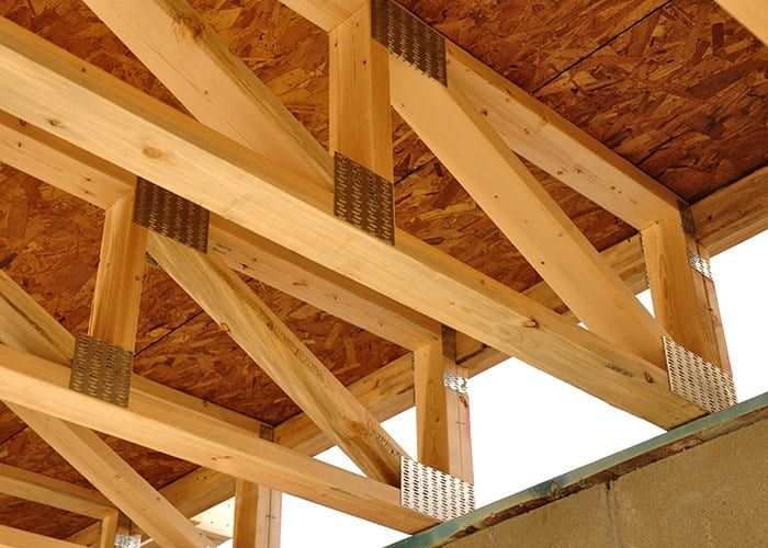

Since everything is unbolted or unhooked ( I think) iam contemplating lifting the body completely off the chassis..
I was wondering how much the body weighs since I was thinking of using my floor trusses (2x4) to put the straps over
Has anyone used the floor trusses before? I was going to distribute the weight over 4 or 5.. I
I really don't won't a sunken spare bedroom

Just reread your description...spare bedroom with 2x4 floor trusses, not 2x6 or 2x8? Can you post a pic....already a full bedroom with flooring on just 2x4s...that doesnt sound right at all. Got dimensions of the floor and any bearing walls sitting on it?

If you are talking a 2x4 constructed truss that looks like an old railroad bridge then they can hold a lot of weight on top, but you dont want to just pull on the bottom beam. You would want to either sandwich it in plywood and go through the plywood pulling on the whole structure which is even stronger than it was before or add horizontal 2x4s screwing into every support beam so you are pullling down on everything. Not as strong as the plywood sandwich but good enough for your needs.

Do your trusses look like this?
Or like this....we call these joists

Mine look like the 1st picture..there isn't a lot of weight in that bedroom just a bed and a small bookcase and small desk..I wouldn't think 450 lbs.there are 2 walk I. Closets but only one sits over that area and there is no telling what the wife has in there..

Put some 3/8 or 1/2 inch plywood on there on both sides top to bottom extending a couple of feet past your anchor points with construction cement and plenty of construction screws to hold it together while the glue dries. now they will act like a solid beam where the plywood is. if you want max strength, plywood and glue wall to wall on each side of each truss. Spread your load and you will be fine. The plywood will put the downward force on all the beams acting like a downward force on the floor above. Once joined that way you can pull from the bottom 2x4 or higher up. I would prefer a hole midway up the plywood with a piece of 1 to 2 inch hollow webbing tied with a double figure 8 follow through and use one of those for each anchor. They are supper strong. You can go through with a piece of chain. Have plates with eyes on the bottom made that wrap the bottom and grab the sides....many different solutions. Eye bolts screws are your weakest choice

Those are engineered trusses specific to support the weight of the load they are supporting.
I personally would never use them to lift the body and take a chance of pulling down your second floor.
Even if you beefed them up as Rescue Roger’s suggested above.
I could see divorce papers being filed.
For less than the cost to beef them up, you could purchase an overhead crane from Harbor Freight.
Several members have built hoists from 2x4’s and 2x6 studs that have worked great for less cost.
I’ve even see members who have lifted the bare bodies using one or two engine hoists with success.

What you should understand is that those trusses are designed to support a load evenly applied from the top and from the sides.
They are not designed to support a load applied from underneath.
If you added plywood to both sides you would need to run a chain over the top of the top member of the truss not through one or even several of the bottom members.
Even if you cut holes in your bedroom floor and ran the chain through, you would be adding the load to a small section and the truss isn’t designed to take that type of load because it won’t be evenly distributed over the entire truss.
