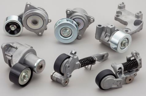

Originally Posted by maverickmk
I apologize if this has been asked a thousand times but will a serpentine belt setup work under a stock hood? See picture of the setup I am looking at.
I don’t see a tensioner in that photo
The alternator and AC pump are used as the tensioners.
Old Dec 27, 2024 | 12:09 PM
DblTrbl's Avatar
DblTrbl
Joined: Nov 2013
Posts: 889
Likes: 472
From: Central NJ
Most serpentine setups have a spring tensioner. It will work without it, but will need to be adjusted often.
