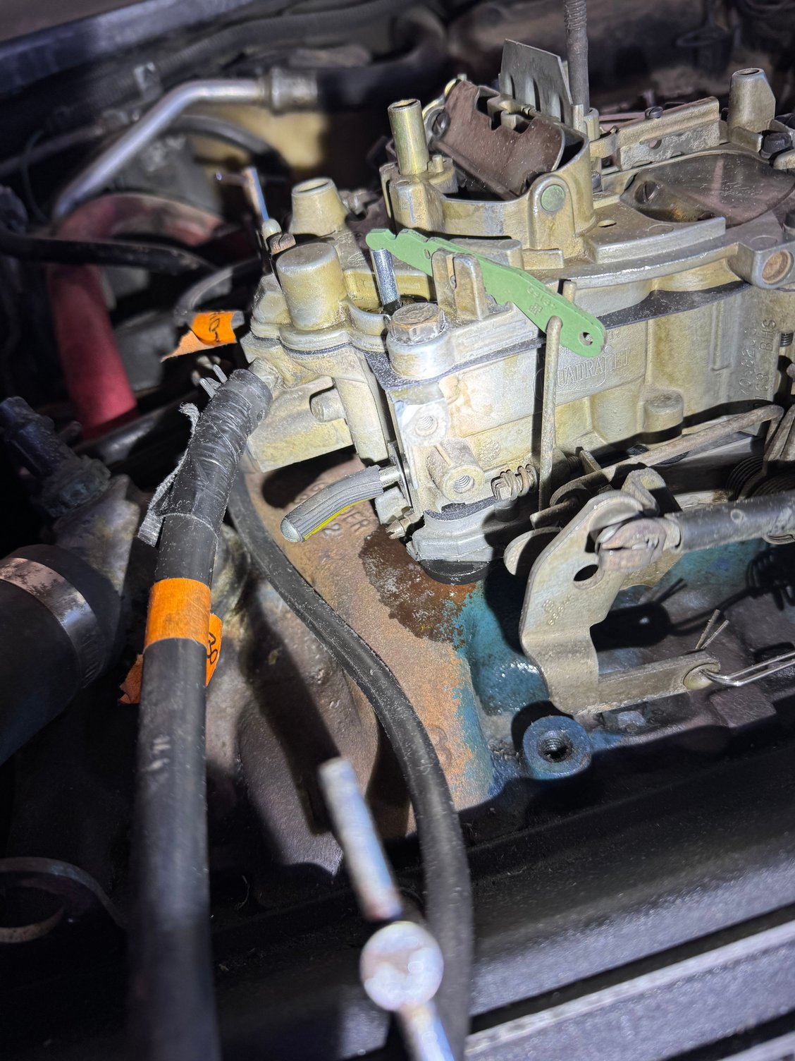

Carb is rebuilt but a couple of questions. I’m snug on the main 4 bolts but i keep leaking between the carb and the manifold gasket once the engine is off. Also is it normal for fuel to come out the top of the accelerator pump? I have a 1978 l48 4spd. I got the rebuild kit from carb doctor.

First thing I would do is put washers underneath the front two mounting bolts. Installing them without washers can mar the surface of and warp the airhorn as you tighten them.
Do you have a part number on the kit you used? Did you make sure to use an ethanol resistant accelerator pump? Did you make sure the gaskets line up perfectly from what came out of the carb? Does sit appear that anyone has been in the carb before? Lastly, what did you set the float level to?

You're leaking fuel past the needle & seat and have no fuel level control. You either have poor quality parts in the rebuild, a bad float, incorrectly set float, or a sticking float. The leak at the gasket has nothing to do with a leak at the gasket - you are dripping fuel out of the main discharge nozzles after shutdown, and the fuel is "wicking" out at the gasket and coming out the pump hole. Simply put: You have a poorly "rebuilt" carb that likely has more problems than what you have yet discovered... It needs to be torn down and properly set up with good parts. And where is your PCV hose..?

I have to take the carb off because I forgot to set the float level when I put a new one in. I’ll install some crush washer when I do. It’s carb doctor ck0145 and they said their accelerator pumps are ethanol resistant. Also found this gasket not sure if it goes under the spacer or between the carb and spacer
I forgot to set the float level when I rebuilt it. Didn’t even think about it. is there an easy way to adjust it?
PCV is another issue. Po removed it when he swapped valve covers to the wrong ones. I’ll be fixing that issue in a couple of weeks.

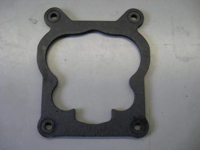

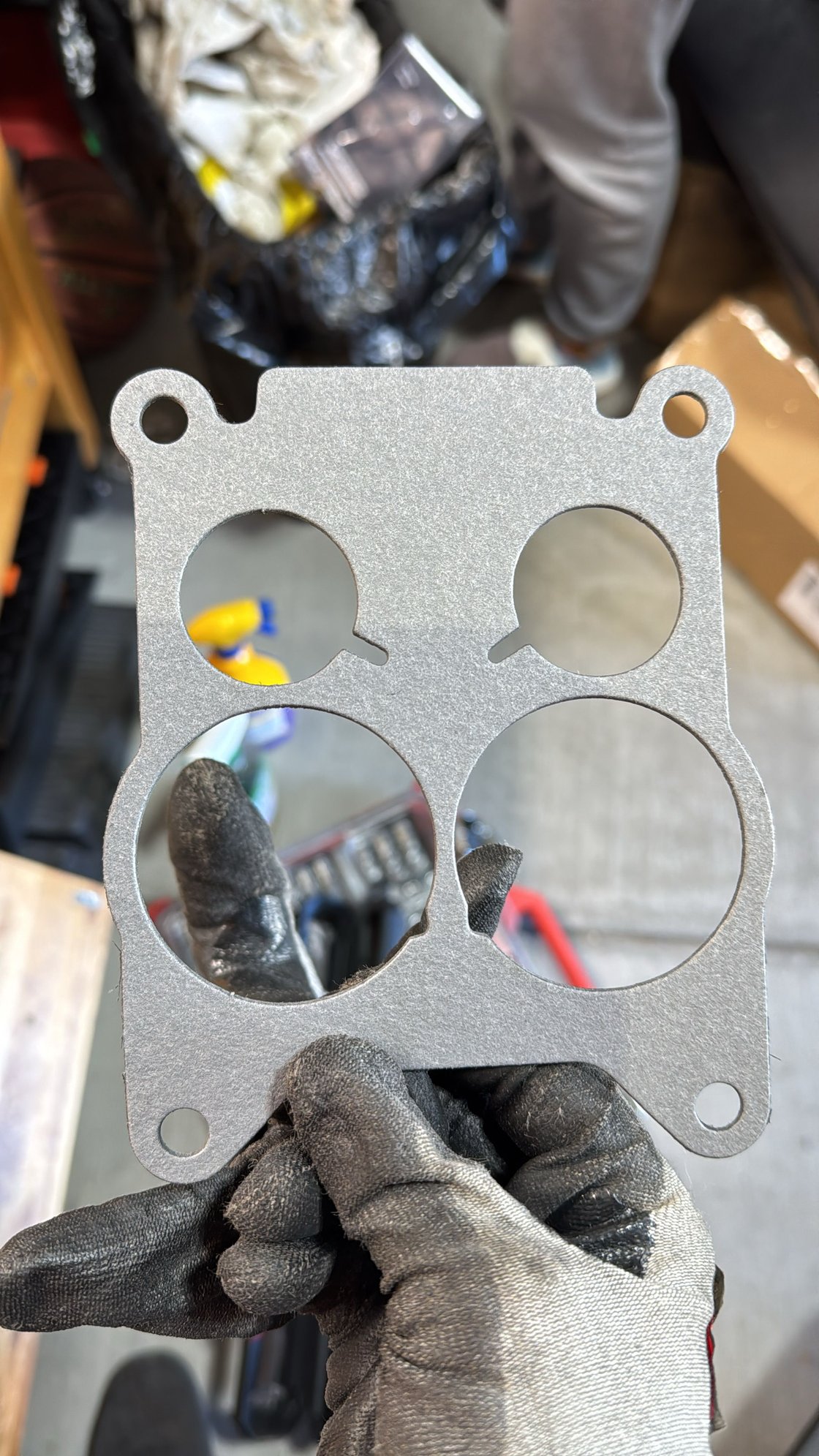

Take that gasket shown in the photo above and throw it in the trash - that is not the right gasket for a '78. Use this gasket only:
The pump you have installed is not the best, but it's not your current problem - your problem is that you have failed to pay any attention to setup, specifications, and adjustments.
Lars
you are not wrong lol. I didn’t put that thin one in, I have the 1/4” spacer one in.

It's not a "spacer." It's the carb base gasket.
