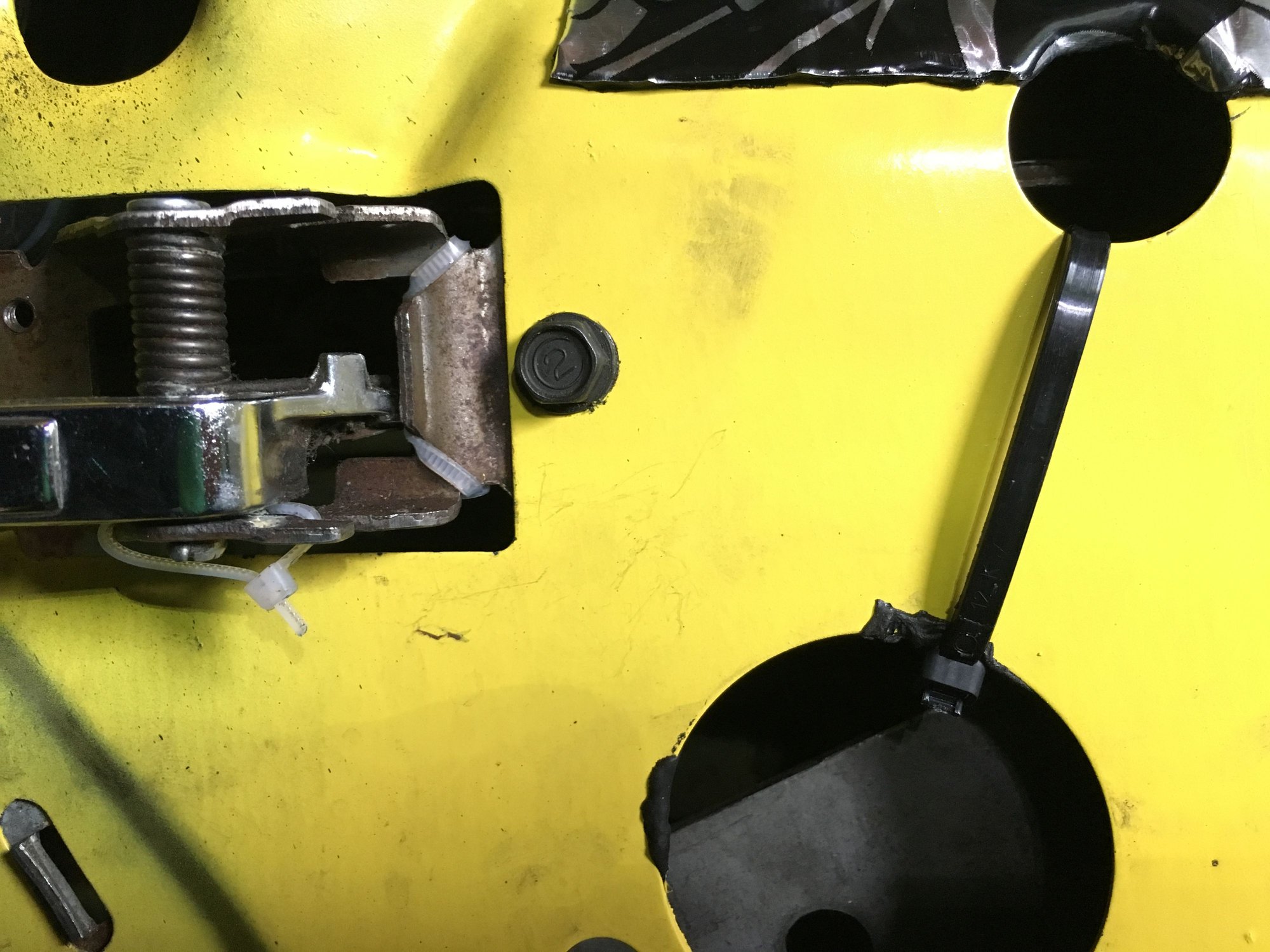

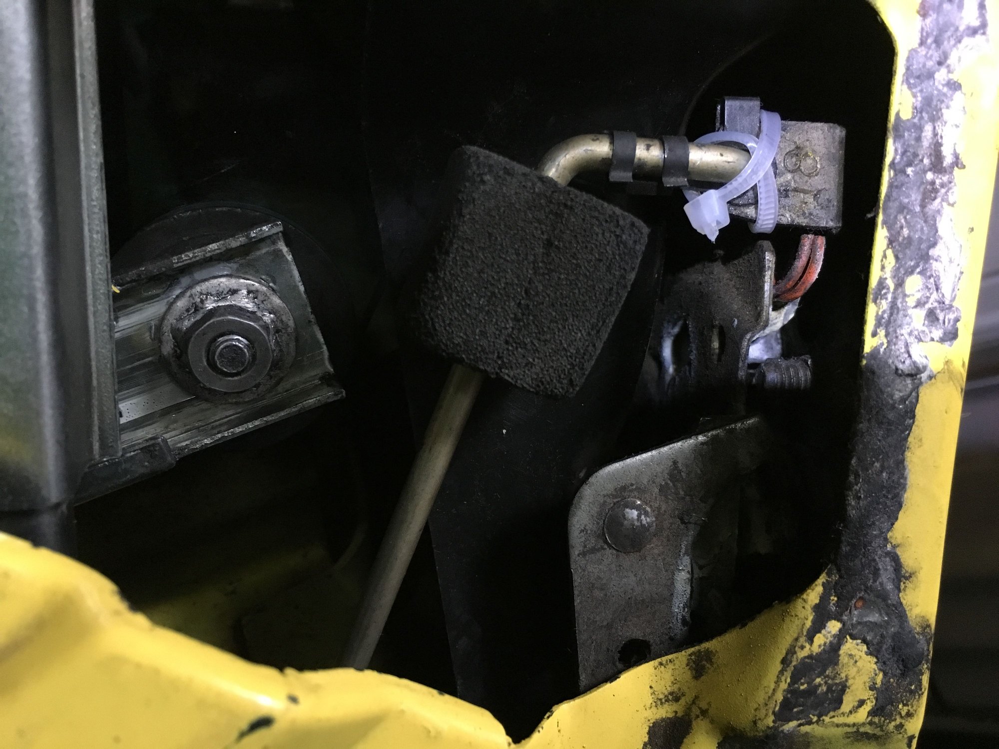

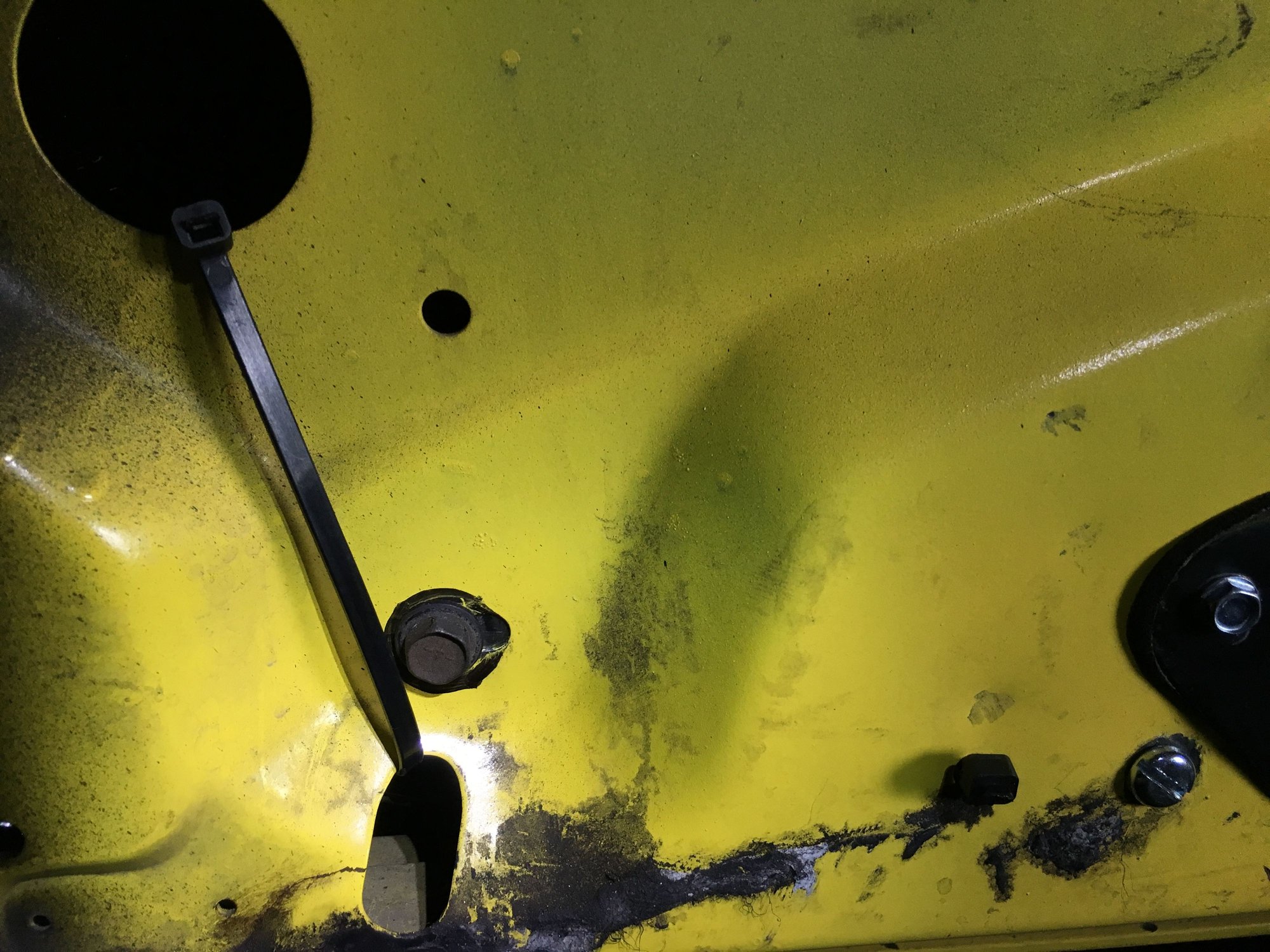

Judicious use of zip ties and a couple of extra anti-rattle pads are very helpful in quieting the door guts.
