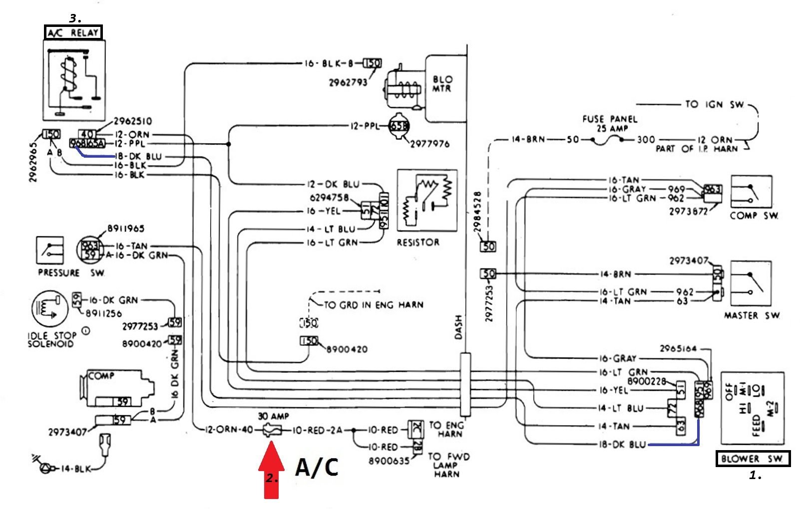

The resistor is only in the circuit when the fan speed selector switch is in the LOW, M-1 & M-2 speeds.
I would check these three things is this order...
1. There is a 30 amp fuse (RED ARROW) down below the master cylinder, make sure that is good.
2. At the high speed relay make sure you have voltage between circuit 150 & 968 (I believe that is what energizes the relay when HI is selected on the Blower Switch) Dk.Blue wire.
If the engine is OFF you should be able to hear the relay energize, a click sound.
3. If you hear a click and have voltage between 150 & 65A and still no HI speed I would remove the High Speed Relay and you can peel back the little metal tangs on the cover to remove it. Use a piece of light sand paper and clean the contacts inside the relay...
Thanks. One thing I did see online is there seems to be some question about some C3s having the 30amp fuse under the master cylinder but I will check that and everything else you listed when I get back over to my car.
Pretty sure my 76 30a fuse is adjacent to the evaporator
