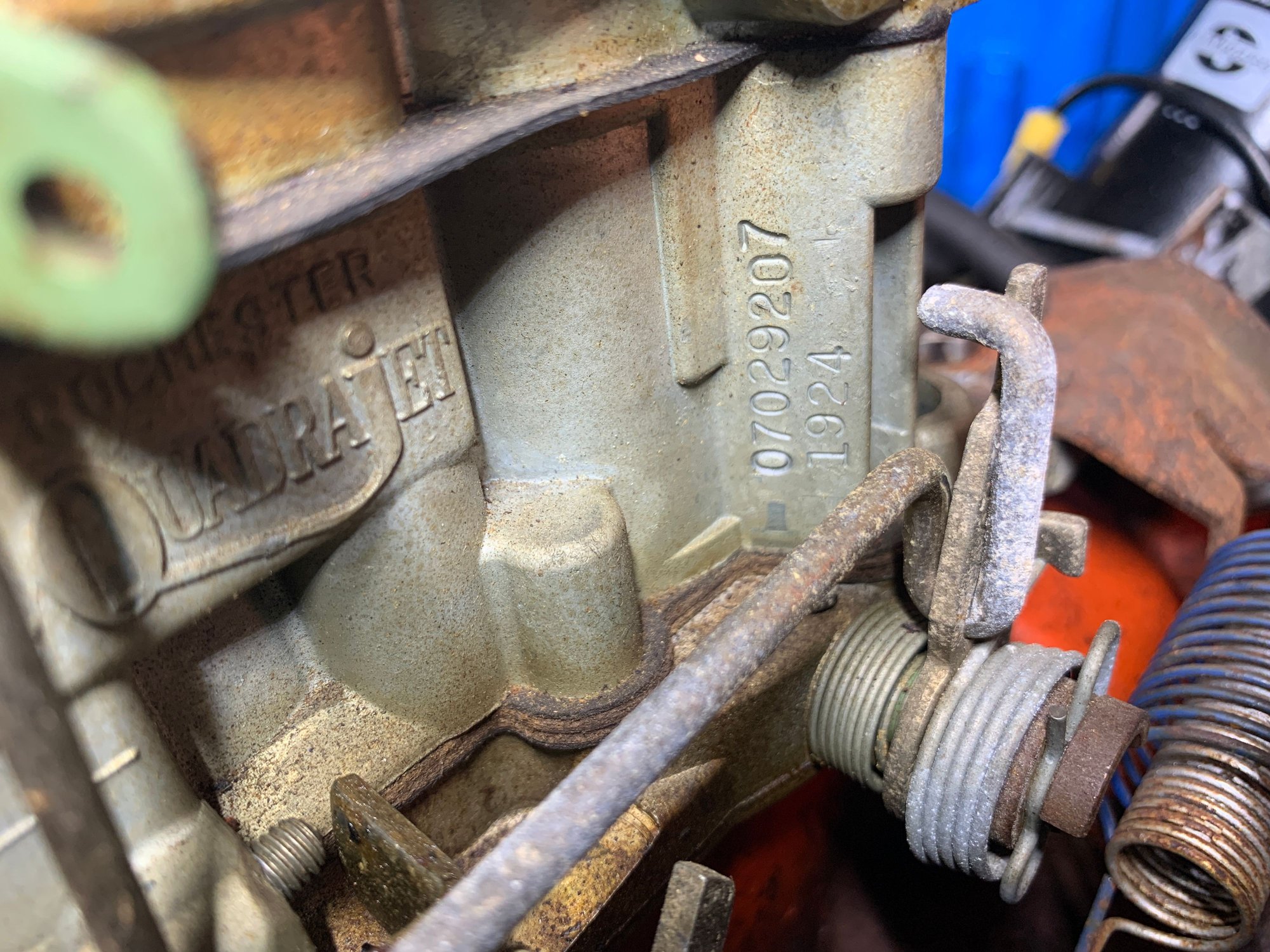

Default Original Carb?
I own a 1969 350/300 base model coupe with the original motor. I was decoding the numbers on the Rochester quadrajet and the date seems kind of funny to me. The model number is 7029207 which I think is correct for my car from the research I've done. The date stamp is 1924, which I believe to be July 10, 1964.I know the Rochester carb build dates can be different from the model year of the car, but 5 years seems like a big difference. Maybe I decoded it wrong? Does anyone have any insight on this?
If its original to the car I plan on keeping/rebuilding it. If it's not I may consider upgrading. Thanks in advance everyone!

The carb you have is a Service Replacement carb for a 350/350-horse '69 built in 1974. It is the best Q-Jet ever built by Rochester, and you will never find an "upgrade" carb over what you have. There's not a carb on the market that will outperform it. The carb is "vintage correct" for your car, even though the 300-horse cars did not come with the high performance carb. If you want to get rid of it, and put a shiny new Edelbrock carb on your car to slow it down a little, I will pay postage and send you my address.

350 Cu. In. with 350 HP. Carb built on the 192nd day of 1974. IIRC the coding for Rochester Q-Jet. The “0” (zero) before the 7 isn’t proper, either. 7029207. I had one manufactured in 1985, prolly on my dad’s birthday, 158. Paid $85 at the local auto parts store. I had it set up for my F/SA ‘67 Camaro for $15 by a racer from Fort Wayne. TMI!

The 350 300 HP in 1969 used 7029202 for a automatic and 7029203 for a manual.

Excellent info guys, i really appreciate the responses. Lars, guess i will rebuild it!

Make sure you buy your parts from a good source and not off eBay, Amazon, or from any of the storefront auto parts stores - they will be junk Chinese parts. Make sure you identify and rectify all the "mods" that have been done to the carb over the past 50 years and set it up properly.
