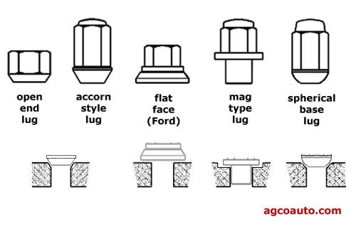

Are those lug nuts tapered/wedge shaped on the end touching wheel?

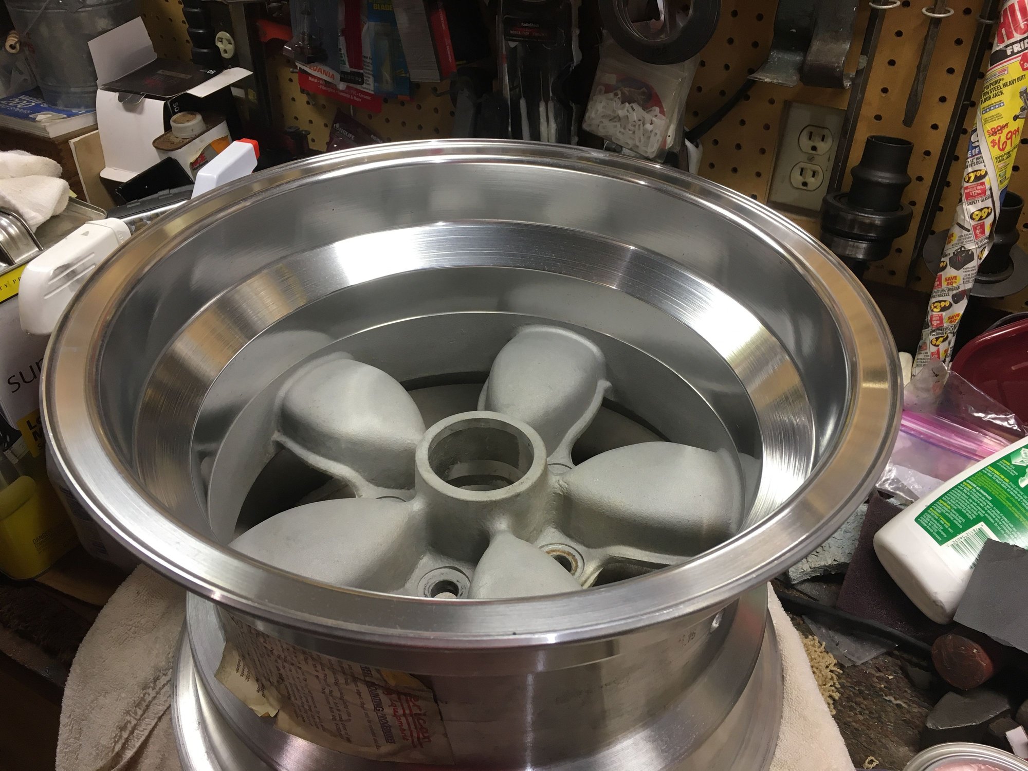

Old Jan 27, 2025 | 12:54 PM
69L88's Avatar
69L88
Posts: 3,416
Likes: 1,824
From: Apple Valley, MN
Originally Posted by hdeyong
Oh-oh. I think mine have tapered fasteners. I wonder if they've been the wrong ones all along.
Here’s an image of one of my 200s wheels. Note the machined “flat” to which the washer on the lugnut mates to. Pull off one of your lug nuts and shoot a pic of both the wheel and the lug.

I posted that image of lug nuts to show you the different types, yours kinda looked like acorn tapers to me but it was hard to tell in your first photos. You might need mag nuts but I’ll let someone with those wheels chime in and let you know which ones you should buy.
You may have found the problem with your nuts.
