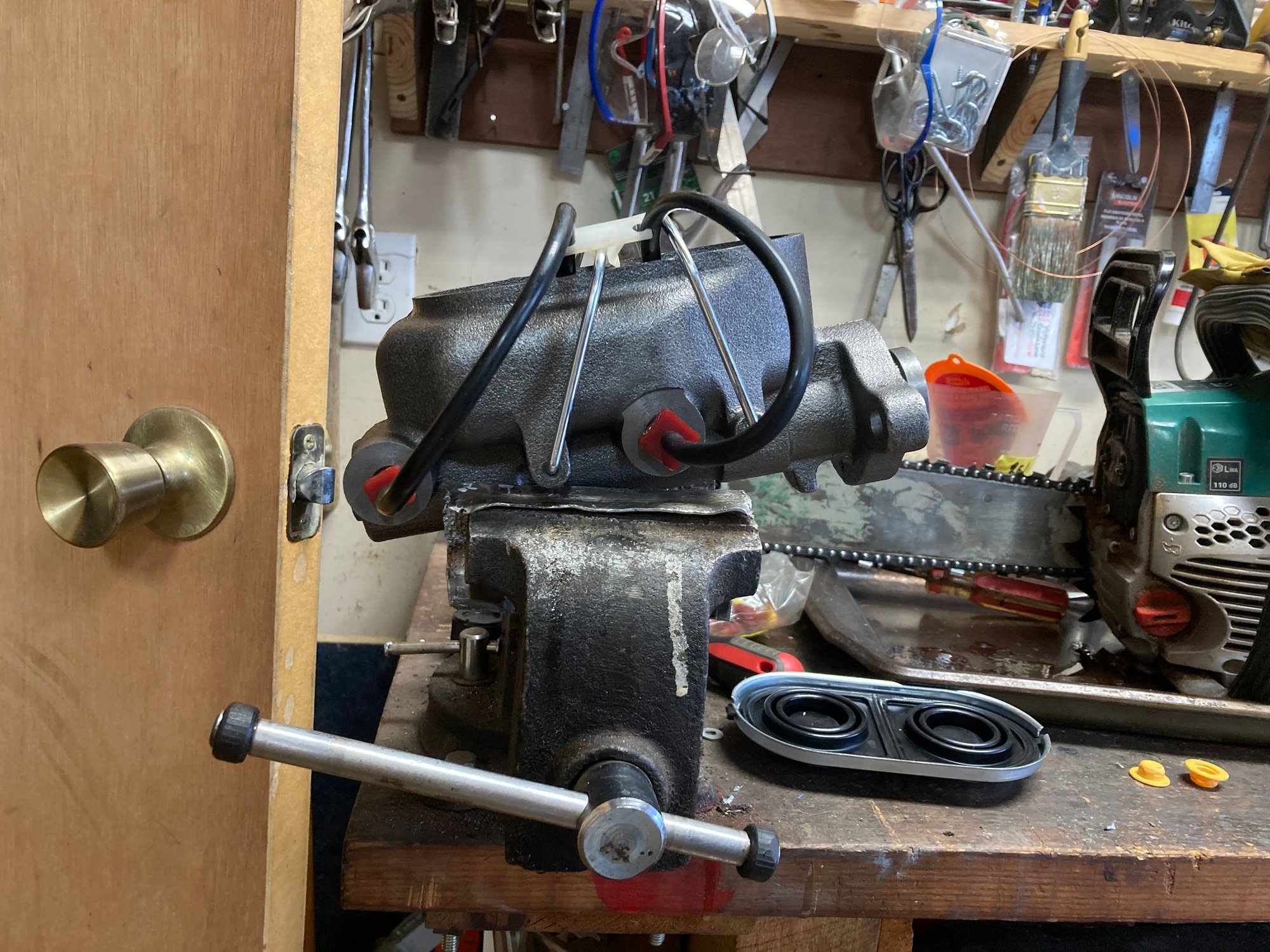

A tip for bleeding a master cylinder tilt the front down and you can remove more air.
Does the chainsaw help get the air out?😜

Old Feb 2, 2025 | 01:07 PM
laz749's Avatar
laz749
Joined: Jan 2013
Posts: 193
Likes: 86
From: Arkansas
Yes
Old Feb 2, 2025 | 01:18 PM
thomas68's Avatar
thomas68
Joined: May 2024
Posts: 144
Likes: 131
From: Mid TN
Then start tapping on the side of it and even more will come out. It took a lot of effort to get all the air out of mine. Everytime I thought I had it, there was a little more when I tapped on it.
Old Feb 2, 2025 | 02:41 PM
HeadsU.P.'s Avatar
HeadsU.P.
Joined: Aug 2017
Posts: 8,336
Likes: 2,810
From: Cool Northern Michigan
Tilting?
Yup, So I heard. That's what some guy said on this forum yrs ago.
Be careful now when stroking that MC piston.
No more than 1 & 3/8" max.
Old Feb 2, 2025 | 08:13 PM
barkingrats's Avatar
barkingrats
1967 Pedal Car Champion
Joined: Mar 2020
Posts: 9,137
Likes: 4,248
From: US-PNW
Originally Posted by HeadsU.P.
Tilting?
Yep, and if bleeding on the car, raise the rear wheels so that the master has the forward tilt.
Old Feb 3, 2025 | 03:45 AM
cagotzmann's Avatar
cagotzmann
Joined: Jun 2011
Posts: 3,116
Likes: 598
This is with the MC connected to the brake lines on the car. Does the same thing as bleeding off the car, except you now remove the air after installing on the car.
Get the last bit of air out from the brake master cylinder. - CorvetteForum - Chevrolet Corvette Forum Discussion
Old Feb 3, 2025 | 03:52 AM
4-vettes's Avatar
4-vettes
Posts: 13,248
Likes: 7,840
Cruise-In VIII Veteran
Yup, tilt it forward, then back, then forward again. Air wants to rise up.
This isn't new.
