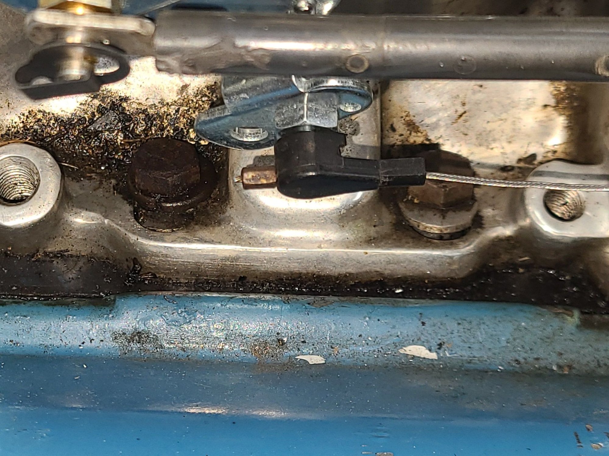

I have a spread bore manifold that Bubba dug up out of his junk pile and I'd like to put a new one on for my Holley Street Warrior square bore carburetor.
I need to re-stab the distributor and set the timing and thanks to @lars for emailing me the info to do that. So I figured while doing that I'd put a new manifold on the old gal. I assume the engine is stock so just looking for a decent manifold. One issue I have now is with a 14" air filter it touches the distributor if I'm not super careful putting it on.
And this just does not look correct to me... looks like Bubba modified the manifold to fit rather poorly.

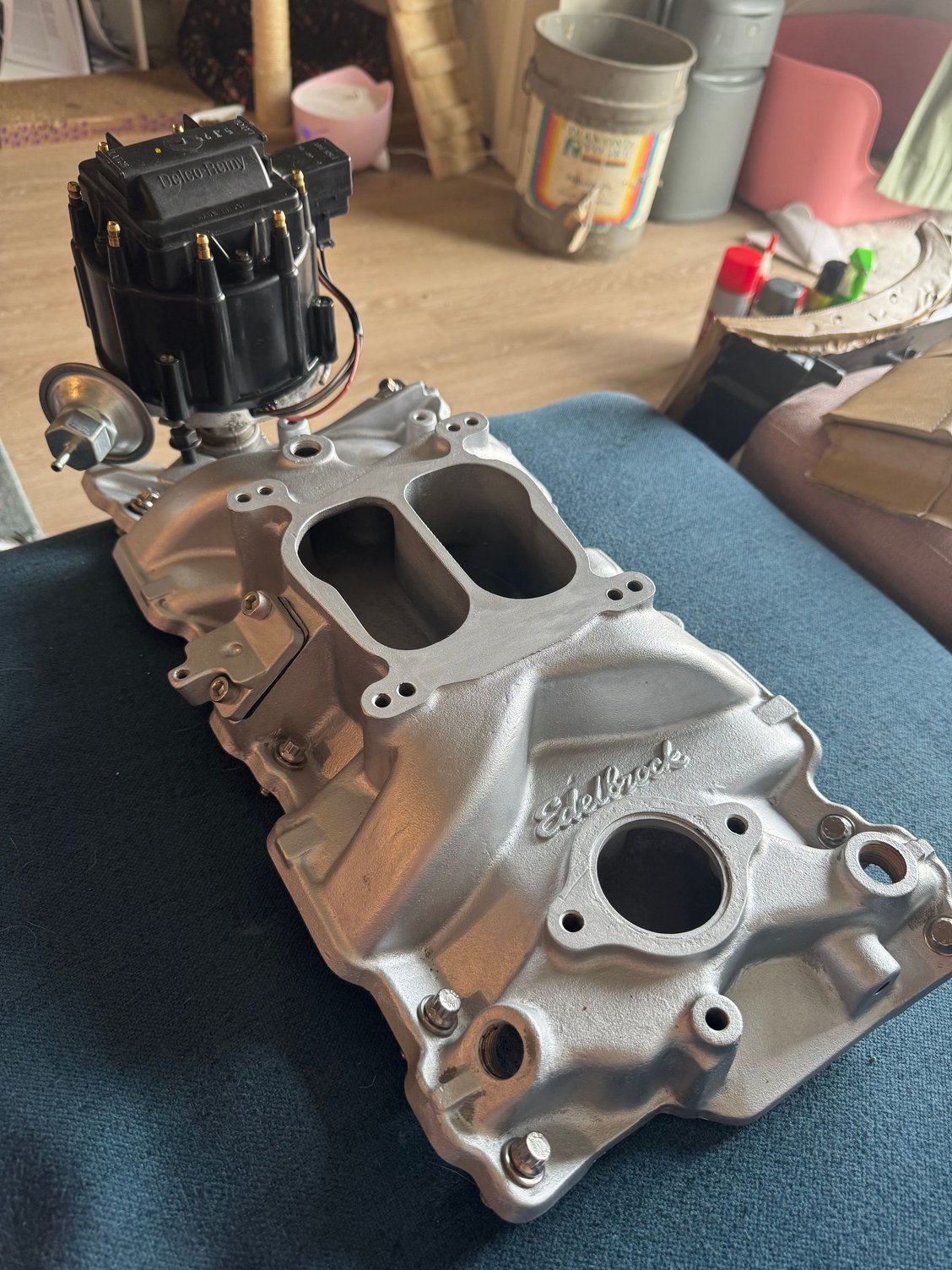

I’m still not exactly sure what intake you have currently, but looking at the choke block off plate it looks like an Edelbrock 2101 that has the logos shaved off.
Personally I would leave it. It’s more than adequate for the power the engine is making, it has a dual mounting pattern for any kind of carb you want to put on it, and it’s already aluminum which is much lighter than the cast iron ones.
If you clean it up you might find that it’s actually not that bad. Here’s a 2101 I just painted and mocked up with ARP stainless bolts and a freshly rebuilt HEI.
Here’s a picture of one on the other car, with the same exact carb as yours. This one will also be getting stainless ARP bolts.

@Piersonpie I would clean it up and use it if Bubba didn't butcher it up trying to make it fit something. The center 4 bolt holes have been crudely elongated by Bubba. So I figure if I'm going to replace it why not just get a square bore manifold... Bubba's work must go.

You're current intake wasn't bubbaize, it's a fits
-all meant to fit both early and late style heads. You can lose the ignition wire retainer on the distributor for additional clearance, it's not needed.

That Intake you have appears to be an Eddy 2101 "knock-off". It's really a smooth texture whereas the real Eddys are more porous looking.
If you can get a dollar bill between the air cleaner base and the dizzy, you are good to go. Those plug wires will not ground out.

Probably one of the Chinese knock offs from EBay or Amazon. They have the center bolt holes elongated and have no logos. As long as a good intake manifold gasket was used that blocks off the heat riser they’re actually not that bad of a casting.
