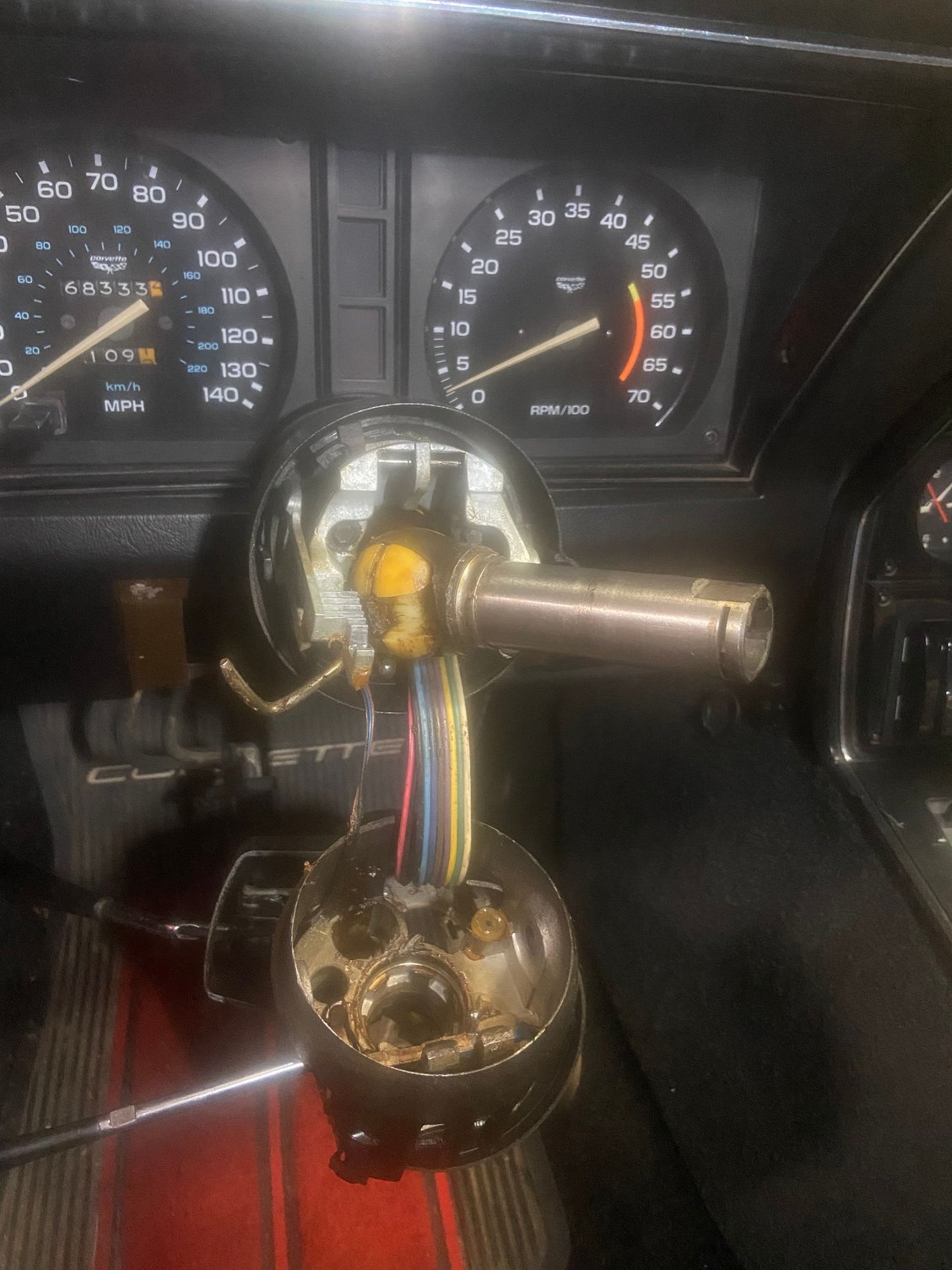

Bill, It's torn down to the point where you take the four bolts out and loctite them back. No springs just the lower shaft knuckle and upper tilt shaft. The knuckle seems to be locked in a position that I see as about the 2:00 position. I just can't find anyway to straighten it out again. The front wheels are straight nothing has turned just the locked up knuckle.

Hopefully this will explain better

Hard to see, but is it hung up on the ignition rack? If so, you ought to be able to remove the rack. Normally it would come out with the bearing housing but it stayed engaged on the ignition rod in your case. Interesting. So you can't move it at all? Maybe the next thing to do is to jack up the front and see if turning the front wheels a little will break it free. Another alternative would be would be to disconnect the lower column flange from the rag joint and see if maybe the shaft can move toward you, or at least be able to wiggle it to break it free.
BTW I don't see the lower bearings in your bearing housing.

Thanks for those suggestions, however it's not frozen solid, it will move a little bit and it's not hung up on anything. I just can't straighten it out, like it is hung up on something internal.
Yes you are correct the ball bearings from both of the upper and lower bearings fell out during disassembly, I noticed there was not much grease in either of them which is most likely why the bearings fell out. Still need to make sure I can find all the ball bearings. This also didn't happen in my first rebuild 25 years ago.
I'm thinking that I might need to take the entire steering column out....maybe it will help in some way.

Then the only thing that it can be hung up on then is the little u spring between the plastic spheres. That little spring is catching on the fork arm of the steering shaft would be my guess. Should be able to free it by some wiggling. See if you can see any of the little spring exposed on either side and try to push it around. May have to turn your wheels to expose the back side. The spring looks like the one below and it preloads those plastic spheres into the knuckle.
I have about 100 of those little bearing *****, so if you lose a few, I would be glad to send you what you need. Taking the column out is no big deal, but shouldn't be necessary. Can't imagine that thing won't break free though.
Looking at your picture again, instead of trying to straighten the shaft, can you push it toward 3:00? If you can, at 90 degrees it should come off the steering shaft.

Ok...after jacking up the front end and turning the tires so that the tilt shaft was aligned to the 12:00 position I was able to take the knuckle apart. Now I need to understand the correct way to assemble it again. There is a clip between the two halves of the knuckle and that clip seems to be getting in the way of a smooth knuckle operation and is most likely why it locked up when I was taking it apart in the first place.
Thanks for the tip to turn the steering column by jacking it up and turning the wheels by hand.

Glad you got it. You will see a channel on the inside of those two halves where that clip sits. Then grease it up real well, put the halves together with the clip in its channel, and install it in the removed half of the shaft first. Then hold it at a flat 90 degrees to the yoke on the steering shaft and turn it in. The clip might catch on the yoke when trying to close it, like how yours got stuck, but fiddle with it until it goes on. Make sure the short flat on the upper shaft is at 12:00 as well as the flat on the lower end of the steering shaft when the wheels are straight. If you align it with the longer flat, your turn signals will not cancel correctly.
