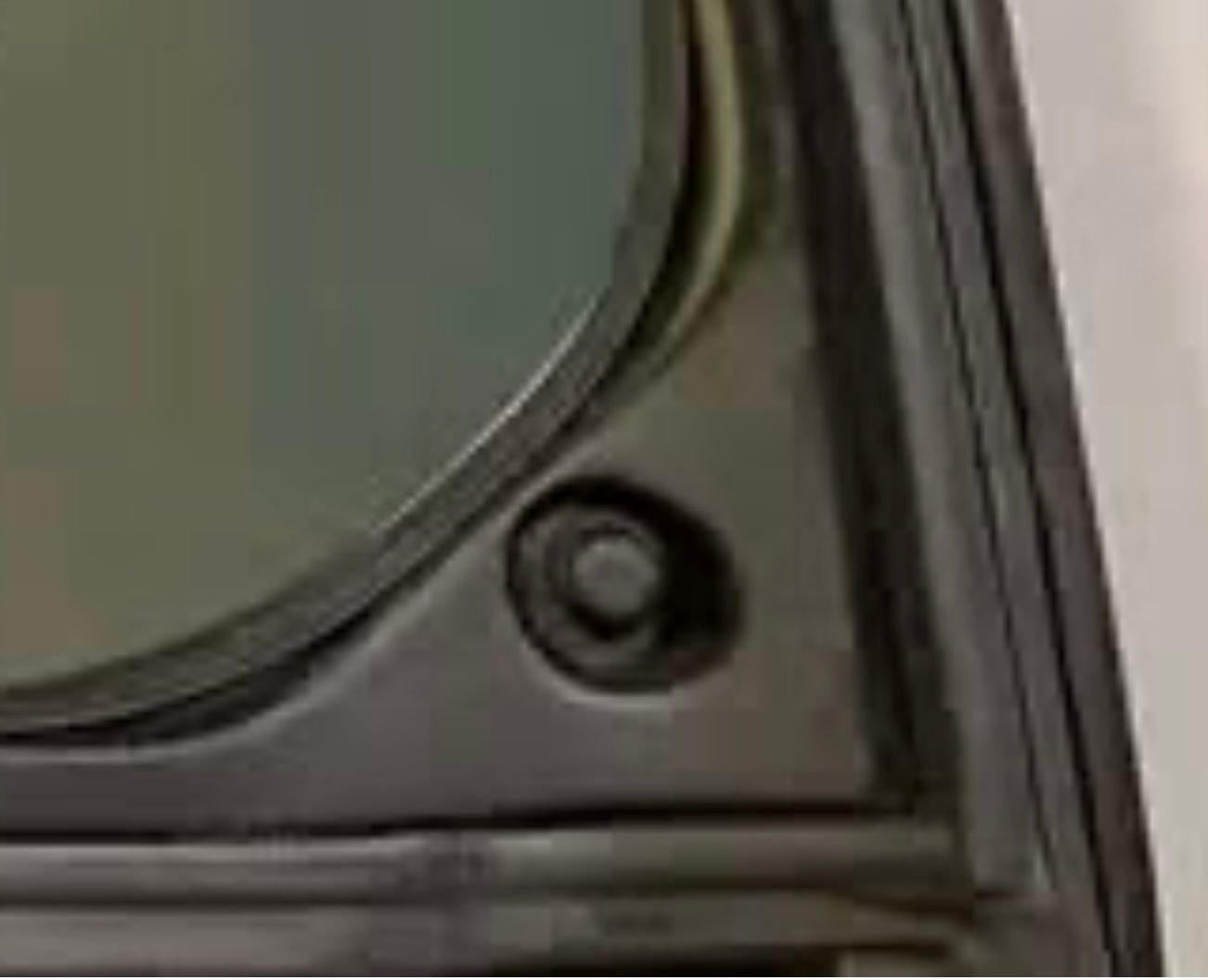

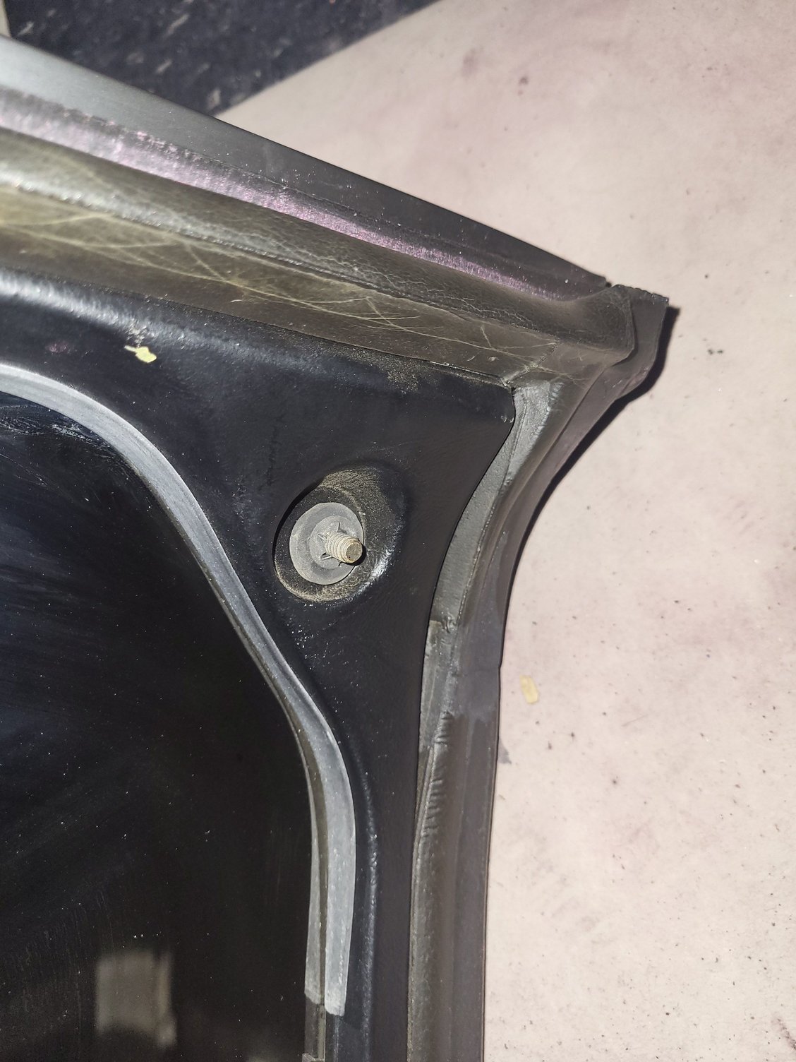

I had a little black plastic cap fall off my t top. Now I’m confused. I found a picture of a bolt in that location. But, my 1982 top doesn’t have the stud installed…just an empty hole in black plastic trim frame.
i Found a picture of the stud online. Should a 1982 have this bolt/stud? Mine is gone. Also attached a picture I found line showing cap installed….

Yes, there should be one in each corner, the stud is glued to the glass and the nut holds the frame to the glass. Not sure how the stud could have fallen out unless the glass is real loose from the frame, also not sure how the cap was held on if the stud is not there. Did you find a nut?

My 82 top... the cap should actually be threaded onto the stud.

I have one that has separated from the glass but still hanging there. My plan is, I have pulled the rubber moulding out of the way and I'm going to dremel the plastic in front of the head of the stud. Clean up the glass, apply glue and soft clamp the stud to the glass with the T-top installed to account for any flex. I'm deciding on the glue, glass guys say urethane but I'm not sure, this is a done once job and no do-overs...also considering something two part PC-7.... I plan to flatten the heads of two bolts and glue them to a piece of glass and see which one holds the best... And then probably go to the ER for stitches,,,, lol

my glass is attached good to the frame but I’d like to replace that stud as added insurance.
I was gonna try and find a corner glass stud online….hopefully put some rear view mirror adhesive on stud head and slide it into the hole…then let the glue set and add the acorn nut after a day or two do drying.
