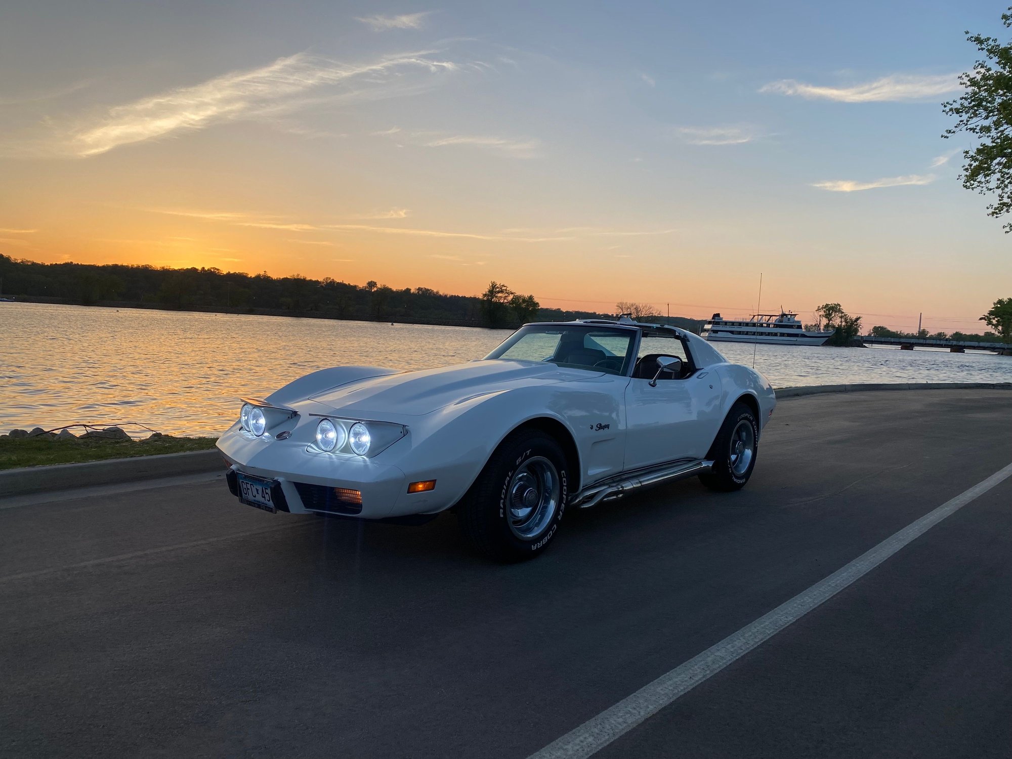

What do you mean by upgrade? Some people add relays, sealed beam halogens, or halo ring DRLs.
I have Octane Lighting LEDs in my ‘76.
