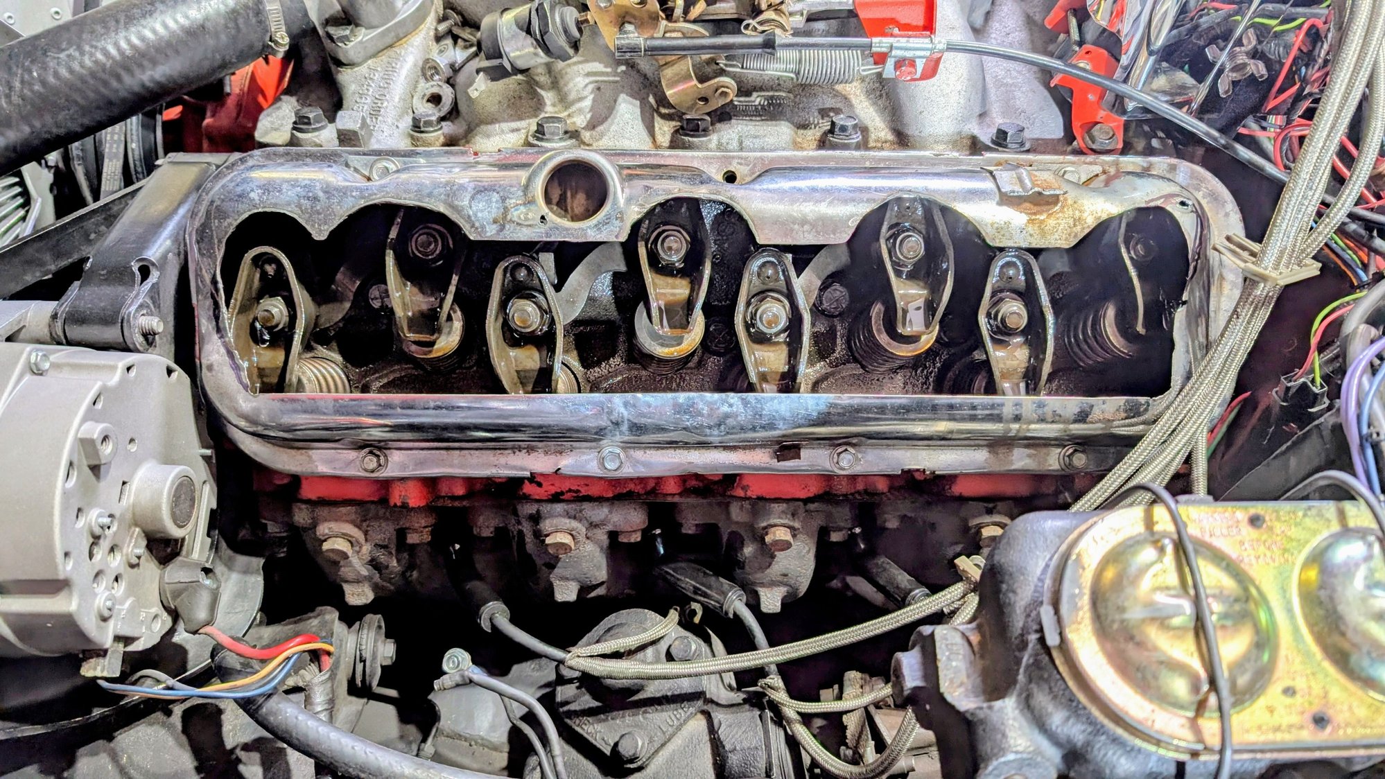

Default cover cut out

Lotta time; lotta work to make those covers. Nice work. Very necessary, if you had solid lifters. Not really needed for hydraulic lifters. BUT, I will agree that setting them that way will optimize their adjustment.

Originally Posted by BWPJS
my cut off covers look nothing like that, LOL! It took about 5 minutes to chop mine up. I wore good gloves to handle sharp edges! They worked though! I had almost no oil go splashing around
