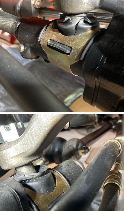

I've installed remanufactured power steering components including pump, valve, cylinder and hoses. I didn't see any problems as I was connecting the valve to the pitman arm. But as you can see from the photos the rubber boot was destroyed at some point. I loosened the castle nut just to make the damage more visible in the photos. Initially it was torqued to specs. Apparently I didn't have the ball stud and valve body aligned to mate properly with the pitman arm. I assume the stud should be perpendicular to the valve body and the body rotated slightly for the flat surface of the pitman arm hole to be parallel with the body. Correct?
I discovered this before driving the car. There's no fluid leaking, so I don't suspect any damage to the internal seals. I know I can purchase replacement boot and metal strap. However, I don't know that it's possible to tightly secure a new strap around the valve while it's mounted. Has anyone ever accomplished this without completely removing the valve?

That boot is a dust boot to keep dirt out of that ball joint in there. There is no fluid there. Well, there shouldn't be any fluid there.
Until you put up that photo of the boot retaining strap with a nut and bolt. I had never before seem that. In real life or in a picture. Best of luck finding that.
That boot and the normal retaining strap I have only been able to find by purchasing a complete rebuild kit for the control valve.
As per the vintage photo with the strap with a bolt. I think your totally out of luck.

In answer to the question about replacing the boot and retaining strap while the valve is still mounted.
There would be no possible way to replace the boot without knocking the taper loose from the Pitman arm. And that is the hardest part! After that, I guess it's possible. But getting that strap tight. I'm thinking it would be heaps easier on the bench.
I had to replace that rubber boot on my original PS control valve, as a replacement just caused looseness in the steering. Getting that retaining strap tight is not super easy, I never even thought about trying to do it on the car.

Looks like the main part of that boot is fine; just the top portion is torn. Any thought of just cutting off the torn part of that boot and installing a regular ball-joint boot in its place with good flexible adhesive to adhere it to the lower boot portion? All you are trying to do is keep moisture and dirt out of the ball stud joint.
