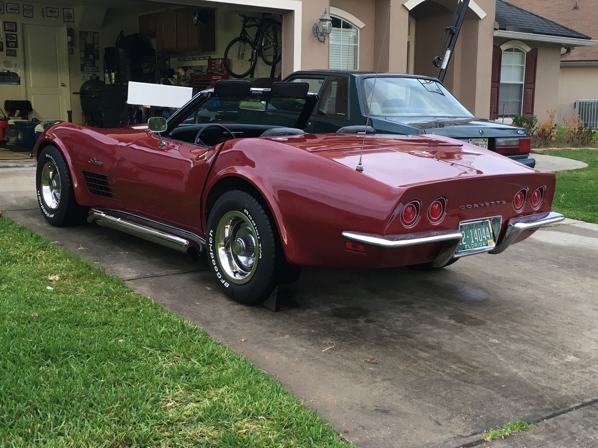

DWAVette's Avatar
DWAVette
Joined: May 2020
Posts: 1,663
Likes: 702
From: Baton Rouge, Louisiana, metro area
Originally Posted by Crimson Thunder
Just my opinion but we sit literally 5 feet from the back bumper of our Corvettes. A car with no crumple zone crash protection. (Fiberglass doesn't absorb it breaks away)
On my car with a Hurst shifter I added two more break lights and removed the reverse lights. I want double the light back there to reduce the risk of being rear ended.
I will add my 75 to your list of twin reds. I have a good backup camera that gets plenty of light from the led bulbs in my tails.
