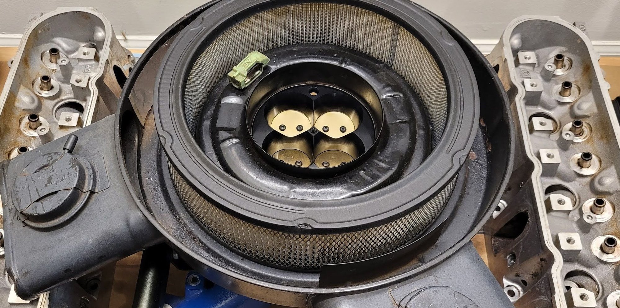

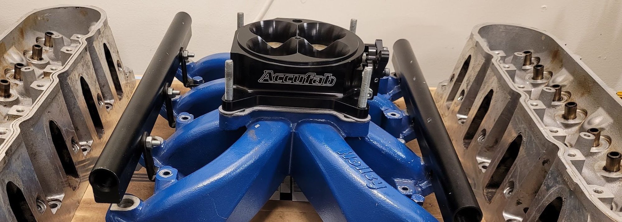

My local corvette service shop will no longer install Snipers on C3s. Too many conflicts.
They use & recommend a Holley Terminator X with a 4150 look alike throttle body.
Advantages: better fit, better software, more tuneable, separate ECM, 4150 look alike, etc.
Good to know!
The Accufab 4150 is exactly what I got for my LS6 swap. Still not 100% sure it will fit under the hood with the stock dual-snorkel air cleaner assembly, but I'm optimistic.
https://accufabracing.com/product/fo...throttle-body/
I'm using a Holley 300-137 intake for the LS, of course, But they make similar intakes for SBCs, and the Accufab TB should be the same. Made in USA!
