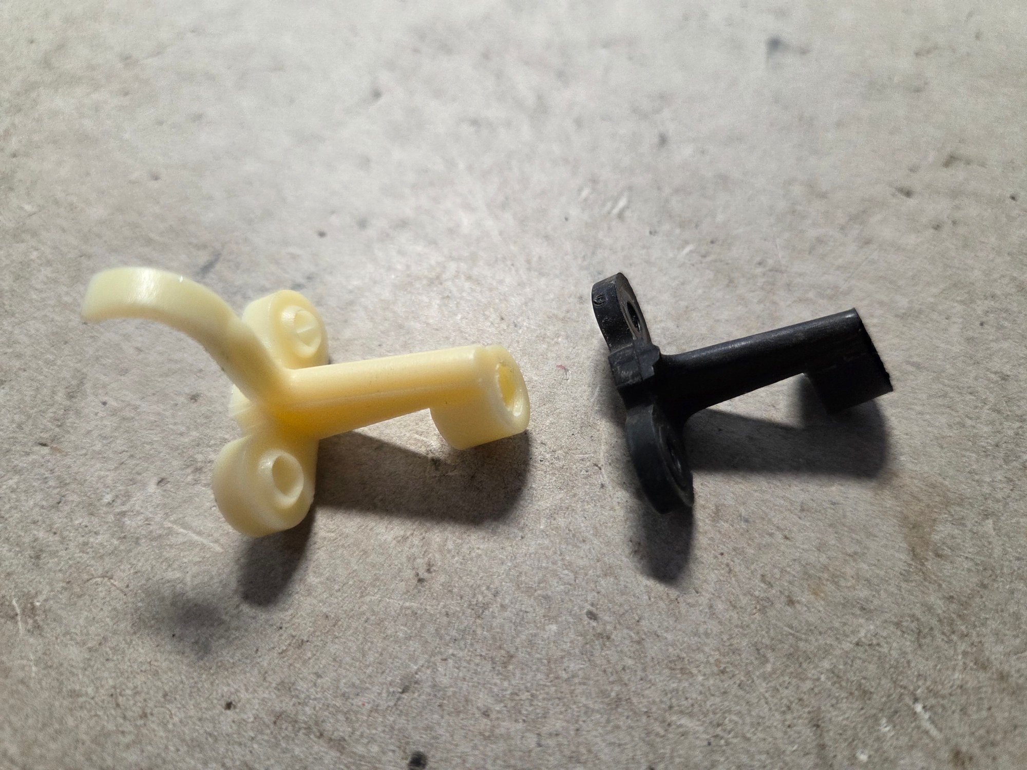

76 coupe headlight adjuster renew..the black one is the old one..do i cut the hook off the new one to make it look like the old one?? I think i do!!

i had that issue , iirc i just cut off the tail

Its what i thought but wanted to make sure..i can really screw things up sometimes...thank you for the reply

That "hook" looks like a 'filler sprue' for entry of molten plastic into the molding die. It didn't get cut off at the factory properly. Modern day "quality".....

I cut the “tails” off with a box cutter with a fresh blade when I did my headlights last year.
