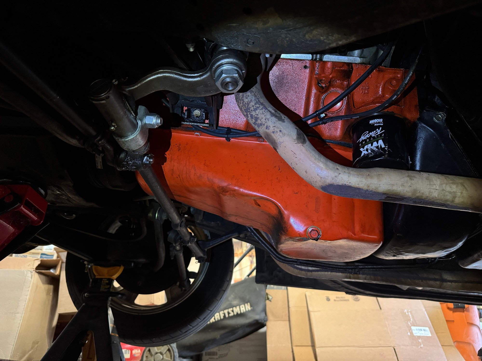

Here's my pan. I'm questioning if it is the stock pan, with the drain on the side. I did measure it and it's 7.5" deep. Also, It was beat to Hell when I purchased it. I think this is the first time I have hit it and of course it put a hole right by the drain plug. Notice the drip. I thought it was just the plug dripping, but there is a small hole right beside the drain.
if it is 7 /2" thats not the correct low profile pan if my memory serves me right. Should be about 7"overall if I remember right. I spent some time on this as im about to swap a 406 into my lowered 74. I intend on pulling the original pan I pulled off my l48 years ago when I swapped it to the 355 in the car now. I have other pans and they are only 1/2 to 3/4" deeper but that can mean all the difference. There are a number of 7 1/4" high capacity pans for racing out there. One concern is the stock power steering garbage hitting the pan but I swapped to a borgeson.and you seem to not have it either.

Yes mine plug it in the center in the back. a stock 350 pan looks like yours. I have a 400pan also which looks identical to yours and its 7.5"

That is not a "Corvette" pan. Its a generic replacement.
The early '70's "Corvette" 4 quart pan is not as deep and the sump is longer front to back so get the right "Corvette" pan and Corvette specific oil pan pickup. You will gain some extra clearance. Click below.

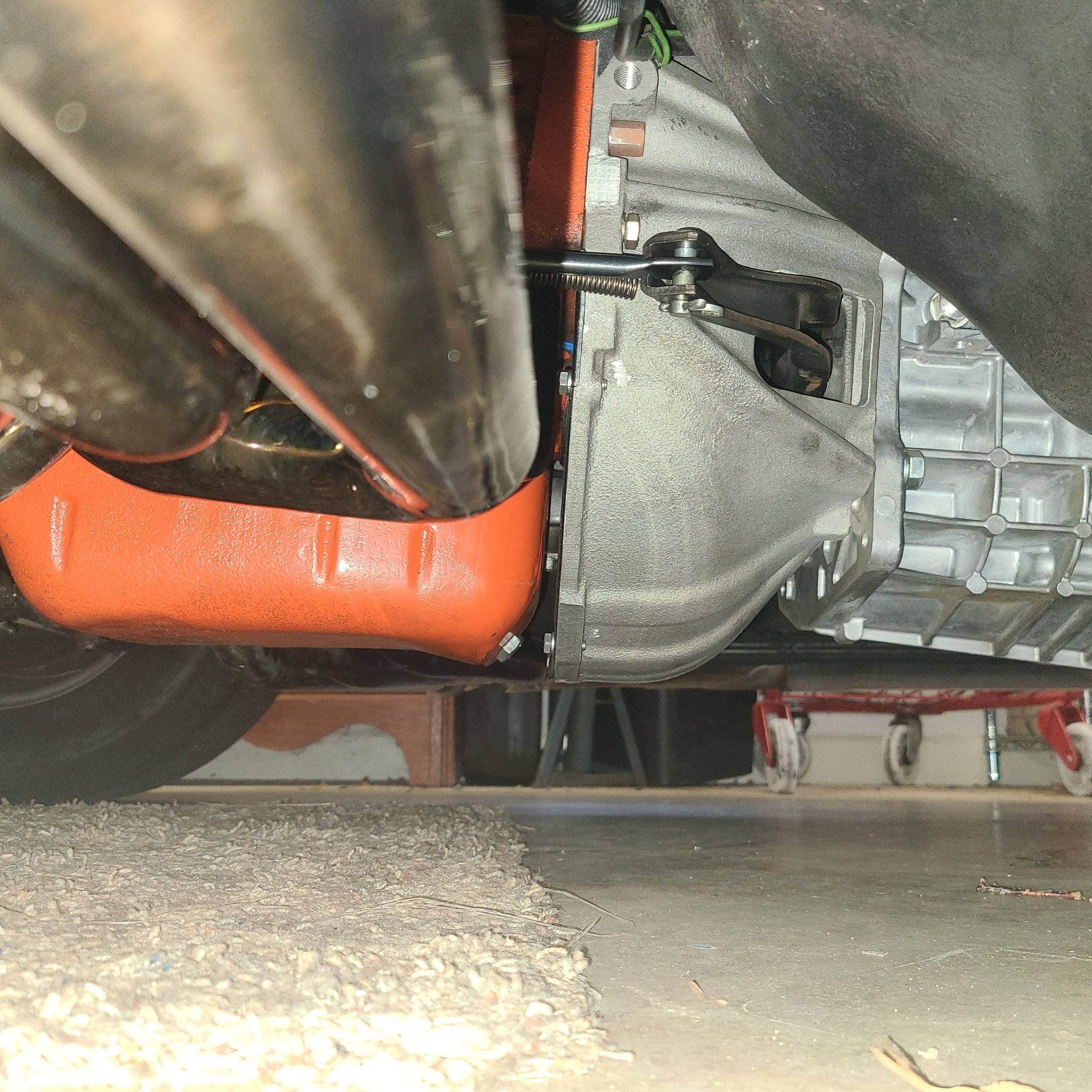

You are fine. The stock pan will 100% work with the 383. I have one on my car including the LT-1 windage tray.
Corvette pan clears close to the bottom of the bellhousing.

Huge sump.
Looks bigger / longer than my aftermarket 5 Qt.
