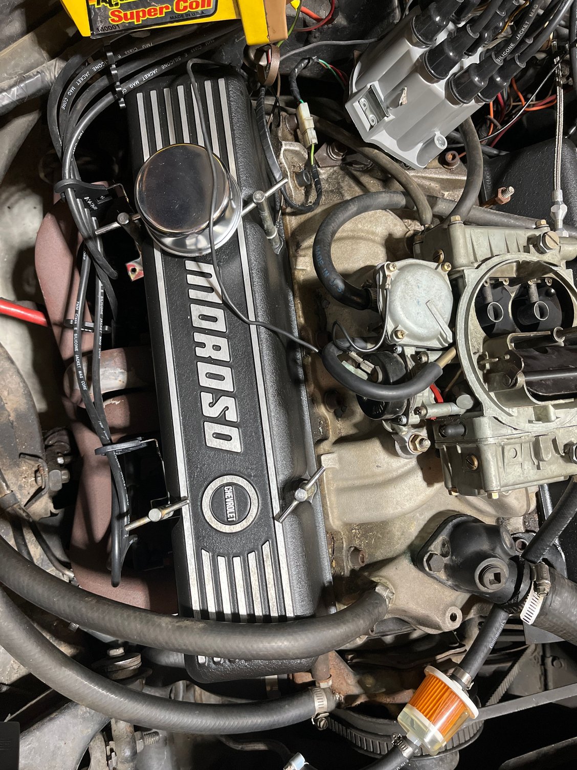

Hey everyone,
Im having trouble with keeping my 350 started, a couple weeks ago I purchased and installed new plugs, wires, rotor and cap, and I was able to start it up fine and it ran good. All the sudden a couple days later it doesn’t start, didn’t touch it or anything. I’ve been screwing around with timing and fuel but can’t get it to stay started, it will fire a couple times when I’m cranking but then dies. I’m certain the distributor is installed correctly and it does have fuel when I hit the throttle. Any suggestions on what it could be.
p.s I am new to this stuff so any advice helps
thanks

It sounds like it could be an air and/or fuel issue...
Does the choke flap move freely? It should appear completely closed but open about 1/4" upon cold starting.
Try pouring a couple of shots of fresh fuel directly down the carb, try to start it, and see if it runs a little longer.
Please post a pic from each side of the top of the engine without the air cleaner, someone might spot something amiss.

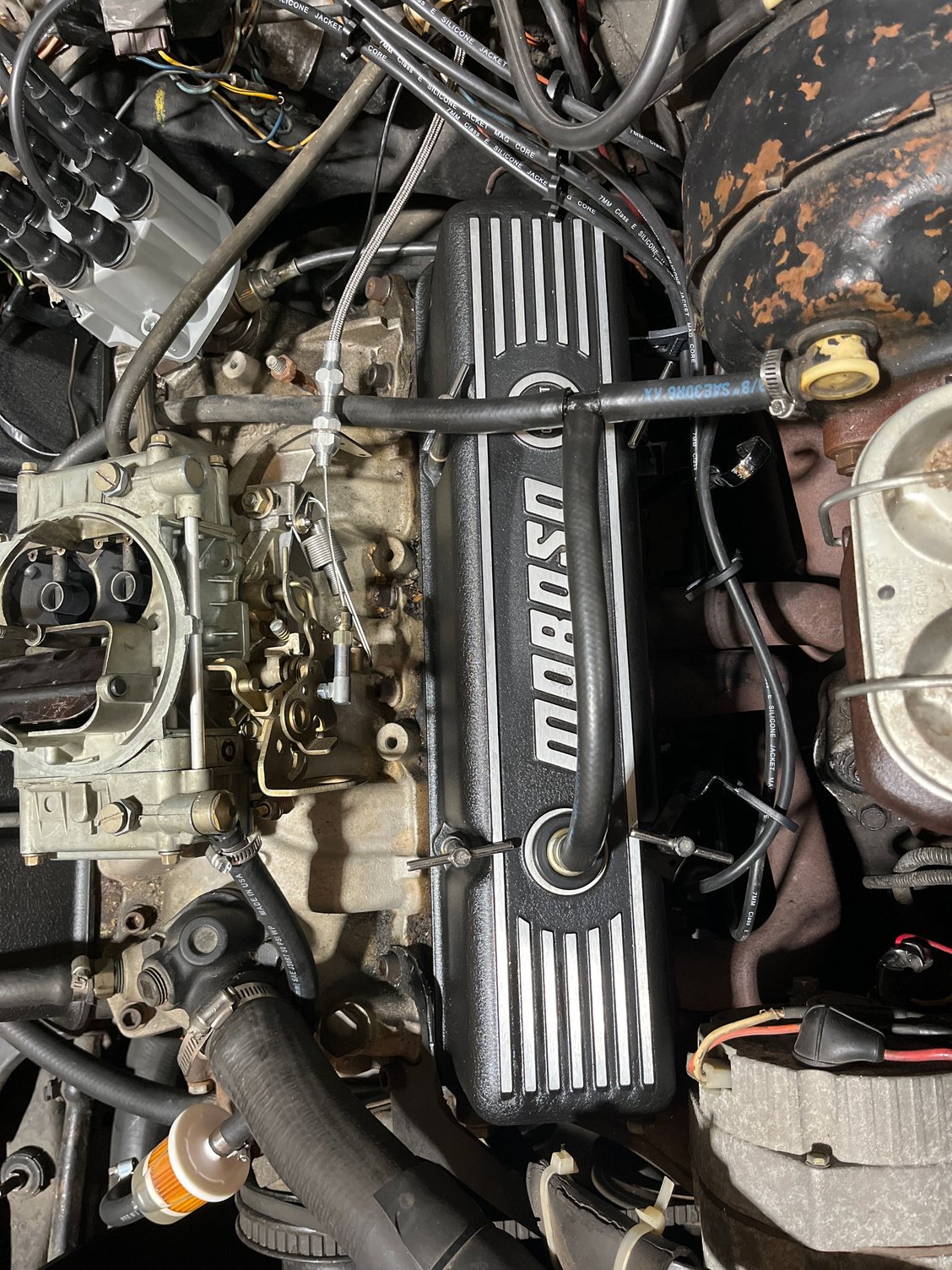

Hmmmm... so the engine quickly stalls no matter how much goosing with the throttle? I don't know if any of the following is the solution, but it may lead to a better understanding of the issue.
Yellow arrow: I think the throttle spring attachment is a little wonky. Can they be connected to the cable bracket at the yellow arrow? The slack in the cable should probably be lessened a bit - seems that in its current state it would have a hesitation.
Red arrow: On each side of the forward float bowl, count the number of clockwise turns to gently bottom out the idle mixture screws. Roughly speaking they should be about 1.5 to 3 turns to touch bottom. If you add and average the turns from each side and they are in that 1.5 to 3 range, return them to where they were. Make them equal if they weren't, for example, if one was 3 turns and the other 1 turn, back them each out 2 turns. If they were less than 1 turn each, back them each out 2 turns as a starting point.
White arrow: The end of the screw should be pushing some amount on the lever. If it's not, turn it in until it touches plus 1 turn. This is just for testing as the idle needs to be set after getting the engine operational.
[edit One last thought: hold the key on "start" to see if it will stay running. If it does but dies when you release the key to "on" then it's an ignition switch or ballast/resistance wire problem.]
I will re arrange the cable and springs tomorrow and see if it changes, but I have the screws in the side a 1.5 turns out and the throttle screw at 1 turn out. At one point it would only fire when I’m I turn the key to start, then when I let go it dies, but with me trying different stuff it doesn’t really do that.
