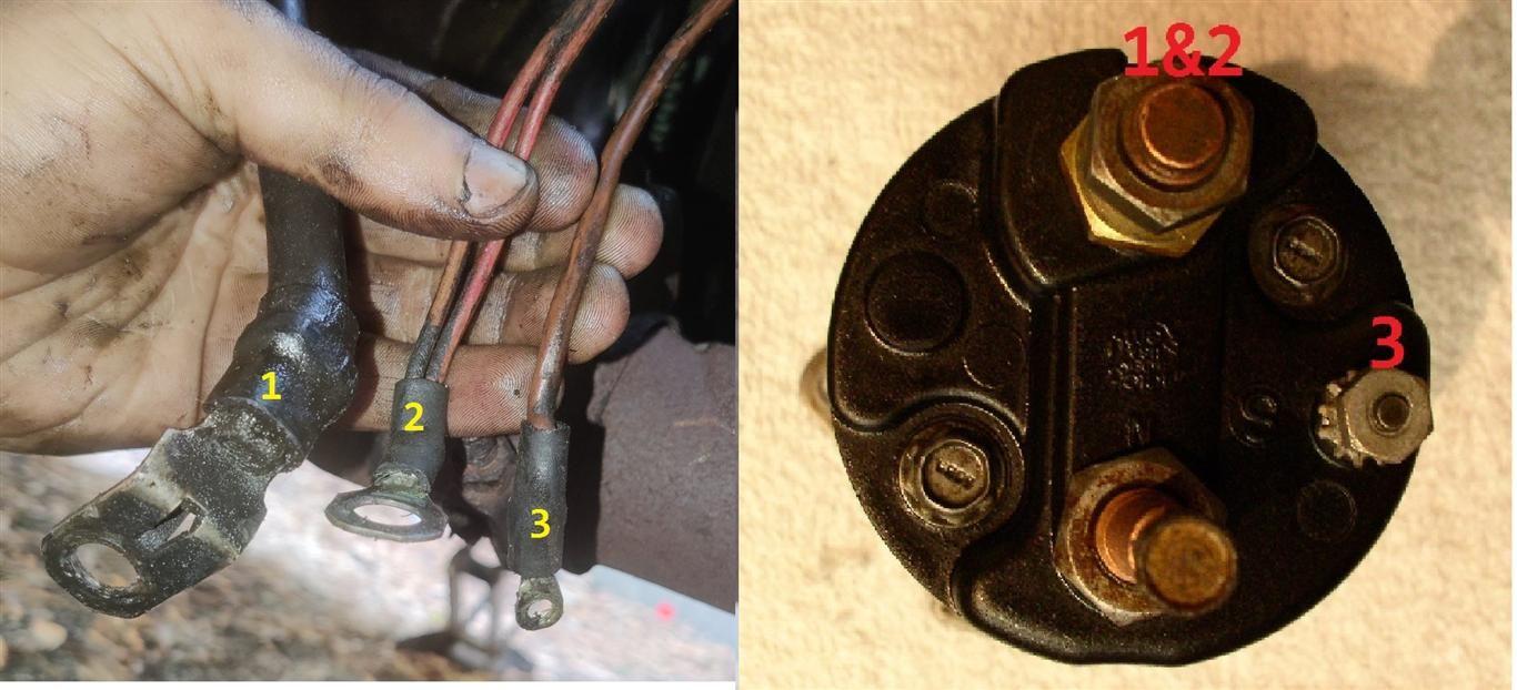

Not the same # of wires, but maybe this will help from another thread on a '79 starter:
Originally Posted by bmotojoe
You do have 4 wires.
#1 Positive cable from the battery
#2 Fuse link circuit(s)
#3 Start circuit
No other black wires will attach to the starter.
Somewhere in the starter harness there will be a #14 gauge black wire with 3/8" eyelet that connects to the lower bell housing bolt.
That #14 black wire serves as the wiper motor, blower motor and anti-theft hood switch ground.
May also serve as the coil ground for the high speed blower relay if A/C equipped.

This is correct...
The heavy ground wire attaches at the starter brace bracket to engine block.

I did acknowledge that your car does not seem to have the same wire number and colors, but the pic posted shows the '79 solenoid wiring from another thread.
How many electric terminals do you have on your solenoid? Try this screenshot from a Willcox diagram:

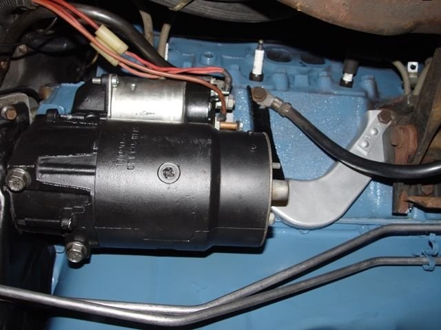

Bmotojoe mentioned the bracket, not I, however there should be one at the front of the starter to help support it to the block. The bracket bolt to the block is where a short frame grounding cable is attached. This diagram calls it a brace:

Here is the ground from the chassis to the bracket (brace). Also in the top left you will see a small wire going to a bolt on the bellhousing.

No I just don't get how my harness can be so different it's so frustrating I have figured out that I would say purple wire goes on lug closet to block my main big line goes in center and I guess the red and white and red and black go on main lug as well but I guess the solid red goes on there as and nothing on the other lug I'm just saying big lug middle with the two lugs labels r and s
I just want to confirm you are working on a '79, yes? With the wire colors it seems like an earlier C3 (or replacement harness?), but maybe not.
Is this what you've got?
  • purple wire
  • joined red/white & red/black
  • solid red (large terminal?)
  • large positive battery cable
With your 4-wires: of course the large ring-connector cable that comes from the transmission tunnel is the battery positive that goes under the large top nut. If you have a large ring-connector red, it should also pair with the battery positive under the large lug -- this is how the rest of the car gets battery power. The S (start) terminal should be the purple wire (small ring-connector); the R (run) terminal should be the joined red-stripe wires with small connector.
Thank u for that so basically I can just use starter bolt

I KNEW that starter bolt in the illustration would throw people off! The smaller horizontal bolt at the end of the starter bolt is what should be used in conjunction with the brace. But, if the frame ground cable will reach to a rear starter mounting bolt then that's OK too.

If you will be buying a brace and/or ground cable, the bolt appears to be a 5/16-18 x 5/8" indented hex head bolt like this:

One could also just bolt the ground cable to the block at that same brace hole without the brace.
