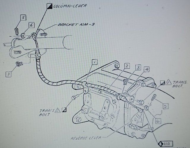

A few days ago I started a thread about not being able to get my 4 speed into reverse on my 69. With some good suggestions from here I removed the shifter and installed the common rebuilt kit. While at it I removed the interlock cable and found it a bit difficult to push and pull. After lubing it with cable lube it now moves freely. After installing the rebuild kit the shifter works great to all positions. While reinstalling the interlock cable it won't move the lever on the steering column upward far enough to allow removal of the key and locking the steering wheel. There was no issue before removing the cable and shifter, so I have to assume I have something out of position. Each end of the cable housing is secured in brackets on the transmission and steering column bracket. No adjustment on either end. The shifter rod correctly moves the reverse lever on the transmission as far forward as the lever will travel, even it the rod is disconnected. There doesn't seem to be anything I can do to get the cable to travel further to move the steering column lever more upward. Either end of the cable needs to travel about 1/4 to 3/8" further to get the cable to connect to the pin on the steering column lever. If I move the lever down to reach the cable, the key can't be removed.
Because I'm grasping at straws now, I'll throw this out there. Just before tackling the shifter rebuild I had removed all of the interior to install LED lighting, repaint everything, install new carpet and seat foam and covers. To give more working room I removed the steering wheel. Is there any chance I could have dislocated anything that would cause my issues? The horn still works fine and the steering wheel is properly centered.
Thanks
Mike

Maybe this will help some.

Thanks for the replies. After working on the car so long, I'm ready to get it back on the road and might take the path suggested by Bikespace. It just bothers me that I can't figure out what's changed to cause this issue.
I fully agree with HeadsU.P.
Thanks TurboTodd for the detailed information. I'll take a look to see if I can reach the nuts that must be loosened to make the minor adjustment described. Should be easier than reaching the power booster nuts.

Although the cable moves freely back and forth, when connected to the reverse lever I can't get the other end to reach the pin on the steering column lever. This is when the lever is in the 1 o'clock position as required to lock the steering wheel and remove the key. I've been reading related threads all morning. Didn't find any quick fixes. Now I'll go out to the car to see if I can adjust the lower column plate as described in the attachment of a previous post.

Sometimes you can loosen the cable hold downs and twist and turn the entire cable, wiggle it around until it fits.
To interlock cable
