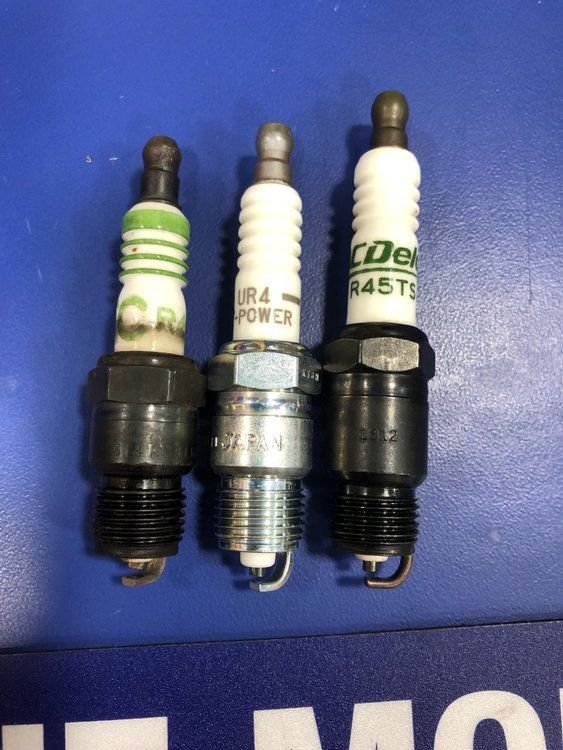

plugs i would for sure go NGK. Ac delco chinesium and too long compared to original.
