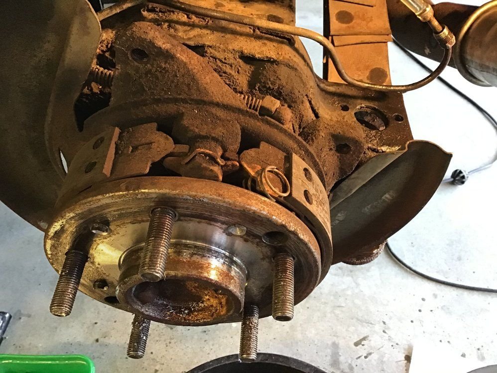

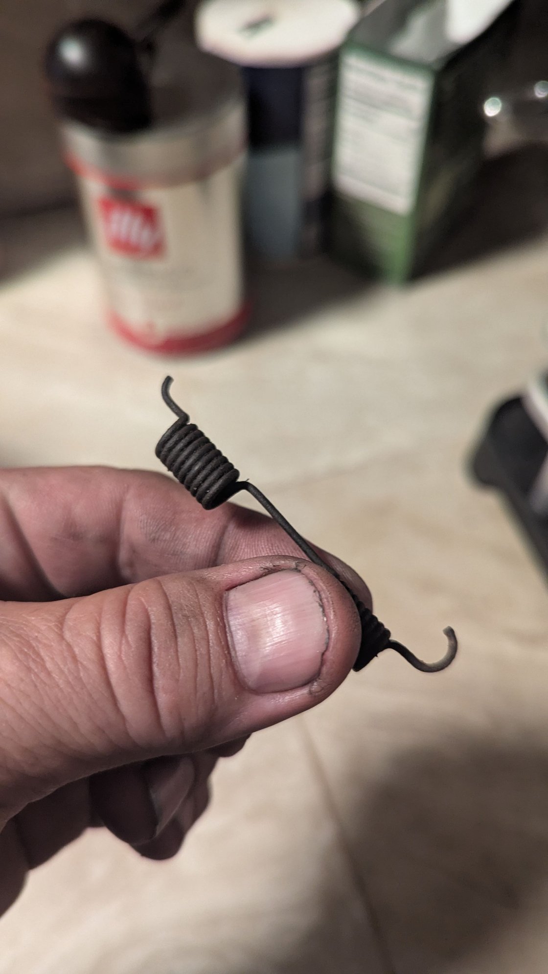

Thats what happen to my car. The driver side shoe spring broke, causing the shoes to jamb while backing up. it connects the top of the parking brake shoes.

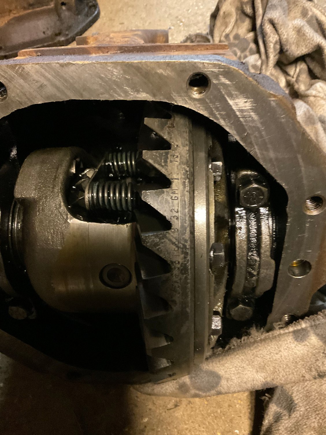

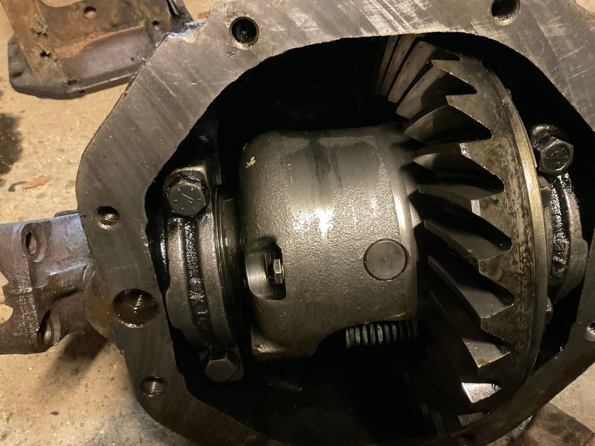

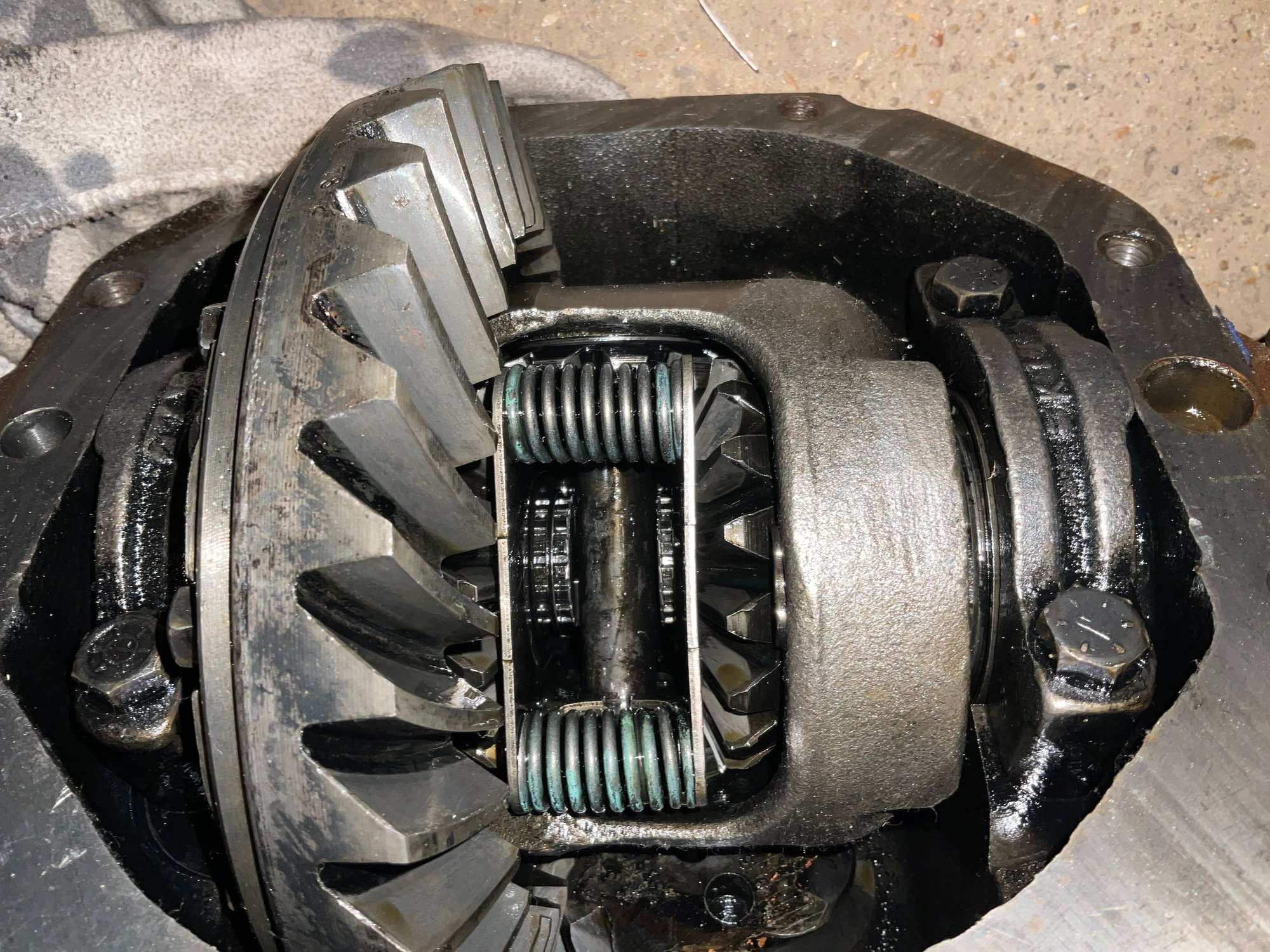

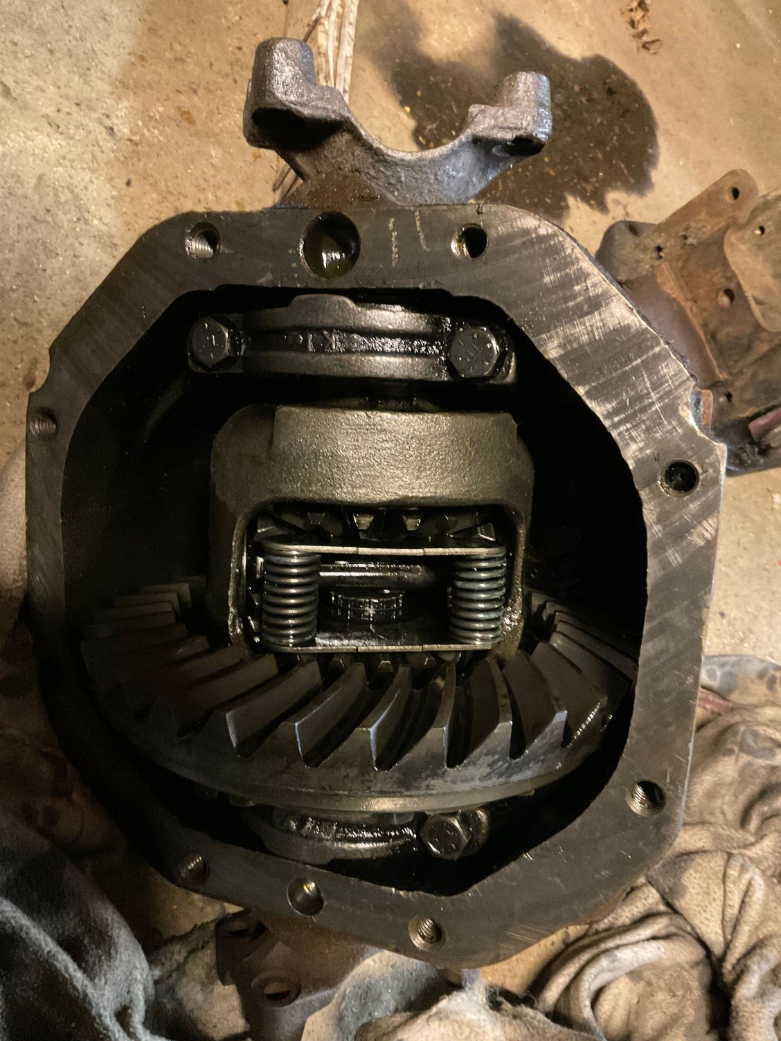

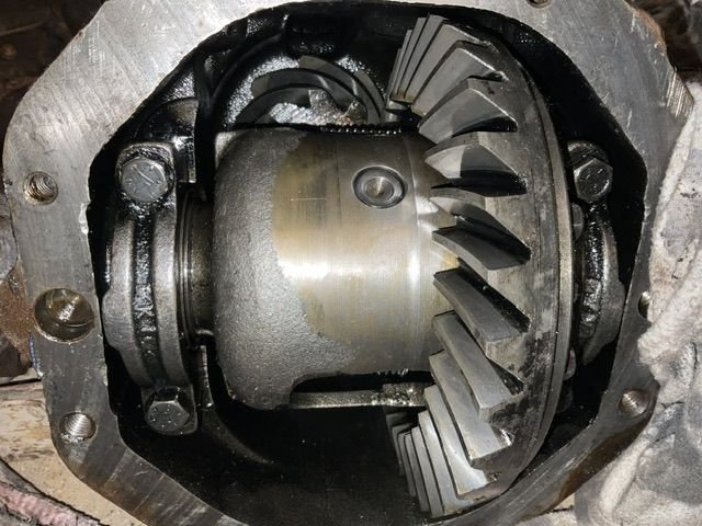

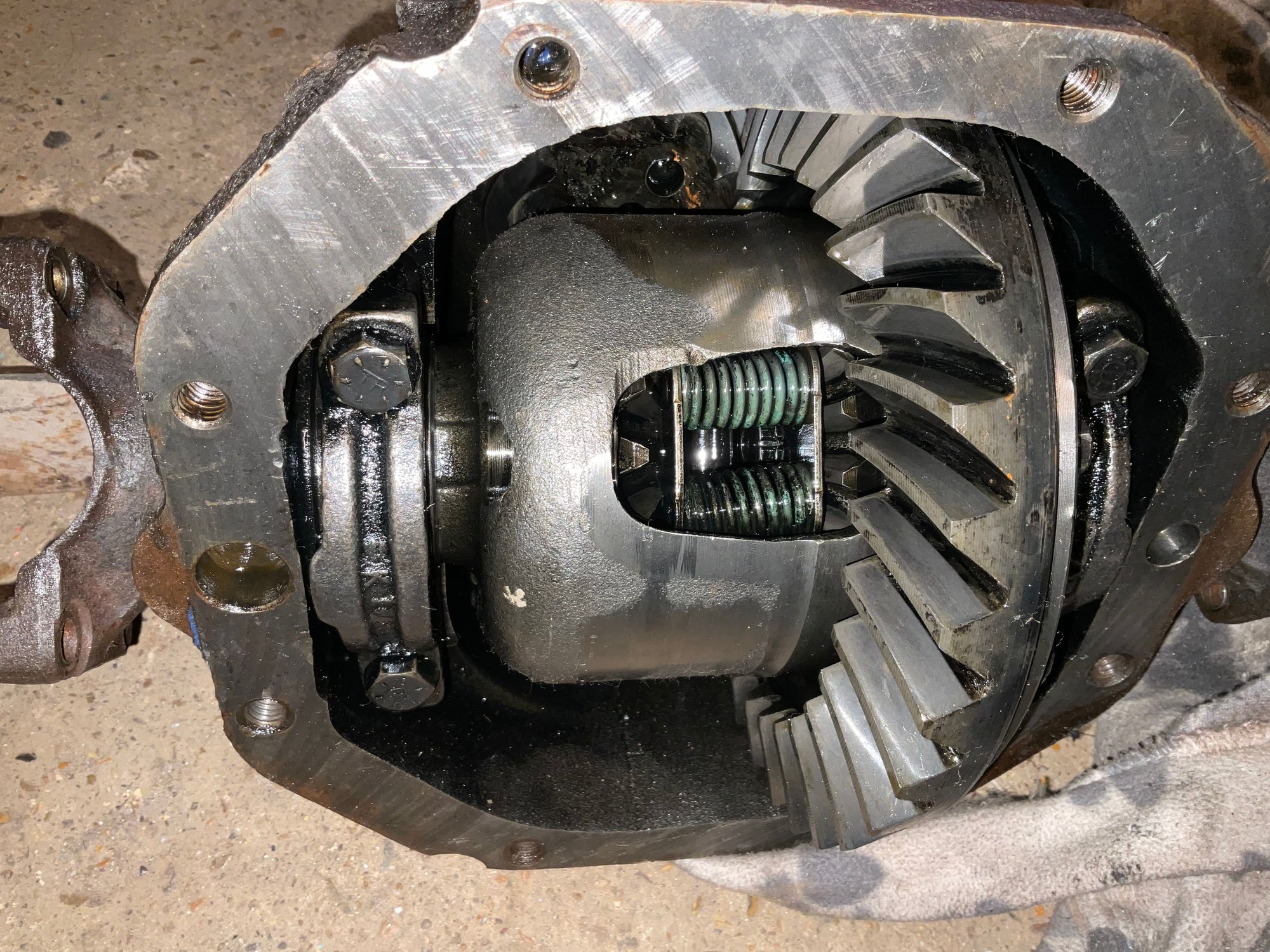

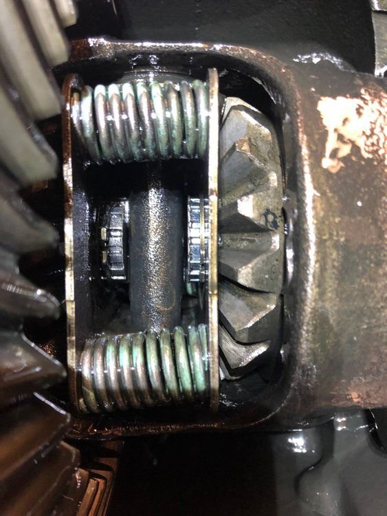

Unfortunately I have not had any spare time to dismantle the rear brakes as yet but did take some photos of the diff, no broken or loose bolts, teeth all fine, posi works but there is a lot of play in the side yolks, can’t see any hair line cracks either.
The stamped numbers
The stamped numbers
Inner ends of the yolks
Old Jun 10, 2025 | 04:38 PM
leigh1322's Avatar
leigh1322
Old Pro Solo Guy
Posts: 8,124
Likes: 4,485
From: Marlton NJ

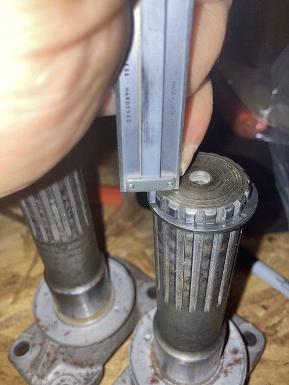

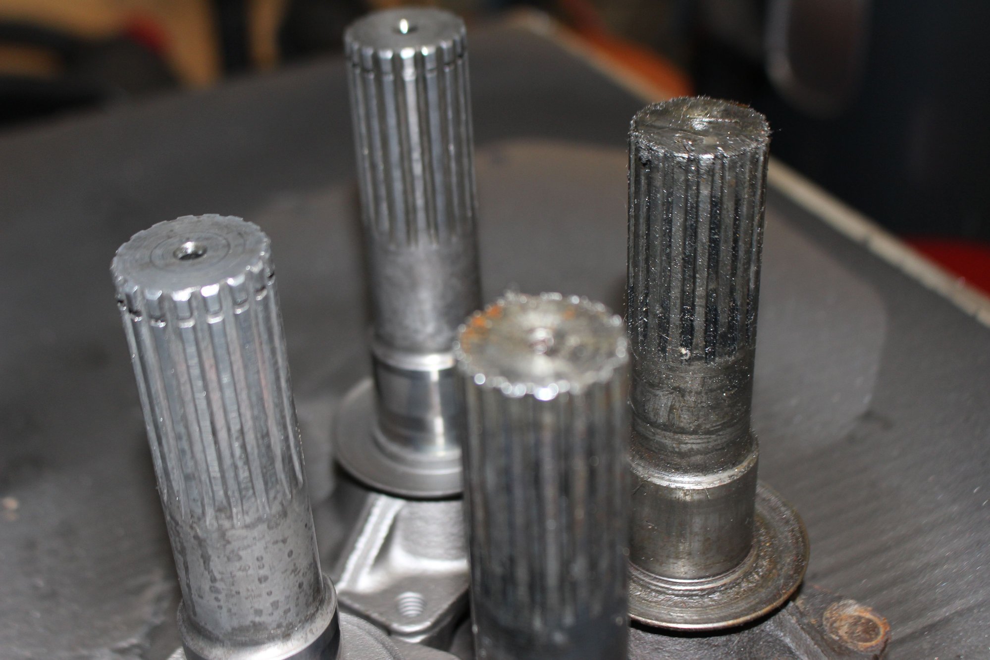

Your axle stubs (yokes) appear to be worn flat.
At least your c-clips are still there, but I see no chamfer on the edge.
The two on the right in the pic below are that way, and they even wore down past the c-clip groove.
My two on the left only have minor wear, even after 90k miles. They measure almost as new, and have a wide 45 degree chamfer at the edge of the splines.
The like new measurement from top of c-clip groove to end of axle stub, is .185-.190"
The quality of the heat treating got worse as the years went by. Mine are 71 axles. The bad ones on the right are late 70's.

The pictures tell a story.
The diff has been apart before. The axles are shot, but axle endplay comes from more than one area in the diff.
The gears look like 1973- 355's. It appears the RG bolts are not from 1979 as well.
The diff is nothing beyond a stock level build at best not what I would use but it may be ok.
Cracks can form at any opening typically. Some are hidden under the RG at times.
There is no apparent damage from locking up in reverse. If the pinion rotates without issue, your problem looks to be elsewhere. Whether to use the diff in that condition is up to you. Replacing the axles is straight forward, what you get will make a difference- but just changing out the axles will most likely not bring them where they should be. I just fit rebuilt axles today. I should not have to refit parts I bought but these were not ready to use. There are several options for axles today, depending on the usage, some are good and some are not.

I was fairly sure that the diff had been apart before due to the amount of sealant that was used to seal the cover on, I’ve had this vehicle for the best part of twenty years and never done anything with the rear end except fitting new wheel bearings, some bushes, shocks and over time the two calipers, so that probably tells you more about my style of driving, not a drag car, think I’ve only ever done two burnouts (showing off), but do give it the beans when driving. The gearing has always been something I was not happy with in that I really don’t need first gear and it runs out of steam at the top end around 100+MPH, so years ago I sourced a set of gears that should give me better top end and cruising than the current set up but I haven’t checked the ratio yet. Bear in mind that over here gas is more than double what you pay over there, hence wanting better cruising speeds.
The side yolks have no chamfer on them and I did put a dial gauge on to see what the side movement was and got .080” on the passenger side and .095” on the drivers side.
I will check out the links you have given me and see what to do from there, obviously side yolks are required but who or where to get them from is going to be the next question as second hand spares over here are also very few.
