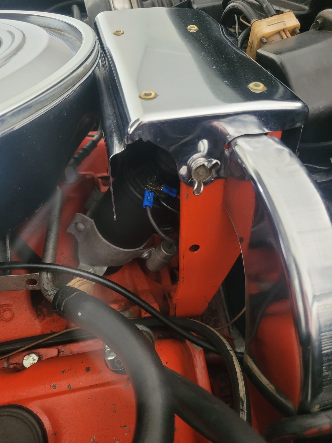

Here is a pic. It does not really show much. The two wires that have blue collars were on a terminal that looks like the other one in the picture. The wires were bare for a few inches, so I cut them off and put new ends on them.
I will try the things suggested above. Thank you.
You haven't taken the shielding off and the distributor cap ?
One of the wires is obviously the radio suppression capacitor.
I did have the shielding off, but I have not taken the cap off. I will do that the next time I get to the car (it is in storage nearby). Which wire would be the radio suppression capacitor? The second black one?
Do you see the cylindrical object screwed onto the coil clamp, that's the capacitor.
