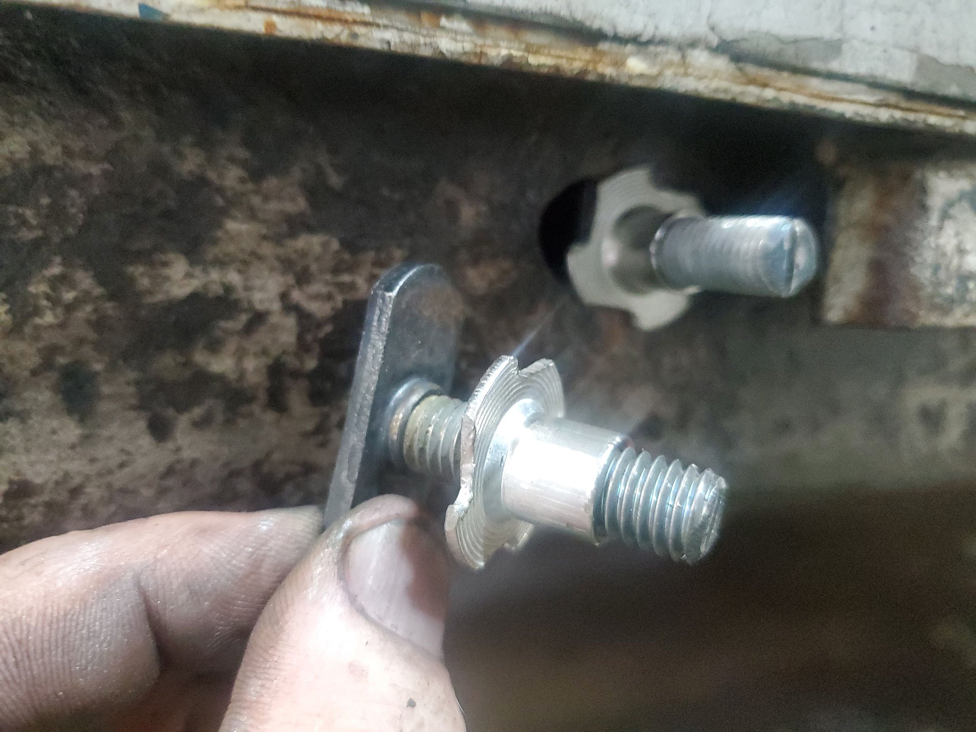

Default Tee Nuts for frame mounting bolts
Just installed a pair of Hookers on my '69. I used Tee Nuts (stainless) to hold the frame mounting bolts in place while getting the pipes in place. The Tee nuts had prongs that I cut off, but I think you can also get them without the prongs. To hold the bolt from turning, I cut a slot in the end of the bolt for a screwdriver. The rubber donut still slid on the bolt with just a little extra effort. Tee nut size is 3/8-16 x 7/16.
Side pipe frame bolts and tee nuts.
Just brilliant!
