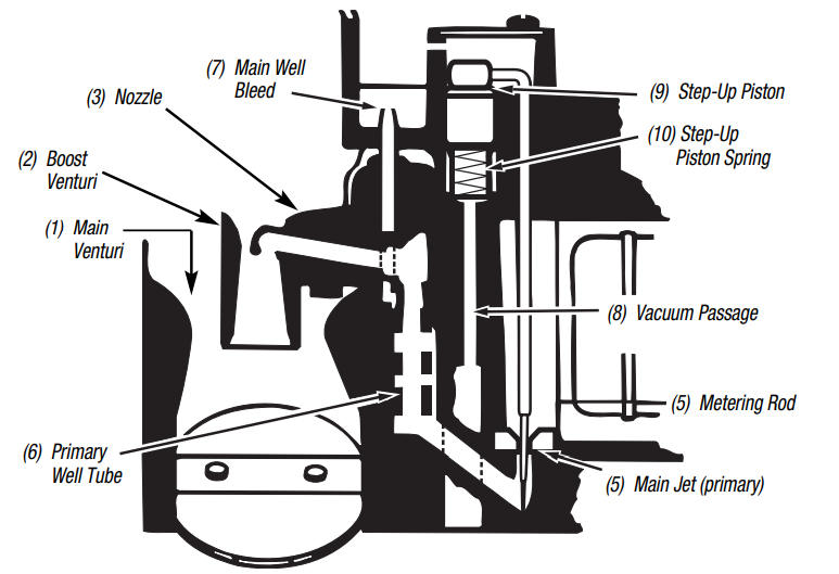

You should buy a mity vac pump and test your vacuum can.
It is critical for decent performance.
13.5" vac at idle is not too big for an AVS, but it is close.
They do have transition slots on the primary side, but not on the secondary side.
#7 is the primary transition slots, which completely over power the idle mixture screws once the throttle is open enough.
There
There are no transition slots on the secondaries on an AVS, and no way to adjust idle air, or secondary throttle opening.
Because of the lack of a secondary throttle blade adjustment screw on an AVS, it is going to be very sensitive to the primary throttle blade angle.
It seems you have a broken vacuum can. Without the extra advance from that, you are forced to open up the idle screw too far, opening the throttle blades more, and into the transition slots.
Fix the vacuum can and then you can lower the idle screw back down. covering up a lot of the transition slot, and your mixture screws will work again.
To idle mixture screws
