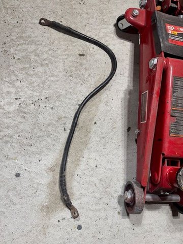

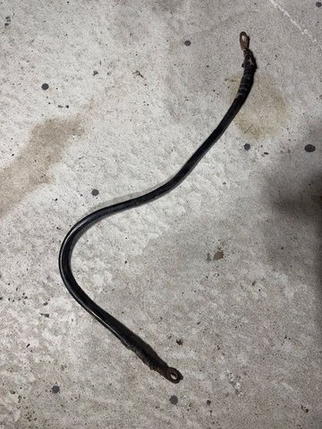

Unknown ground cable.
After lifting and replacing the body on my 1972 LT1, I am left with this extra ground cable that I don't recall where it came from.
Does anyone know where this cable goes?
I am almost ready to start the engine.
After this detail is sorted out.

Looks kinda long but is it the one that goes from the pass side engine mount frame extension to the engine block near the nose of the starter? i have a 71 and it has a strap in that location.
Pat
