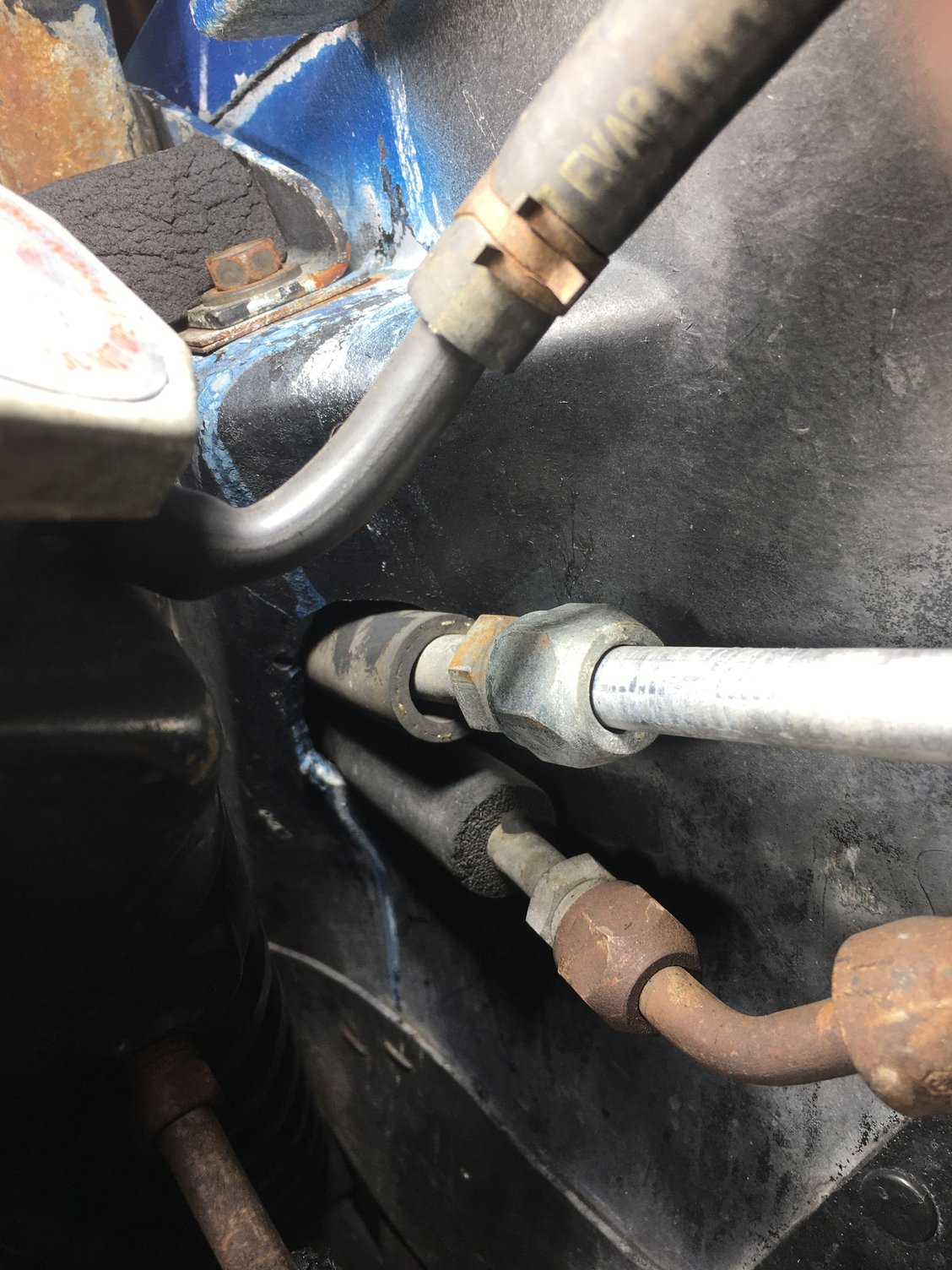

I do have a location where I can add a high pressure fitting like Neal recommended These are the connections to the condenser, in and out are different sizes, and I will try to locate an adapter to match the in line. Larger one on top of picture.

If, when , I tear the system down I'll add a high pressure port. I found this online and believe it will fit the 1/2 inch OD aluminum tubing
