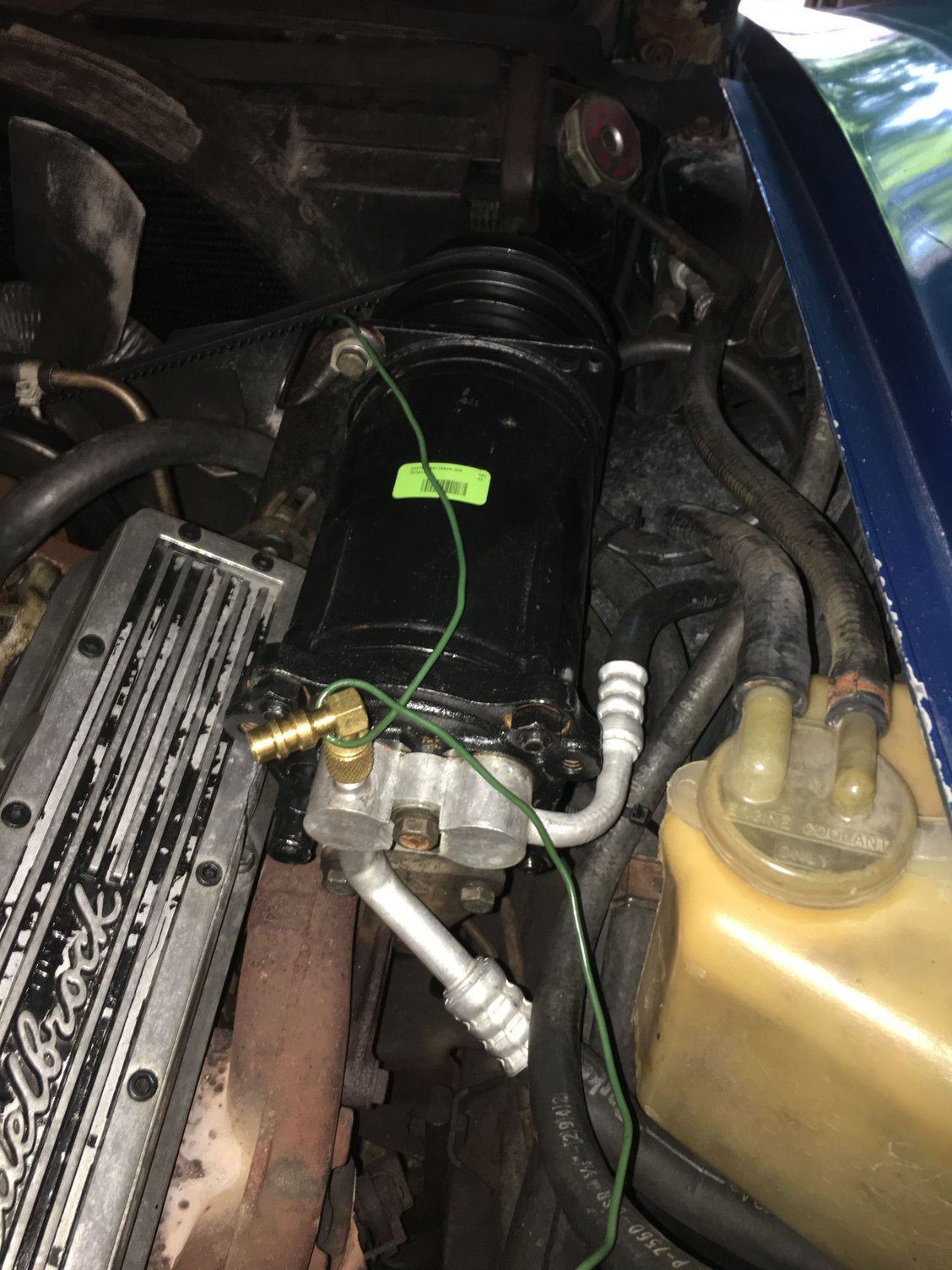

I tried to spin the compressor by hand today and can't budge it. Engine off clutch disengaged.
Clutch gap varies from roughly 15 to 25 thousandths. plates aren't parallel to each other.

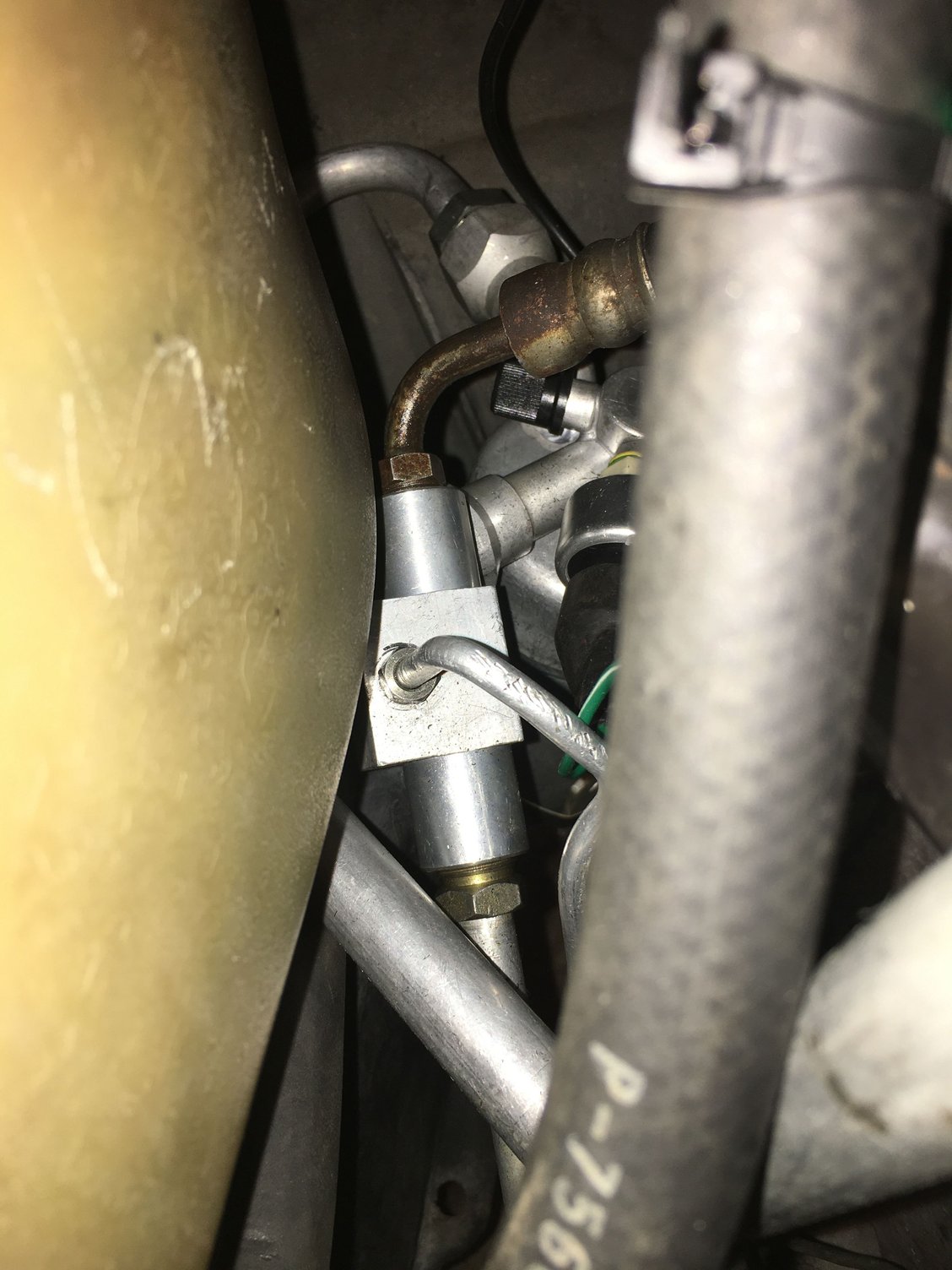

The Old Air VIR eliminator kit , cycling clutch, connects directly to both sides of the evaporator. Very hard to get in, but you can't screw it up.
The oil drain line connects to the new high side aluminum block. but it is a blind hole. basically just capped.

Thanks for the pictures,
The compressor should spin over by hand, the fact that you can not spin it by hand could be an issue
The clutch air gap measurements are good so next check the voltage at the compressor and make sure your getting the correct voltage.

If you can't turn it by hand you have issue's internal inside the Compressor

seems if off , clutch has a gap.. and does not spin.. probably not a good sign for compressor.

There is a nut on the end of the compressor shaft (hidden inside the clutch) that is used to retain the clutch once the gap is set, can you put a small ratchet and socket on it and get an idea of how much torque it takes to rotate it, be carful not to put excessive force and break/strip the nut or crank (the nut is torqued to 15 lb ft). The clutch is an interference fit to the crank snout so to much force to rotate the compressor can close the gap on the clutch. There are special tools required for proper servicing of the compressor and can usually be rented at the local parts house.
There should have been some paperwork with the compressor outlining how much oil was in the compressor and instructions on correct installation. The A6 has an oil sump and will hole around 6oz in the sump with the remaining oil in the condenser, lines, evaporator, accumulator/dryer, if you didn't clear all the components of the system and installed the compressor full of oil above the sump lvl amount you may have excess oil in the system. Excess oil will not prevent the compressor from turning by hand but could cause damage over time if left that way. On compressors that come with oil in them it is critical to spin them by hand, in shipping they can be inverted and left laying with the sump up allowing the oil to get into areas not intended for oil. When mounted the oil will drain to the sump and turning it by hand will facilitate allowing the oil to drain into the sump, these compressors will not pump liquid without damage over time depending how much liquid there is.
