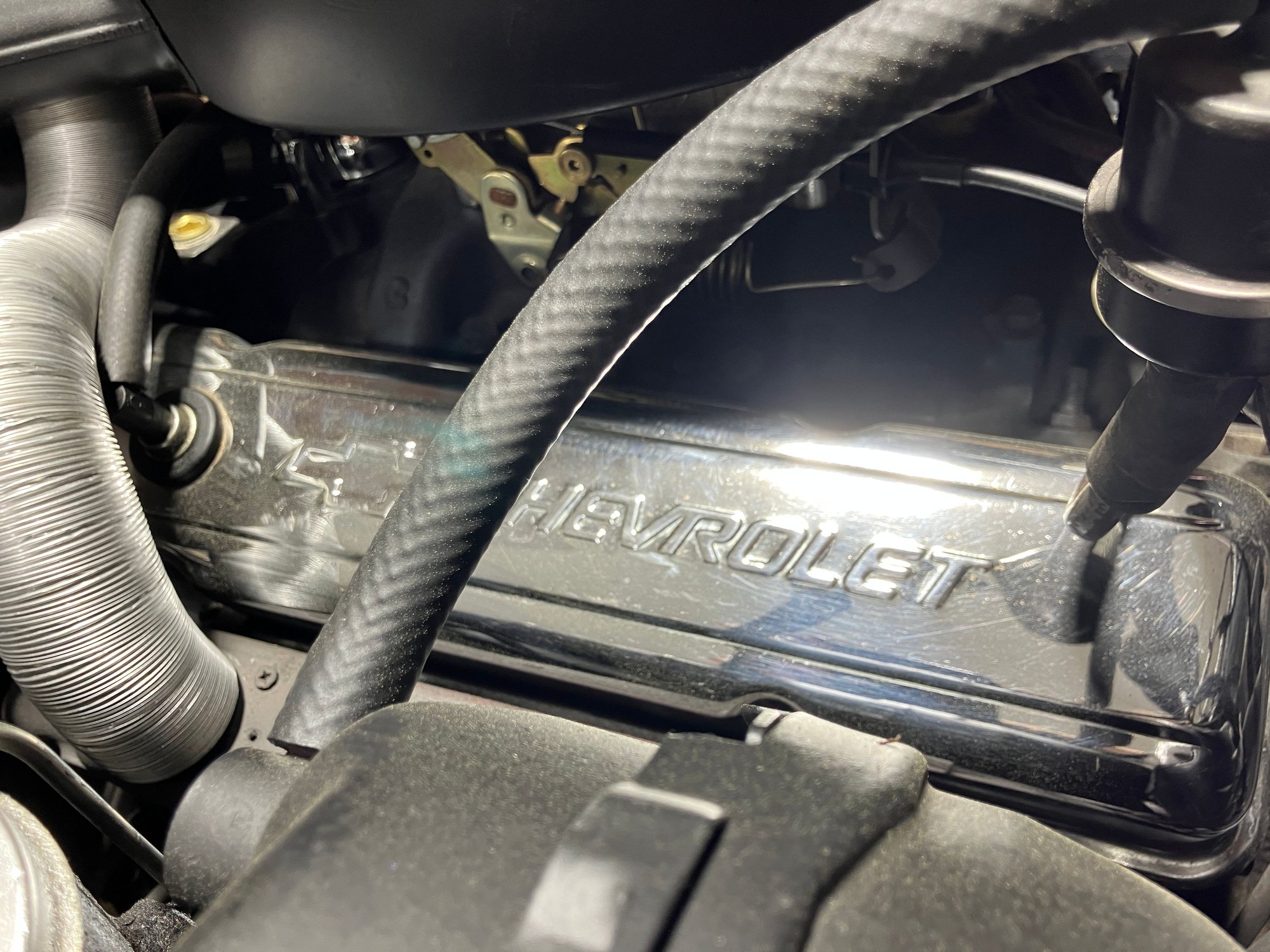

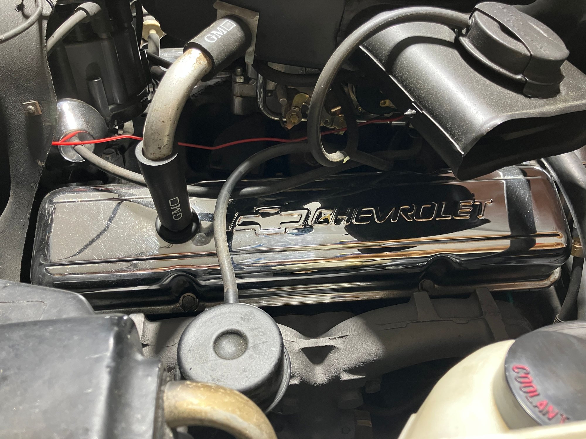

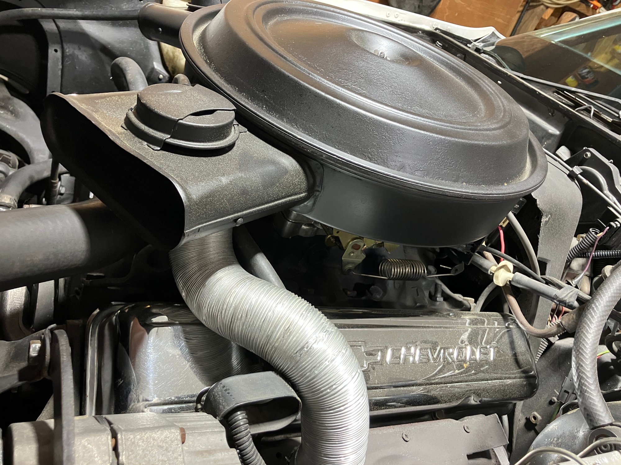

Went to do an oil change, noticed that I’ve got no hole to put oil in. Think I can fill it down the dip stick or one of the other hosed lines going into the valve covers, or do I just suck it up and spend money on new valve covers? Gotta swap the gasket anyways since it leaks as the idiot who put it on didn’t torque it or use spacers on all of the bolts, only some of them. I guess I could pull them off too but that seems excessive every time I want to change the oil lol. It’s a 1978, L48 if it matters…

I see two oil fill ports. Take your pick.
Pull that crap out of one of the valve covers and insert a funnel.

Just pull stright up on that hose in the right hand valve cover and insert funnel.

Alright i considered that but figured better safe than sorry lol. Thanks guys.

Just don't pour it in too fast. The drain holes at either end of the heads aren't all that big. If your valve seals are in good shape, it's no big deal. If they are worn, you might get some oil smoke at start up after an oil fill.

Also if the hole you use is baffled you may have a issue if you pour the oil too fast so as said above pour slow.
