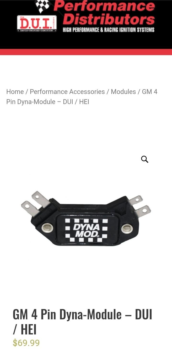

As mentioned above. The quality of aftermarket replacement modules is highly questionable.
This is the ONLY aftermarket module I would consider. As I'm not fond of walking.
And I can't help but notice it's NOT 18 dollars.

I just bought one ignition module. I didn't go with the 18$. I bought one for 59$ and it come with the silicone gel. Still no spark. I have 12.46 v at the distributer. I put the volt/amp meter at Ohms to verify the coil and it come back at 0 or infinity
