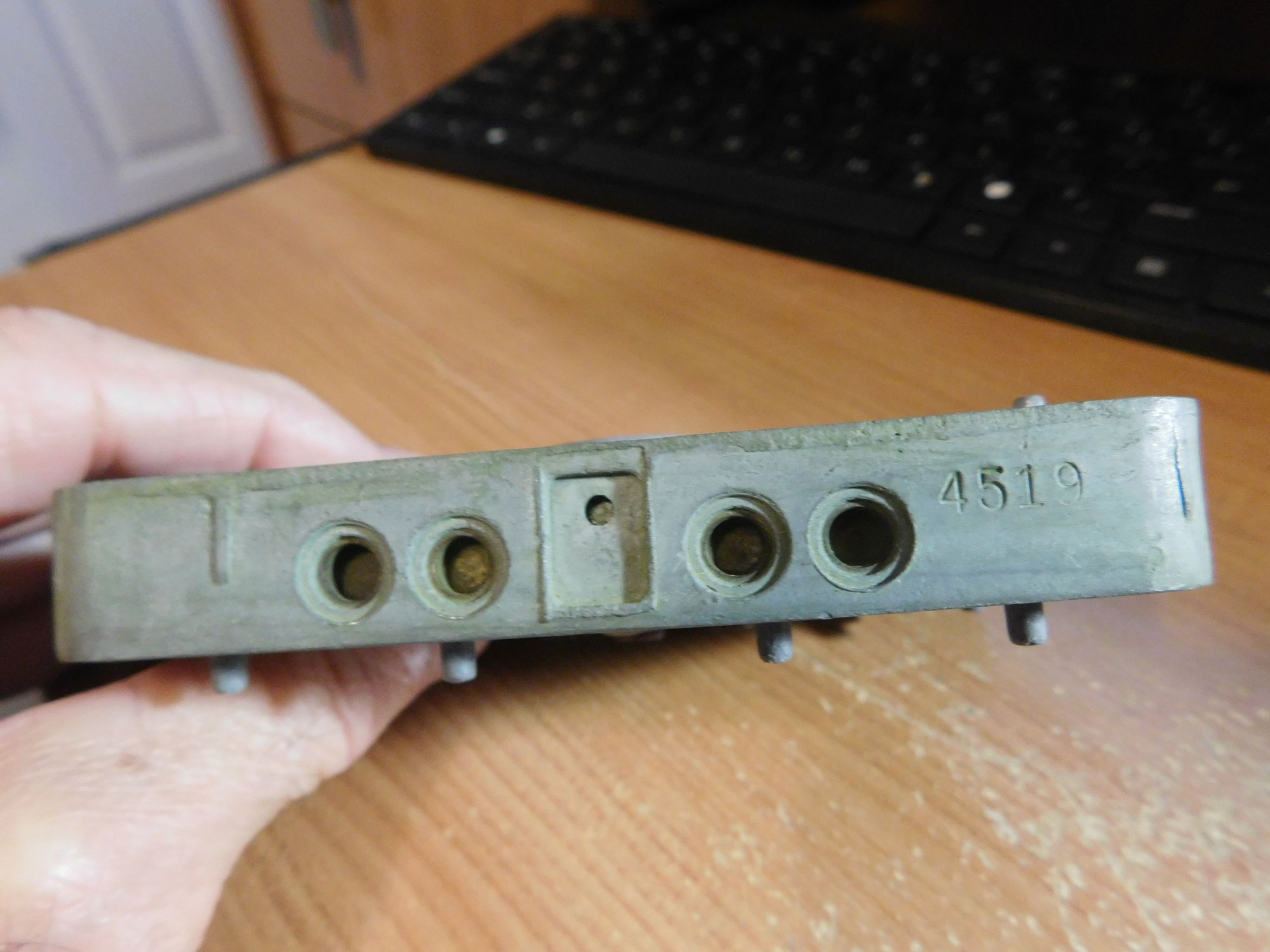

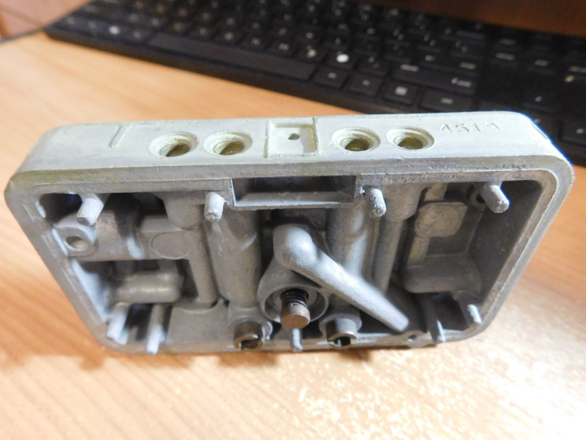

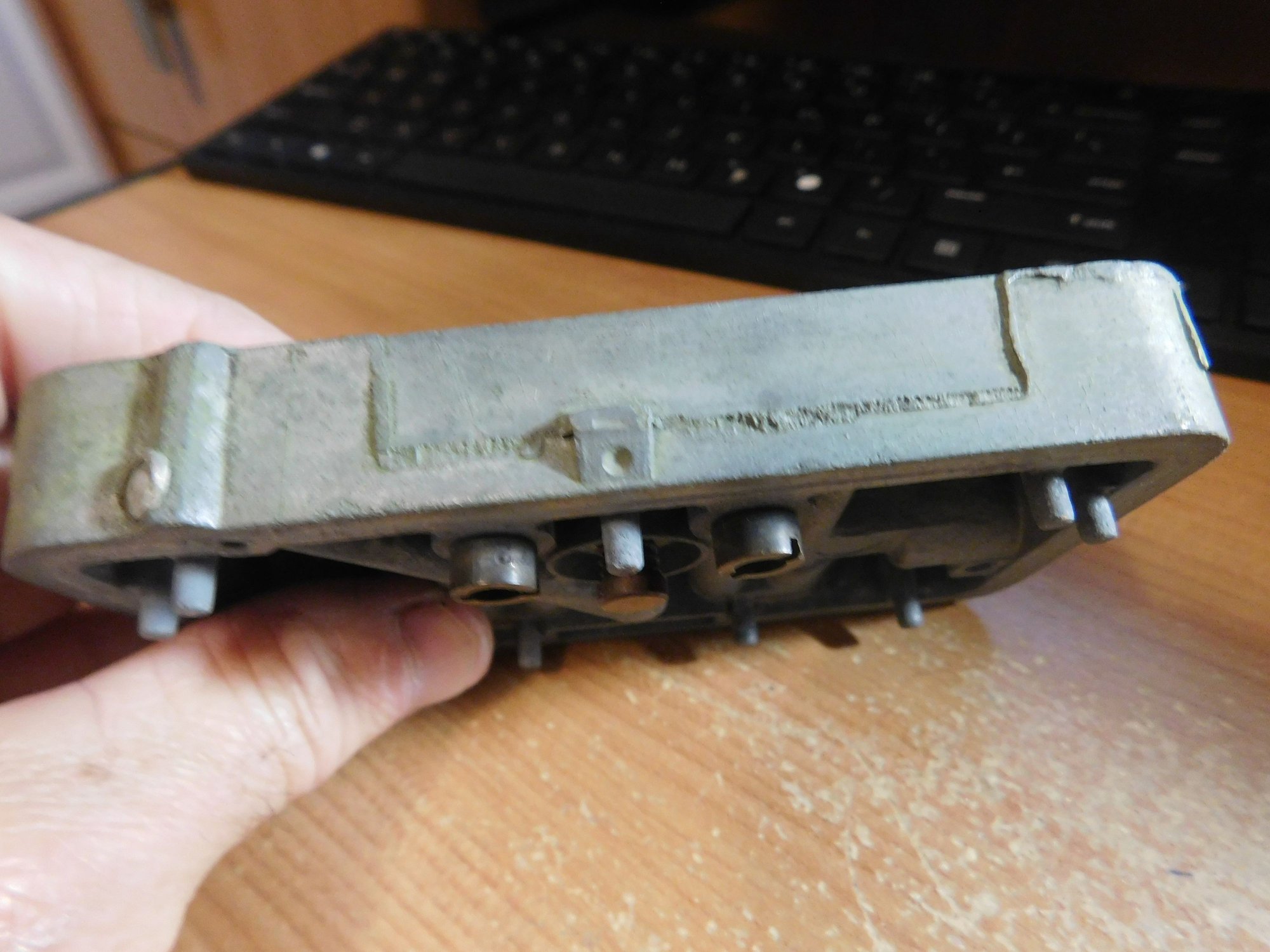

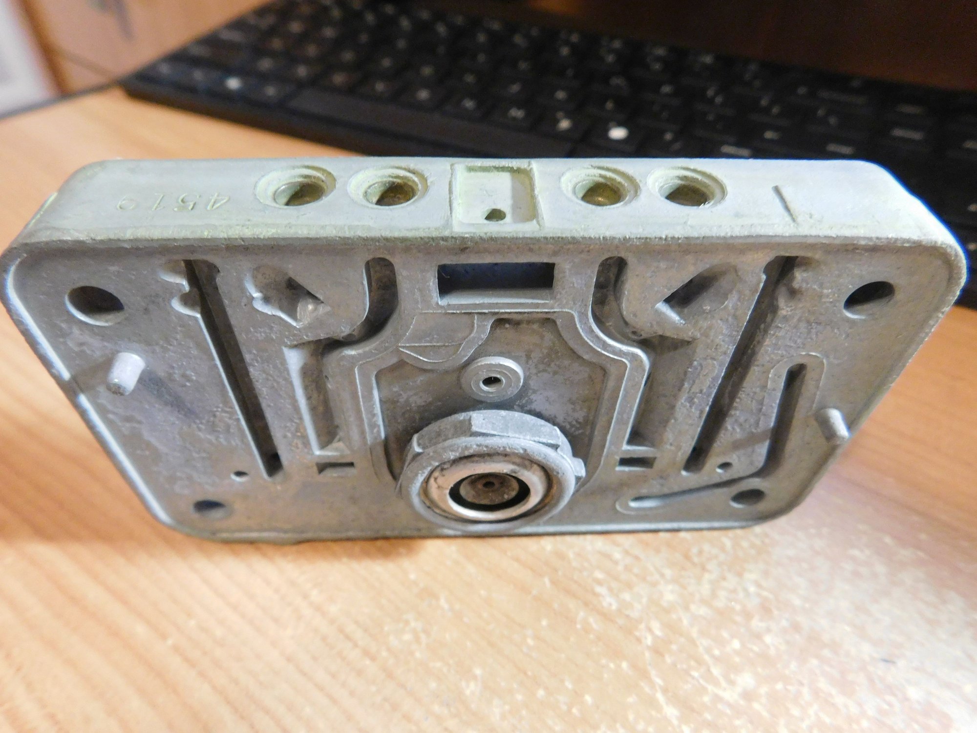

Default 4519
PM or text 9084182684 if interested at 55. shipped. Lenny
