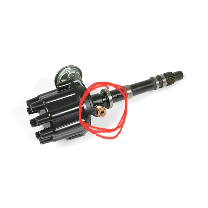

On the distributor on the shaft right under the cap might go straight on the threaded connecter or the connecter might have a right angle adapter on it,

If you mean this hole in the picture, I searched for it but did not find it. My distributor does not have it.
Is there another way or place to connect the cable?

The distributor in the picture is mechanical. Post a photo of yours, and some will determine if yours is an electrical distributor with wires, not a screw on terminal..

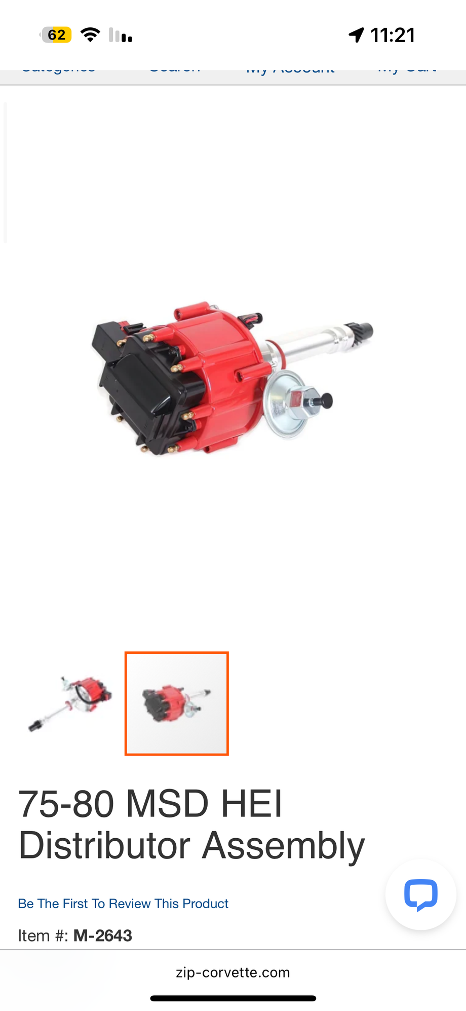

I don't have a picture of it now, but it's similar to this one. My Corvette model is 1973, but this type in the picture says 75-80. In this case, what does it mean? Has it been changed? And how do I connect the cable?

It looks like they removed the old "points" distributor with the mechanical tach plug in provisions and replaced it with an electric "HEI' distributor... you'll have to convert your tach over to an electrical tach and plug it in to the distributor you now have in place.
