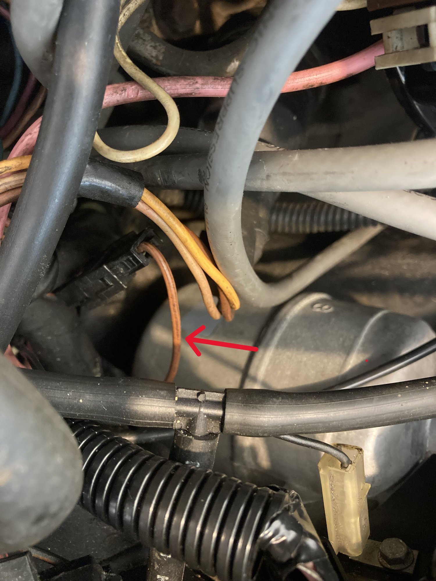

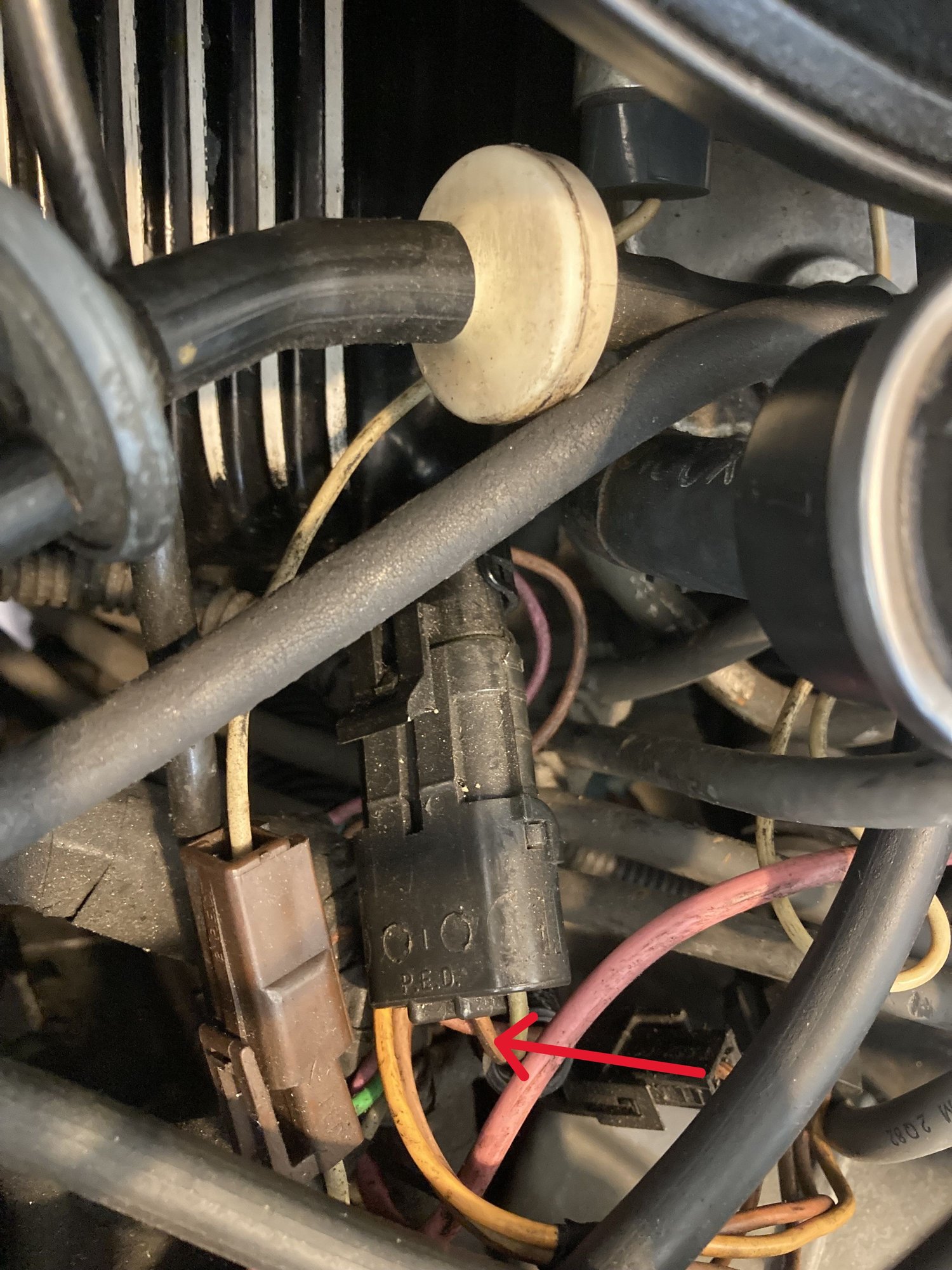

It's a single wire weather pack connector near the distributor with a brown wire.

I have 2 different brown wires.

It's the one in the first picture and it's connected. You'll need the FSM for this one.
