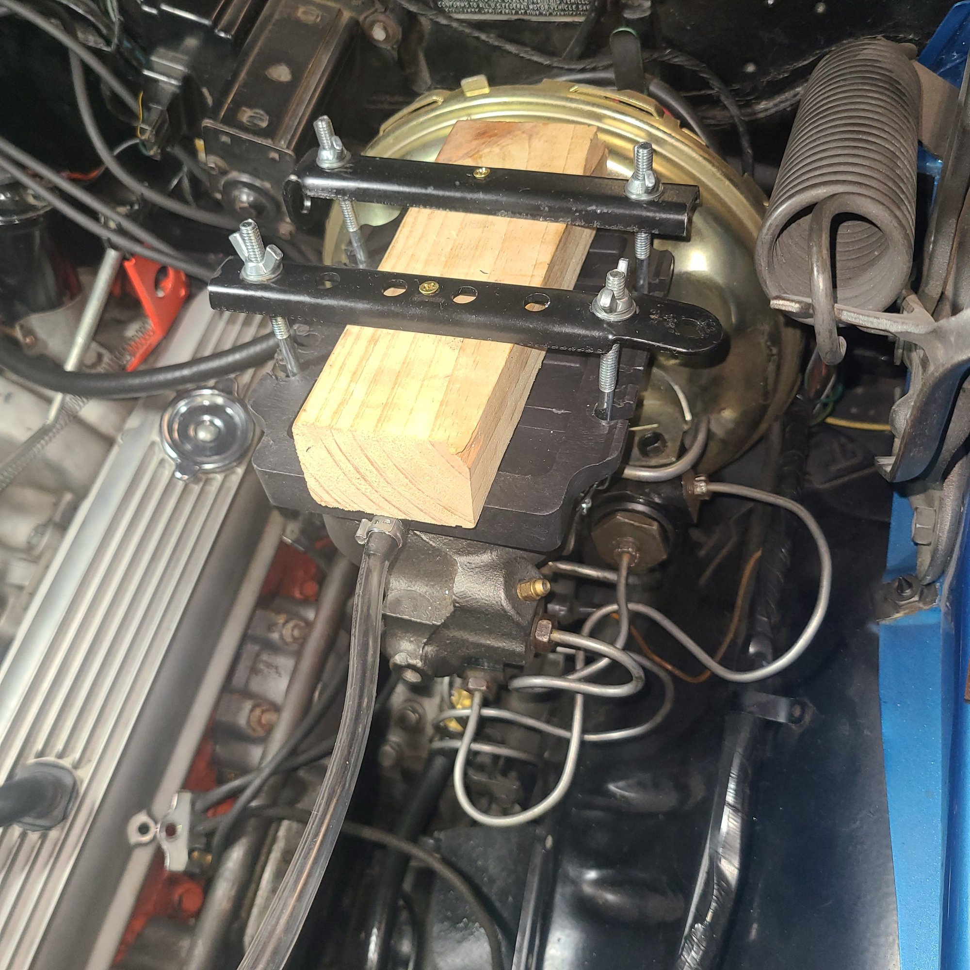

I like the Motive pressure bleeder used dry. I did need to modify the clamp setup as others have already pointed out. My solution was a bit different.
Added a block of wood and 2 pieces of scrap steel.  Chains work much better now.
