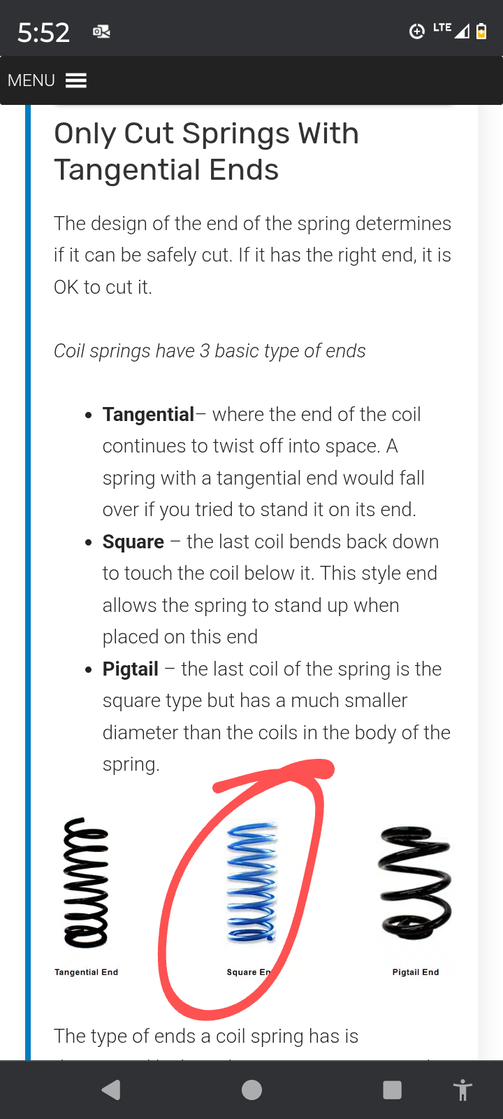

Originally Posted by 79C3Vette
So when you say cut a 1/2" off, the coil is standing upright and you measure from the floor to the top of the coil and wherever 1/2" lower lands on the coil, cut it there?
here you go...

So according to Detroit springs I can't cut my spring coil anyways being that it's a square and coil. Or do people cut them anyways but obviously not the square end?

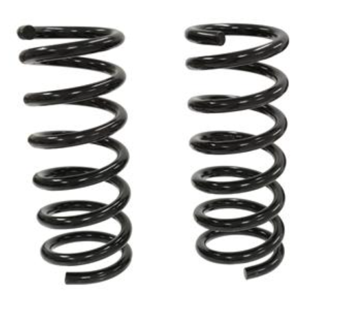

Which manufacturer is that?
Corvette Coils normally have open ends on both ends, well at least 1/2 open.
Definately not squared off ends with the last coil touching.
Plus those look like a dual rate coil.
Typical C3 replacement 460# Moog Springs

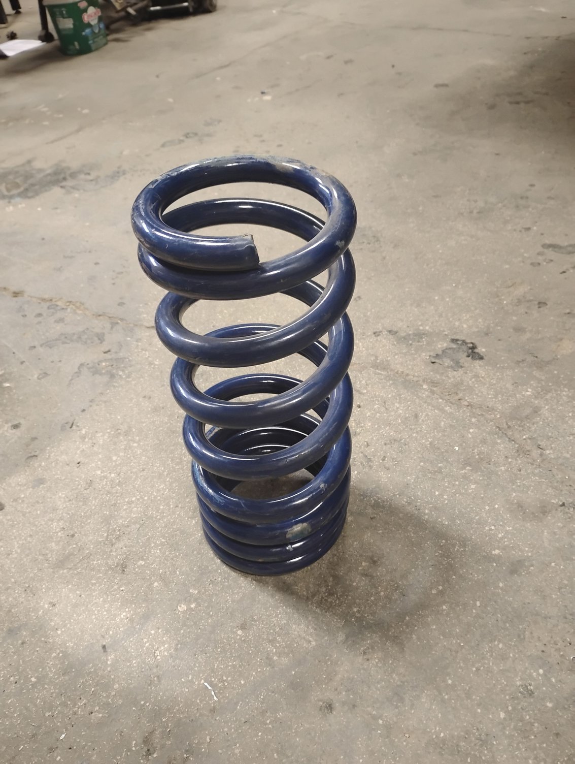

My original springs look like that. And these are dual rate springs from Ridetech. 2" lowering springs. But as I originally said, most threads I've read say guys are only getting 1" out of them. Plus, I've reduced the weight a lot in the front end. Which is why my post is about cutting them.

Those Ridetech springs have a huge dual rate. Comfortable vs very stiff. 480/700.
They need to ride normally in the 480 section and hit the 700 section in ~1" of bump.
I would think cutting these would mess that up.
The top 3 coils are designed to all bottom out at the same time, increasing the rate.
First thing I would do is contact Ridetech and find out the design load that gives the correct 10.0" ride height.
800# 900# 1000# etc.
Then compare that to my spreadsheet.
FYI C3 springs are 10.0" long when compressed, with normal loads, and at normal ride height.
There are dozens of different weights for stock C3s, so there are dozens of different springs, to give the same ride height/bumper heigh/D height..
This one spring can not possibly work well for all of them.
Your car is now on the lighter end of that spectrum, like a 68-70.
IMHO Once you try them on, if you need to cut, I would cut the wider spaced coils, in the bottom of the pic above.
So yeah they can still be cut. And the ride height will drop as planned. But whether you still have a 480 spring rate at ride height is anyone's guess. It may be that, or 700+.

Or should I return them and cut my original springs? Cutting them will make them stiffer and with the KYP shocks it's already very stiff. All my body weight on any corner, bounce, virtually zero movement.
I torn on using or returning.

All good. I contacted Ridetech and I can cut their springs if needed. They said to cut the loosely wrap end. So, I'll put them in as they are and go from there.
