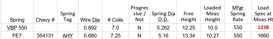

Now we are getting somewhere.
Your Vette has the optional FE7 / gymkhana springs.
They are very much like the F41 or VBP springs.
All 550# rate. But yours have a higher load to hold up a heavier car.
You have options.
And yes you can cut any of them.
At least with these two they are a linear rate and you know what you are gonna get.
I am not fond of dual rate springs like the Ridetechs, on a race car. They change rate and alter the handling by stiffening the front and adding understeer. Not my first choice. OK for a street car I guess. I see no need for 700# rate springs on a street car. There are better ways to adjust the handling.

If you want to drop the fender height 2.0", then cut the coil 1.0" shorter.

Pending a refresh this winter, I still have an uncut set of 550 coils in the front along with the stock (for 1980) 1 1/8" swaybar. They do lower the car a fair amount without cutting.. If you cut any coils, you will effectively increase the spring rate. So if you have 8 turns now, and cut one full coil, you will have a pair of 630 lb springs. That's a lot, and likely beyond the capability of any non-adjustable shocks to dampen the spring (the Bilsteins are marginal as it is).
I would 100% suggest just going to semi coil-overs, as @gkull once convinced me to do, if you intend to drive and tweak your car. You can buy nice ones with double-adjustable shocks, and they cost less than solving a problem twice.
