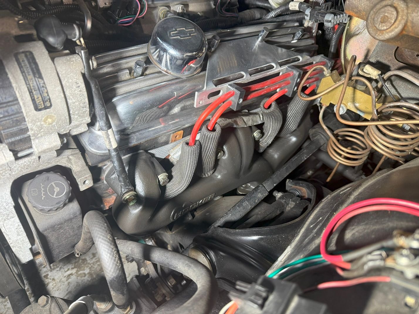

These manifolds turned out just fine as did the shop. Honestly, I thought what I had was better than is actually is plus I was more concerned about the O2 sensor, H pipe and leaks and all that has been fixed. I have less than 50 miles on the thing as I just picked it up but right away I could tell it was much better. No more chronic fuel smell and the thing seems much smoother and more responsive. Still sounds nice. I believe I was right in that the O2 sensor was way too far back at the wrong angle. Now it's much closer to the manifold on the first horizontal section and at a more useful angle per the GMP install guide.
Imagine that - follow the instructions and it works as it should. Who would've ever seen THAT coming ?
So, no more rusty nasty leaky OEM logs with only a 2" outlet, now it's 2.5" all the way through. It needs more miles to really determine this but I cautiously hope there is no need to go Terminator X. Save that for a time when I have other silly ideas, like a new cam. This means I was correct about what the car needed but not how to do it. I got to know the shop and owner a bit better now and although it means spending $$$ to rip out what he just repaired in a couple weeks I'll take it back and have him eliminate all the catalog junk under there and install a nice custom set of pipes with MagnaFlows. Should've done that in the first place but hindsight's always clear.
