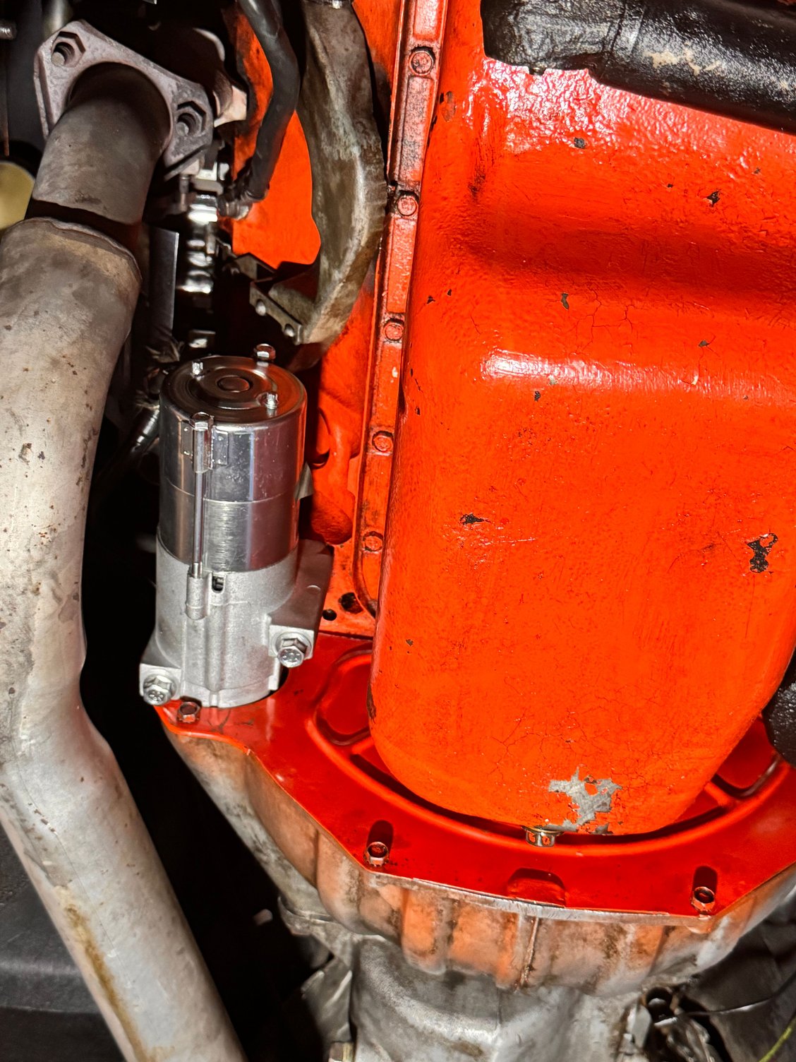

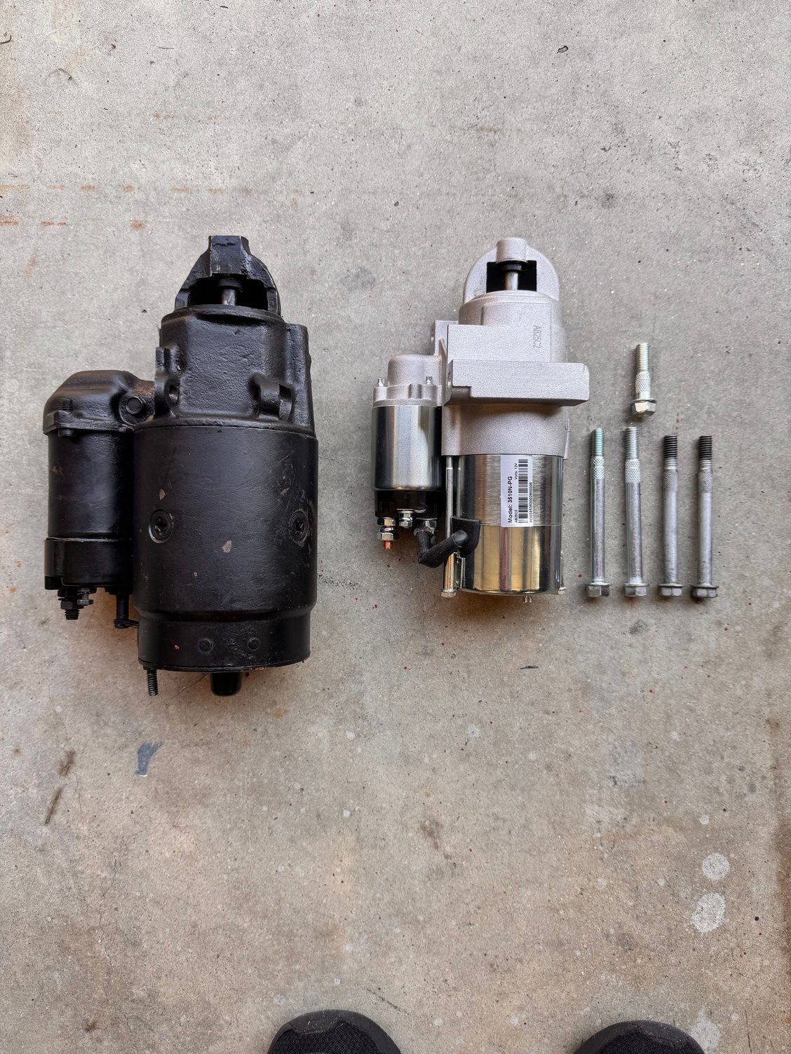

Just to close the loop on this, I did receive and install the Rock Auto WAI Global 3510 NPG starter. I was encouraged it came with a detailed dyno sheet. While it also came with two starter mount bolts, one was WAY too short. What I needed was another 4 5/16 bolt, available at NAPA as Part # NOE89925001 or Dorman 678-107 at O'Reily's. 5 bucks, not a heavy lift. One installation tip is to loosed your flywheel cover to move it around while seating the starter, that way you may not need to grind the cover for clearance.
Overall, much smaller footprint. It does sound different since it is a gear reduction unit but mounted right up with no shims (like the original) and engaged smoothly with no odd sounds. Spun the engine much faster with less amperage draw. Win/win on my end. Original starter and rear support bracket, heat shield and wire support bracket boxed up and saved.

a bolt-pair consisting of a long and a short is correct for the (other) PMGR PG260 (w/ straight-across aka inline mounting bolt pattern): seems they boxed the wrong pair.
As I expected, new starter appears to meet, if not exceed, your requirements. New starter's considerably smaller mass (and length) trumps any need for a support bracket. A phone call might net another bolt or two.

In reading this thread I also went with the WAI 3510 NPG starter. Like mentioned, mine was missing a bolt too. Used the stated part number to source from O’Reillys but mine also came with a gasket. Looks like it is made to go between the block and starter. Did you use that?

Interesting on the gasket perhaps being intended for marine purposes. Tjmaniez, to answer your question, yes my starter did come with a gasket but no, I didn't use it. I felt it bolted up easier without it.

So I sourced the two bolts, each the same size. When I went to snug the inside one down it became clear the bolt was too long. I had to put a spacer in which seems odd given what others have said. Anyone else run into this? The bolts are the 4-5/16 inch length. I put some decent pressure on it but it seemed to be at the end of the thread and didn’t want to break it off.

pics are helpful here.
perhaps you sourced Wrong bolt
which Brand and Part Number is the bolt you sourced. ?
pic of Both bolts side by side ?
Your pic of YOUR new starter that you have (not a pic from an ad) ?
? That 4-5/16" length --- is that measured Under Head OR Overall ?

it is the Dorman 678-002 bolt that others have noted they used. The starter, the bolts, etc are exactly what JLMICCA showed in his pictures. That is why it is confusing.

Just because someone or several used that Dorman 678-002 starter bolt, doesn't necessarily mean it's the right bolt for your starter. I suspect that bolt is too long and ain't right for a PG260-type starter. To help alleviate further doubt, suggest buy a pair a GM starter bolts from local GM dealership parts dept.
To tjmaiez:
NO
seems JLMICCA used Dorman P/N 678-107.
while, seems You tjmaiez, used Dorman P/N 678-102 P/N 678-002.
*two different bolts ! apples and oranges.
again, when all else fails, go get some correct bolts from local GM parts dept

Originally Posted by Rebelyell
To tjmaiez:
NO
while, seems You tjmaiez, used Dorman P/N 678-102.
Did you mean 002? I can't find a Dorman 678-102.
Dorman 678-107: Starter Bolt, Type 2 Long, 3/8-16 x 4-5/16", GM 4.4L, 5.0L, 5.7L.
Dorman 678-002: Starter Bolt, Type 1 Long, 3/8-16 x 4-5/8", GM 5.0L, 5.7L.
Edit: My Googlefu has failed me, if you search for "Dorman 678-102" the results are not the same as if you search for "Dorman P/N 678-107"
JT
Yes, I meant 678-002 (versus 678-107).
but yes, Dorman does (or Did) also offer 678-102

The Correct (necessary) Pair of two LONG bolts for diagonal aka staggered pad mount PMGR PG260 starters are (per EACH):
GM P/N 12338064 (supersedes GM P/N 14037732 )
or
Dorman P/N 678-107
or
Pioneer P/N PG-622
or
SKP P/N SK678107
yes, I triple-checked for errors/ typos
