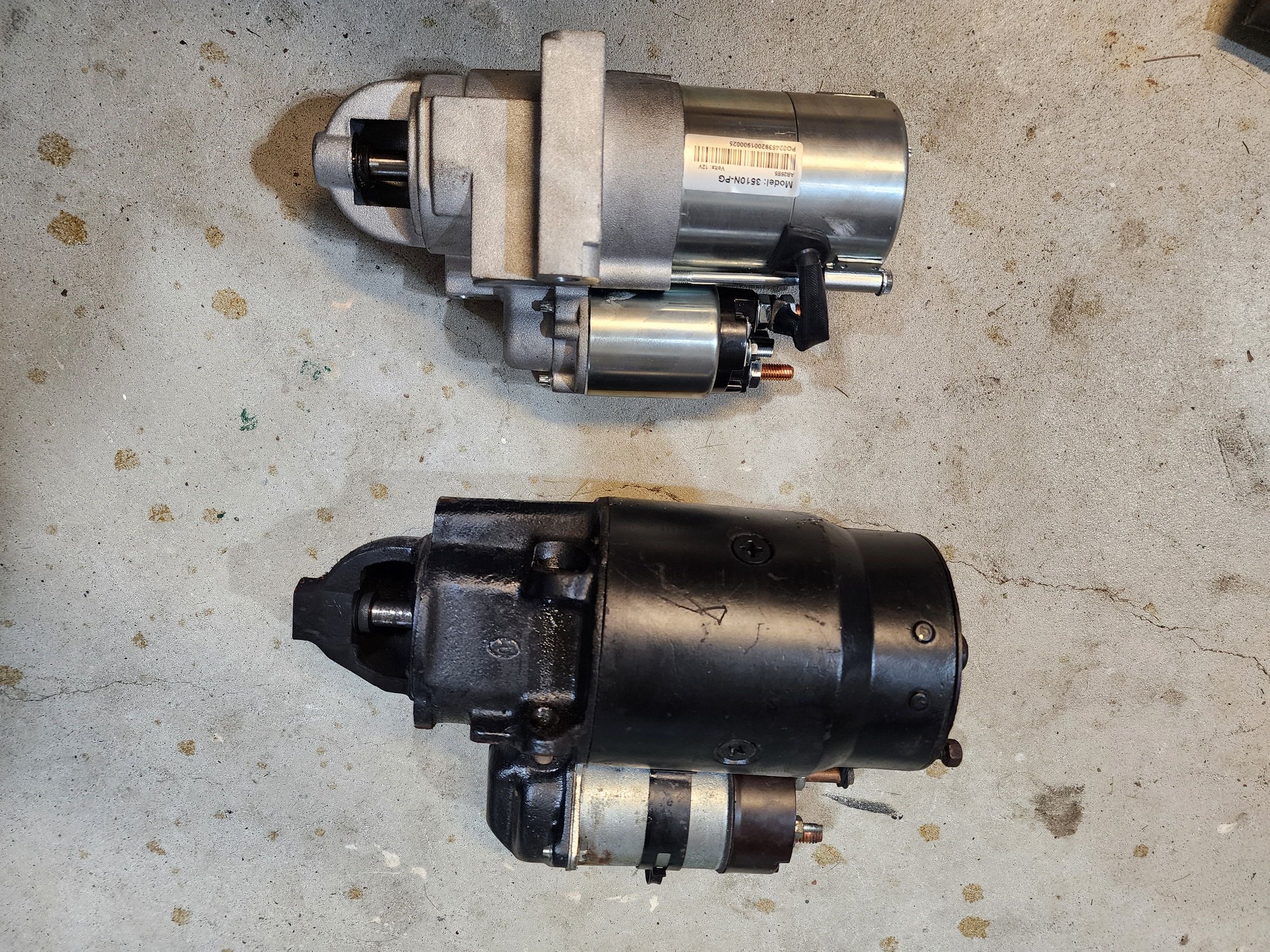

So I bought the starter recommended here from rock auto. Came with the mounting bolts, thought about getting the Remy starter but finding bolts was difficult or expensive so coming with the starter was definitely a good option. Had to remove the exhaust manifold and spark plugs to get pipes out so wrench could reach the start bolt. Installed new start and everything fired up with no issue. Turns on everytime now!

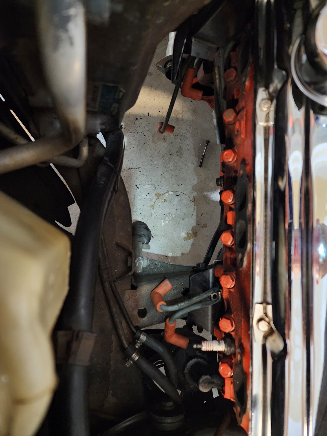

New issue now. When driving clutch engages in driveway to turn car around fine. Pedal seems high when clutch engages butbwas like thst when I bought the car. Started driving down the road and car starts jerking like it's being held back! Pushed in clutch and car coasts smooth, assume clutch isn't fully engaging?
Tried moving adjustment down Z bar towards firewall a little bit but still exhibiting same jerkyness when accelerating but no issies when coasting. Going to try further adjustment of bar but wondering if I'm missing something?
Clutch shot and needs replacement?
spark plug or wire issues issue start install?
Damage from push starting car when starter wasn't working?
Let me know your thoughts.

I'm noting how the old larger 10MT starter seems to have been removed without dropping the header or plugs; BUT installing the new smaller PMGR starter required dropping header and a couple plugs; I didn't expect or understand that quandary. But as expected, seems PMGR is working to your satisfaction.
Clutch WAG(s):
a) One or more plug wires damaged or not secured.
b) Ya know, the OE-type clutch friction disks are "sprung" meaning the center part of its hub (with the splines) is made to slip n slide a little independently of rest of disk, And that motion is dampened by a few coil springs that lay on their sides around the hub. It's possible that something in there broke or became dislodged while either someone had vigorously "popped" the clutch too often OR OR similarly, the disk was shocked too hard or too many times when bump-starting car. I can't KNOW if any of that's what happened here. But if anything in clutch hub is pooched, that'll require a new clutch. If you plan to R&R clutch, also Pre-arrange with local auto machine shop that they can resurface/grind your flywheel if it is found to have bad hot spots, heat cracks and/or gouges. And, if your flywheel's ring gear is badly worn, machine shop can R&R that as well. Do be apprised those flywheels are typically surfaced when new via "Blanchard Grinding" method and Not on a lathe. Resurfacing should also be via Blanchard.
c) clutch is simply shot & gave up the ghost. Again, pay close attention to Flywheel's potential for damage/resurfacing.

Thanks for the wisdom on possible cuases to my issues. Hoping to see how the clutch works today after adjusting it some more last night but will have to wait till the road dry up. Will have to find a good mechanic in the area that works on old cars and can Blanchard the flywheel.
For the starter, the exhaust was blocking one of the bolts, had to remove the headers for both removing the old 10MT starter and installing the new one. Exhaust went back on after I got the new starter hooked up.
